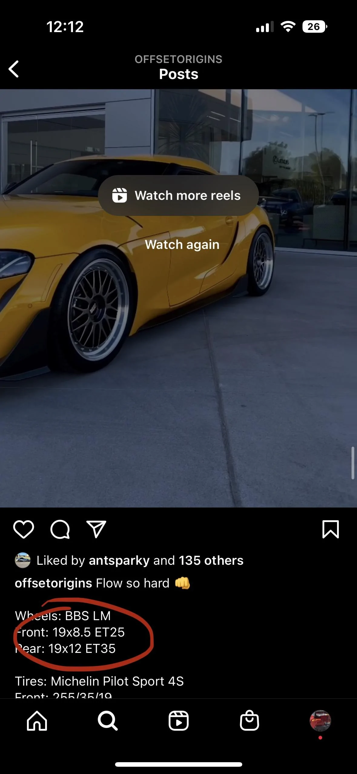

Just stumbled across this on @OffsetOrigins IG of @a90carbo’s beauty
Am I missing something other than needing a little less meat on these tires and dialing in the ride height in the rear

Just because you have seen it done doesn't mean you should. I run 315s on 11" wheels and its a very tight fitment, even with some camber. Don't see how you are going to fit another 1.5".

I'll have some 20x11's on the car for a while and they are on a 295/30. I bet you can do 305, maybe 315, but I would not.
