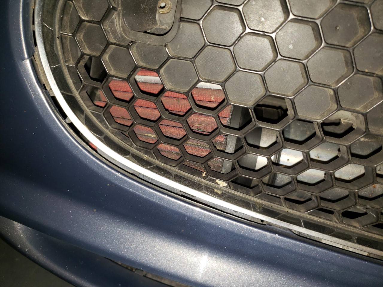

My 2-cents, I had a similar intake on my BMW E36 M3, a Dinan unit, which put the K&N filter essentially in the lower grill area of the bumper. So air would hit the lower radiator and move to the right, into the air filter. Not as direct as the S58 below, but same idea - air intake near a source of fresh cool, air.
However, given the filter was an oiled/gauze unit, it would dirty pretty quick. I used to change mine out every 3-4 months to assure it was as clean as possible because, when these filters get dirty, the performance drop is noticeable. But I also commuted (75 miles a day) in this car so just more "stuff" to deal with on the road than most.
If you go this route, I suggest buying a 2nd set of filters to swap in once the 1st set gets dirty. As cleaning the K&N unit involves a good Simple Green bath, rinse, dry, re-oil, and sit to let the excess oil drain off/dry. It's an easy week long process. And maybe once a year, consider cleaning the MAF sensor as those types of filters coat the sensor in a lot of dust and oil vapor.
