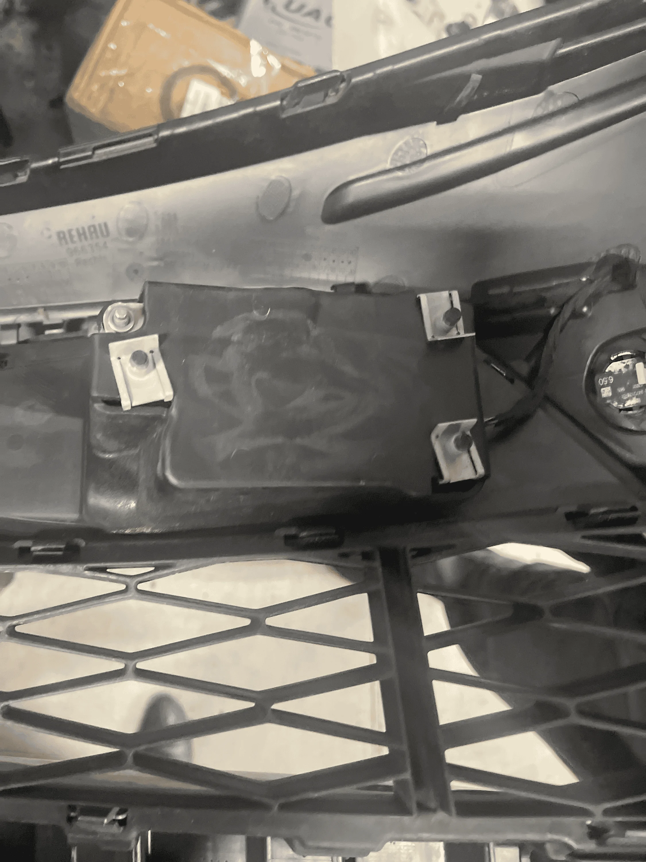

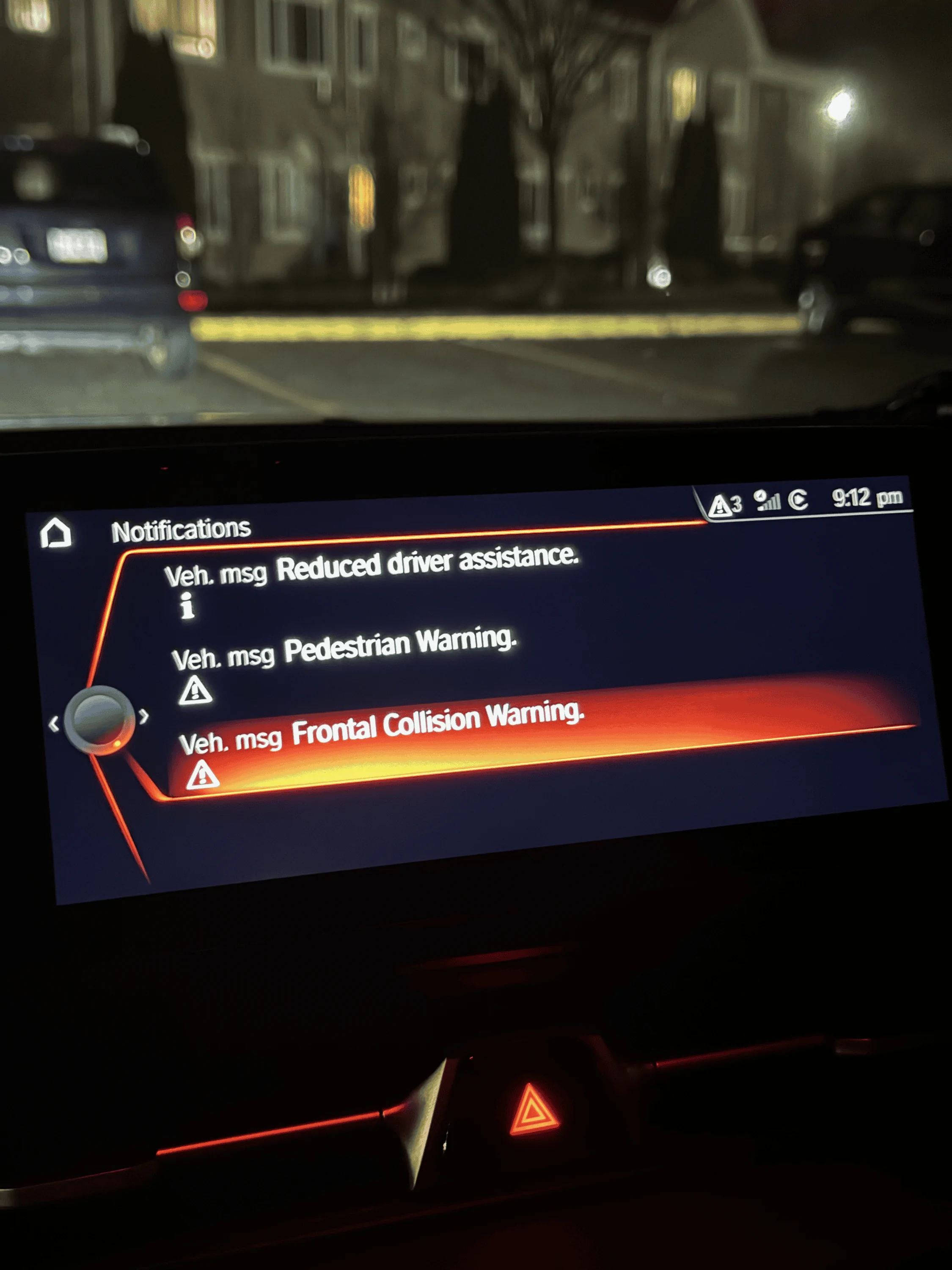

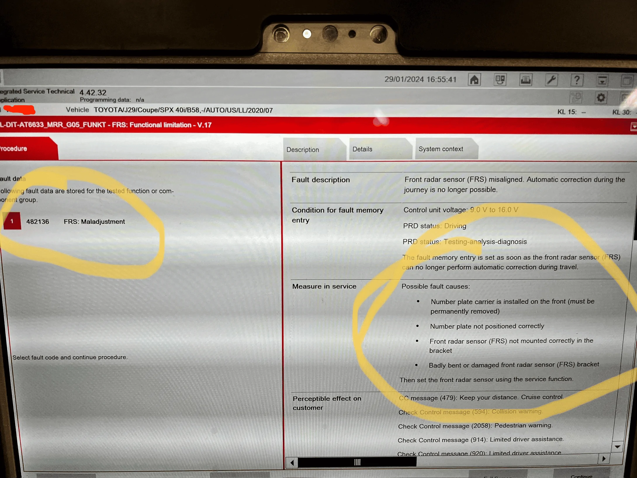

Hey Guys,
Has anyone had this happen? I was stopped at a red light last Friday and got Front Collision, Pedestrian and other warnings. Took it to the dealer next day thinking this is a warranty claim and was informed of this code 482136. They told me I most likely damaged something by some rock, etc. They took the whole front bumper apart and found no damage to the sensor, brackets, or bumper. Yet instead of starting repairs, they are now waiting for the Field Service Technician to come in and look at it to see if this should be covered under warranty. Have any of you experienced anything like this? This seems like horrid Warranty support from Toyota. My Car has been at the dealer 1 week now with me having no idea whether this is a warranty claim or not.

I had this issue, mine turned out to be the MMwave sensor was knocked out of its holding bracket. They put it back where it should be and it worked fine afterwards.

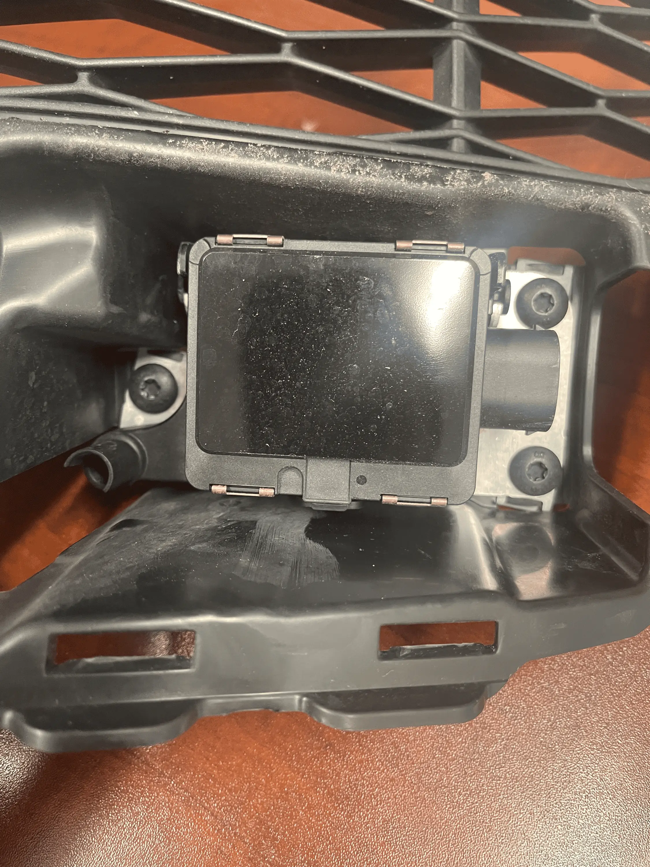

So in your videos was your sensor scratched or anything? And yeah if those brackets are broken or damaged it’s automatically your fault in their eyes. Mine is confirmed to be fine yet I need a field rep to approve the repair

I discovered you can't actually see the sensor using a scope. You can see the adjusting screw but not the actual sensor.
edogjh
Ed
Mar 20, 2023
New York
2021 Supra 3.0 Premium
Yeah, did anybody provide you any pictures like the ones I posted? They show the sensor unit and the sensor inside itself. If all you see is a damaged frame that should be thousands cheaper for you
