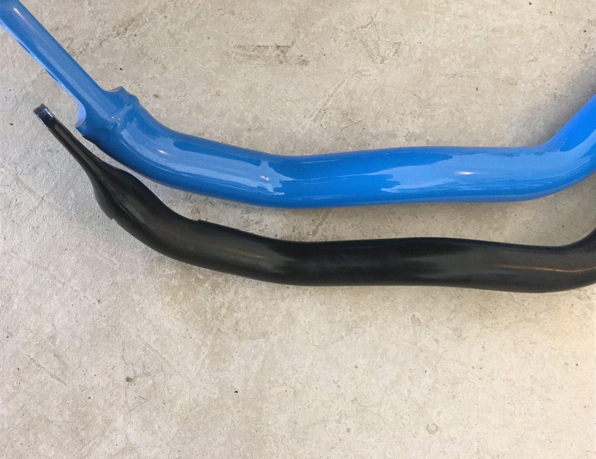

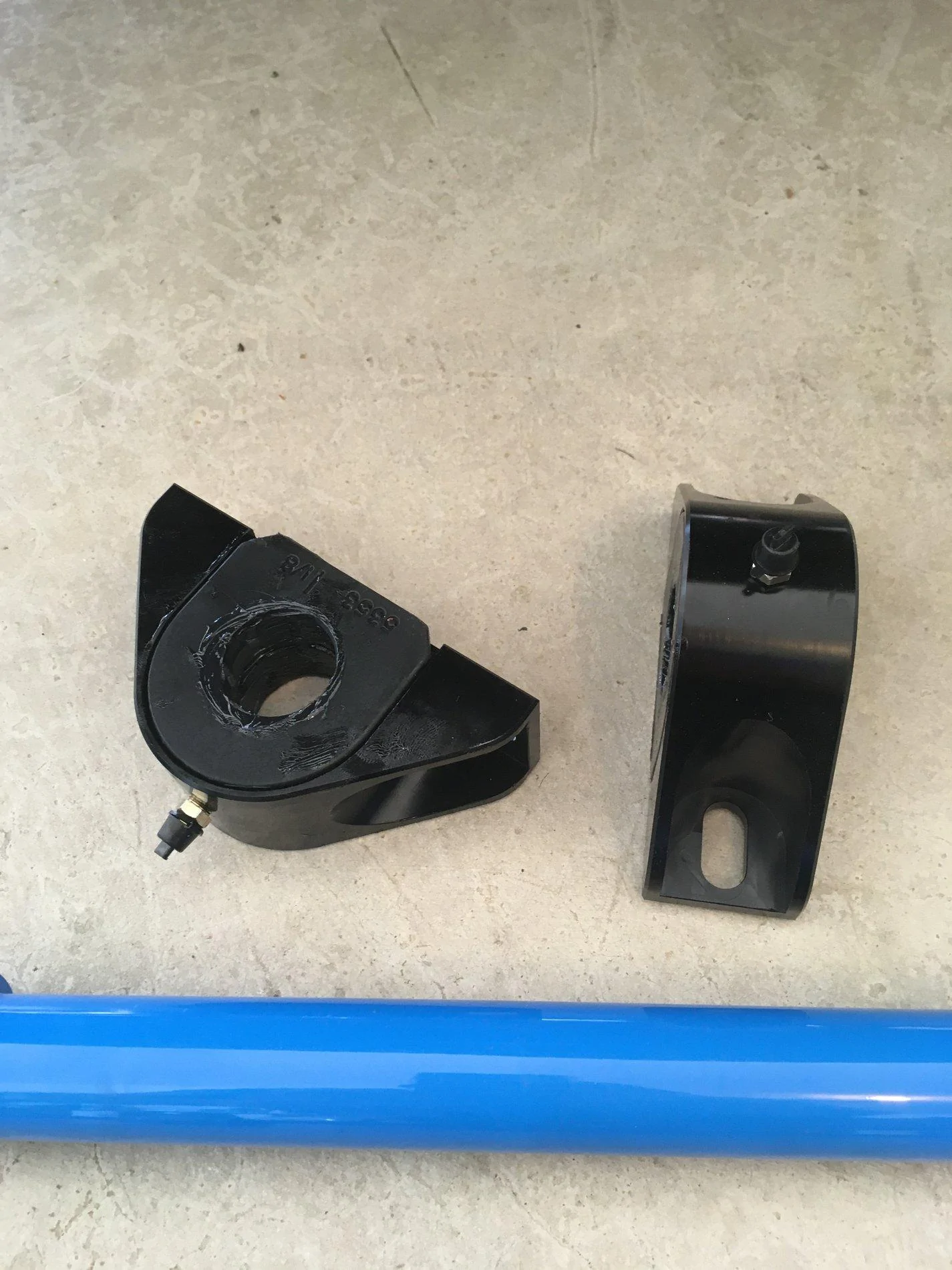

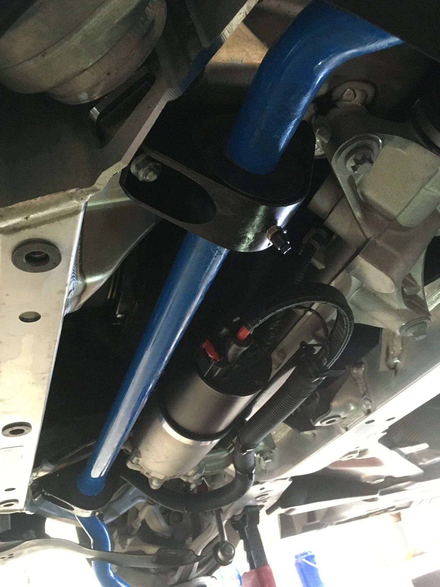

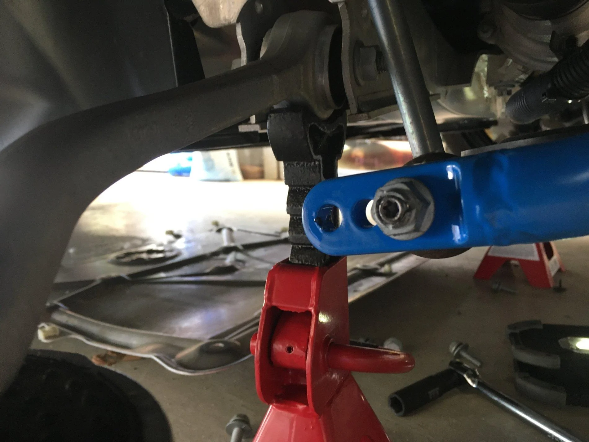

So, I finally received the AFE front, 3-way adjustable sway bar kit. I had called them about 2 weeks ago, and they said they were still making them, but would send out ASAP. Installation in the front was pretty easy, just have to remove the plastic front and middle aluminum covers (a lot of 16 mm bolts and 8 mm screws). The new bar is thicker and a lot heavier (seems to be solid). I used the stiffest of 3 settings to try out with my stock suspension. I have 2 roundabouts (or rotaries or circles depending on where you are from) on my drive to work. Wow, is the car flat when going through those roundabouts! Will test it out on other roads/curves, but my first ride seemed to prove this was a good upgrade. By the way, no squeaks, rattles or clunks. Attached a couple of photos.

@sbodnar my AFE just arrived the other day. I was going to install it but got tied up. Hopefully I can get to it this week! Thanks for the feedback!
It's weird because I thought it might have been used before. The paint on the outer hole was chipped off a little. I see from your pictures that is the same on yours. Was it like that when it arrived?
sbodnar
Stephen
Sep 30, 2019
Boston
2020 Supra, 2015 ML400, 2014 CLA, 2007 G35X
Yes, the paint was good everywhere except the droplink holes. I globbed some clear on them for the install.
