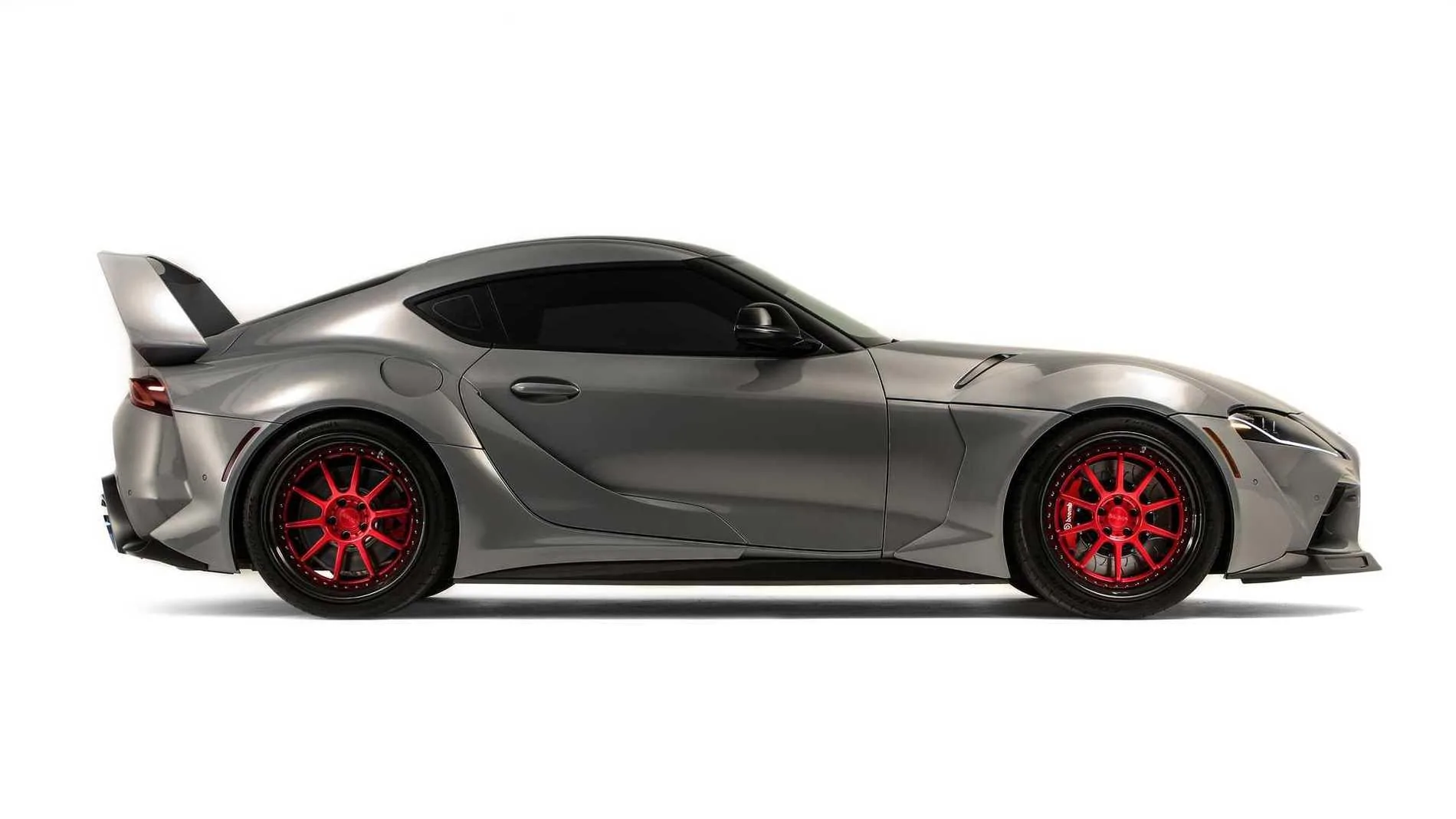

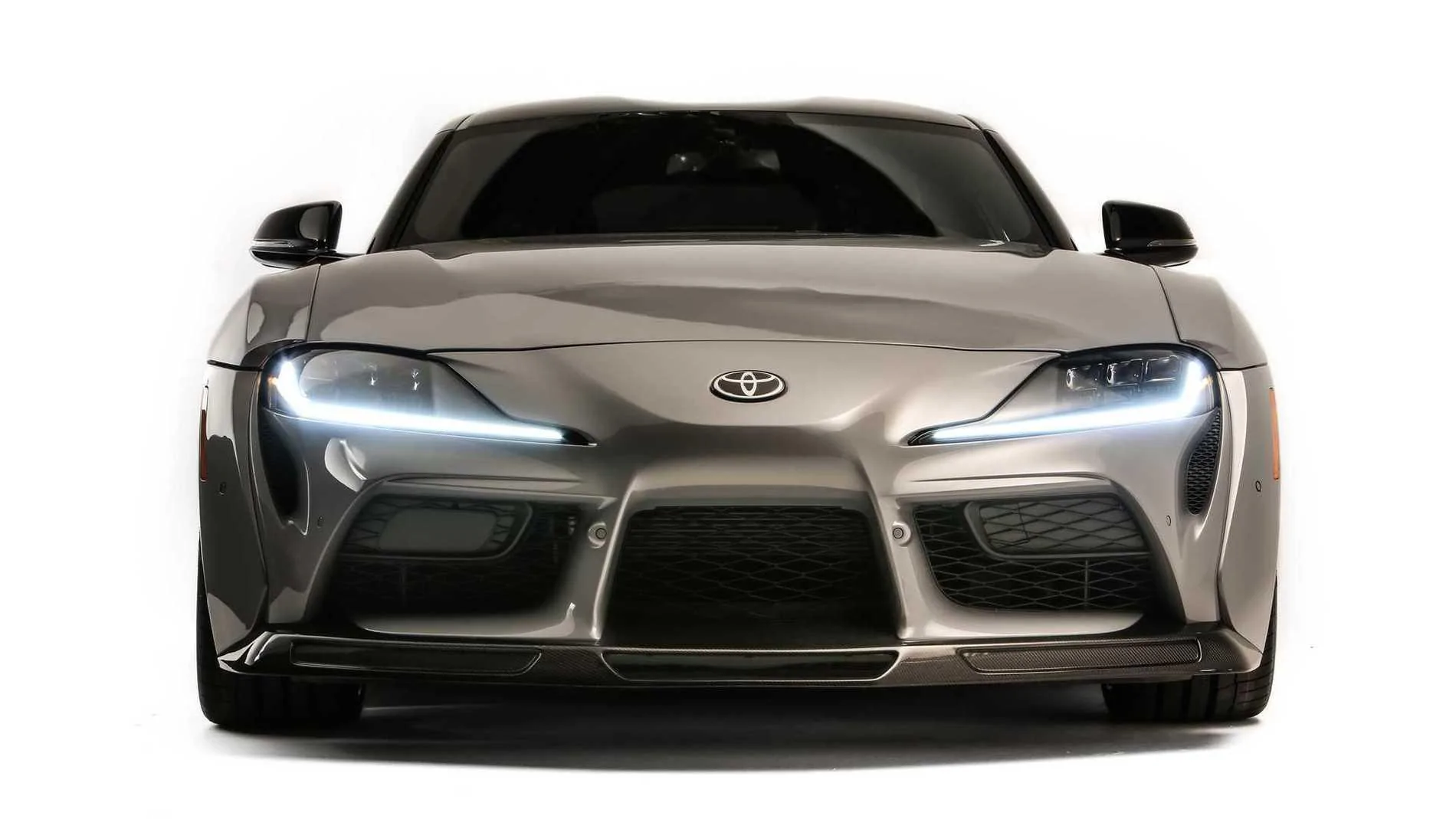

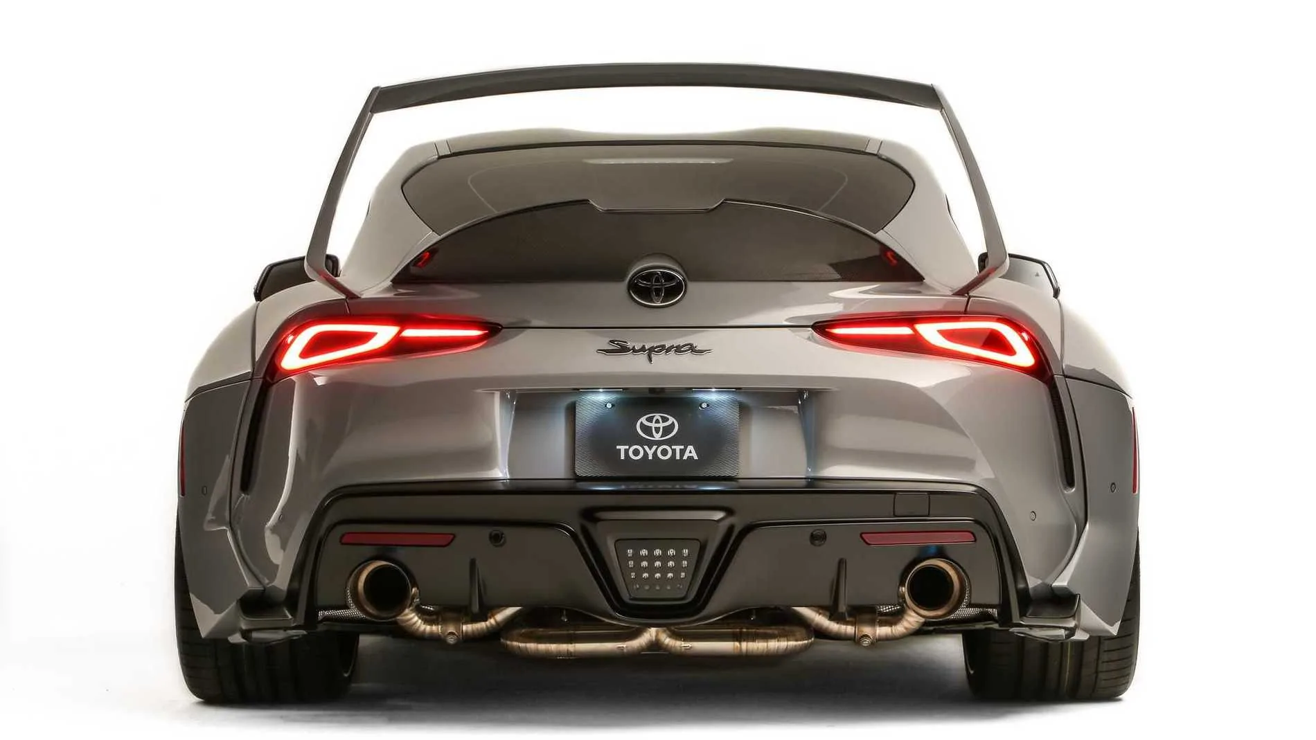

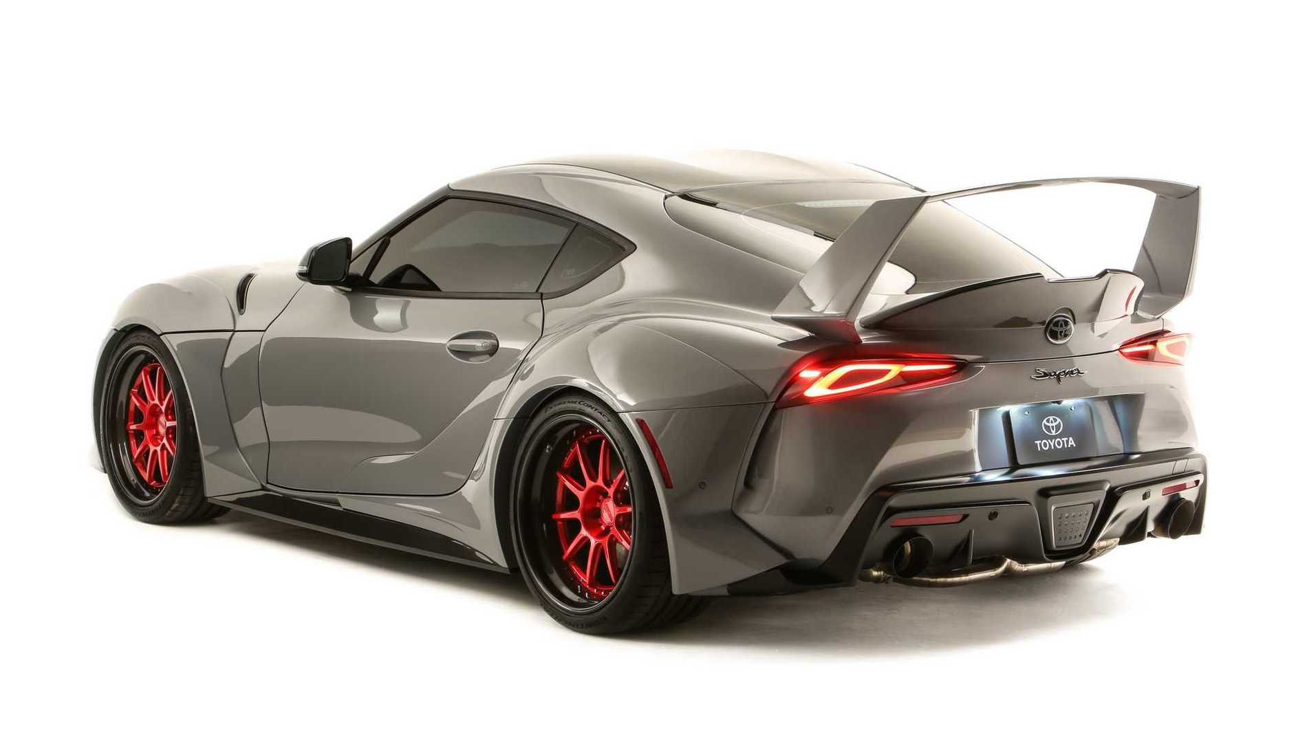

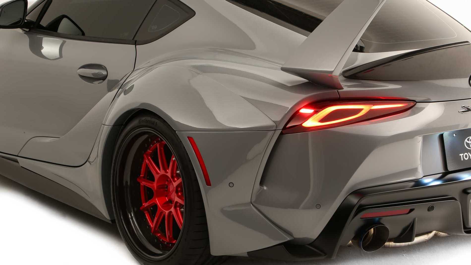

Leos produced several renderings for the new GR Supra. The kit is manufactured with grade-A carbon-fiber and ended up being 20 pieces, including a winglet delete kit. This is the first kit he designed as a bolt-on that mounts to the car like an OEM body kit would. For added weight reduction, a carbon-fiber roof replaced the factory metal panel.
Once the first kit was laid out in carbon-fiber and fitted to the body, the Supra went to Quality Autobody North in Austin, Texas to be prepped for a fresh coat of TRD Cement Grey paint. The HyperBoost emerged from the paint booth with the appearance of a street brawler with its broad, muscular lines.

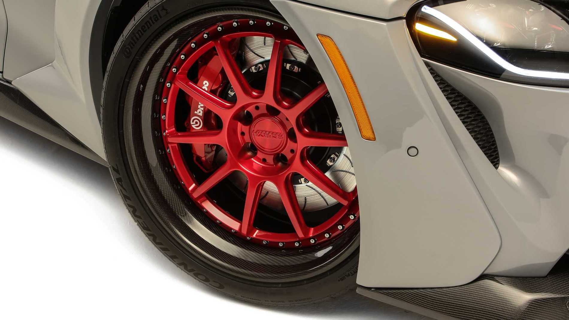

To fill the Supra’s widened wheel wells required a custom solution. Lightspeed Racing stepped up with a custom set of 3-piece wheels with carbon-fiber lips (20X10-inch up front and 20X12-inch out back). These rims were mounted with Continental ExtremeContact Sport tires (285/30R20 in the front and massive 335/25R20 in the rear). KW Automotive V3 adjustable coilovers drop the chassis over its new wheel package.

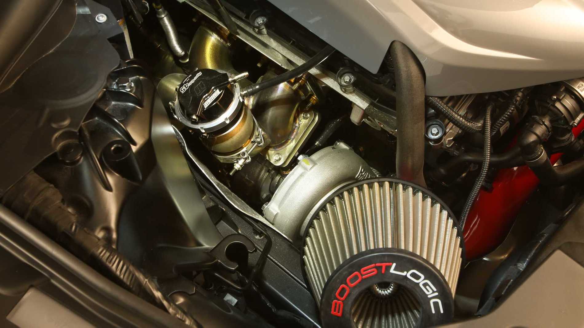

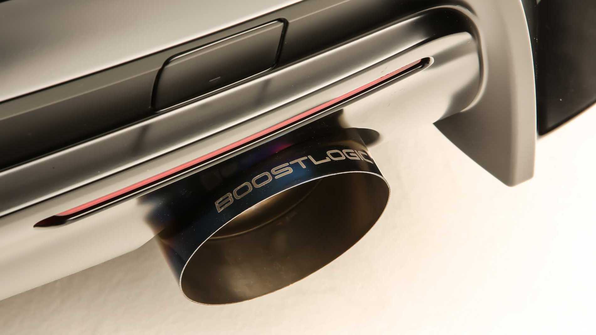

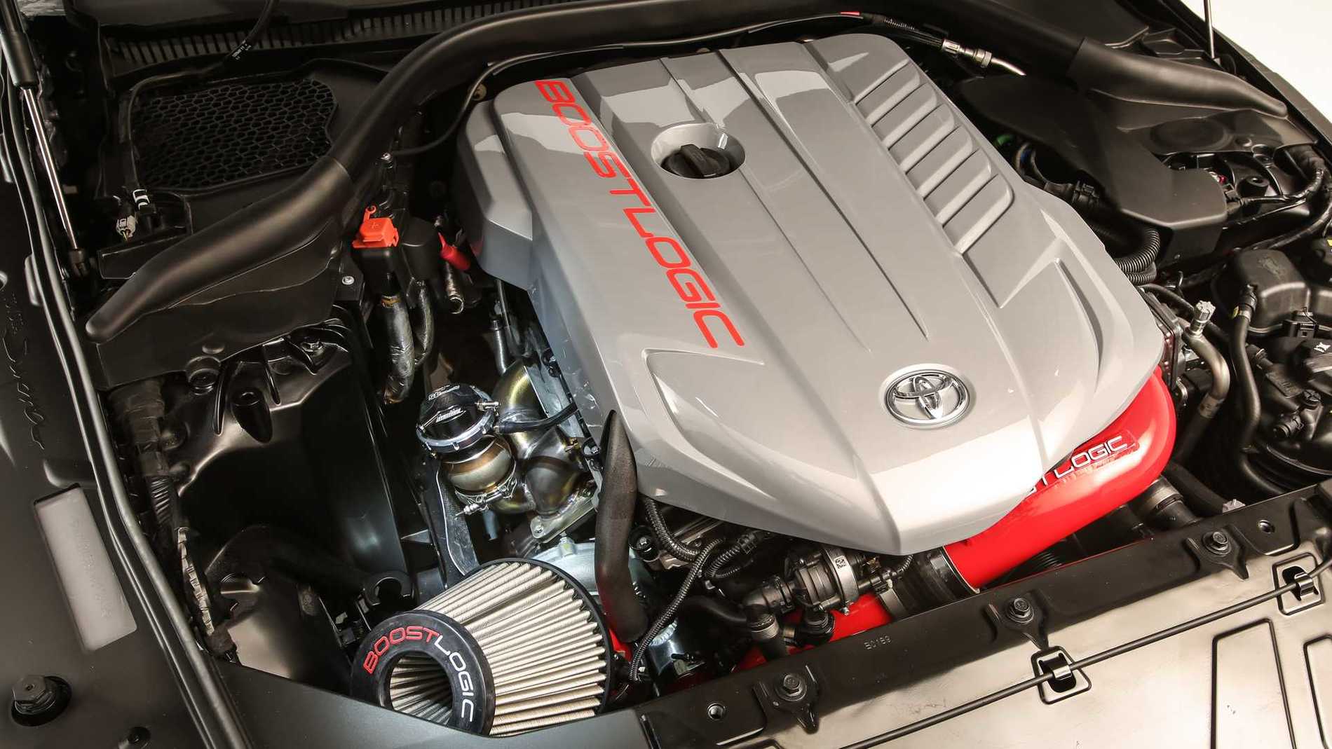

To juice up the horsepower quotient, Zohair Jaffery at Boost Logic delved into the new driveline. Jaffery first fabricated an exhaust manifold that positions a Boost Logic BL Supra 750 Package between the shock tower and the engine. A Boost Logic downpipe and titanium exhaust route spent gases from the turbocharger to the rear fascia.
“To make more power, you have to outwit all of the technology. When you start to make significant gains, the ECM locks you out and goes into safe mode based on the torque sensors protecting the driveline. The car is so advanced, you have to outsmart it to build it,” said Leos. After Jaffery developed the fuel, ignition and boost tables, the engine produced peak output of over 750 horsepower.
Making more than double the factory output warrants an upgrade to stopping power. Leos selected Brembo forged 6-piston Monobloc calipers squeezing 380x34mm two-piece rotors to replace the stock front brake components. This new brake setup increases the heat capacity and the friction surface area for improved stopping performance.

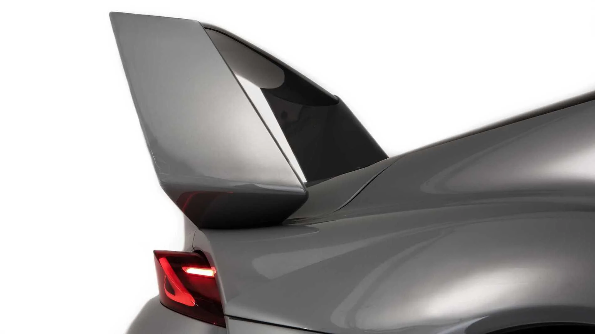

Bodykit actually looks good but that wing and wheels are the worst out of Sema i think.
Wing design, the sharp edges, mounting are awesome, but it's way too big...well beyond serving a purpose :)
My problem with the wheels is there is so much contrast, makes it look like they're 15".
Hats off to 750hp! Nicely done!

I'll pass on the ricer body kit, but give me what's under that hood! :D
