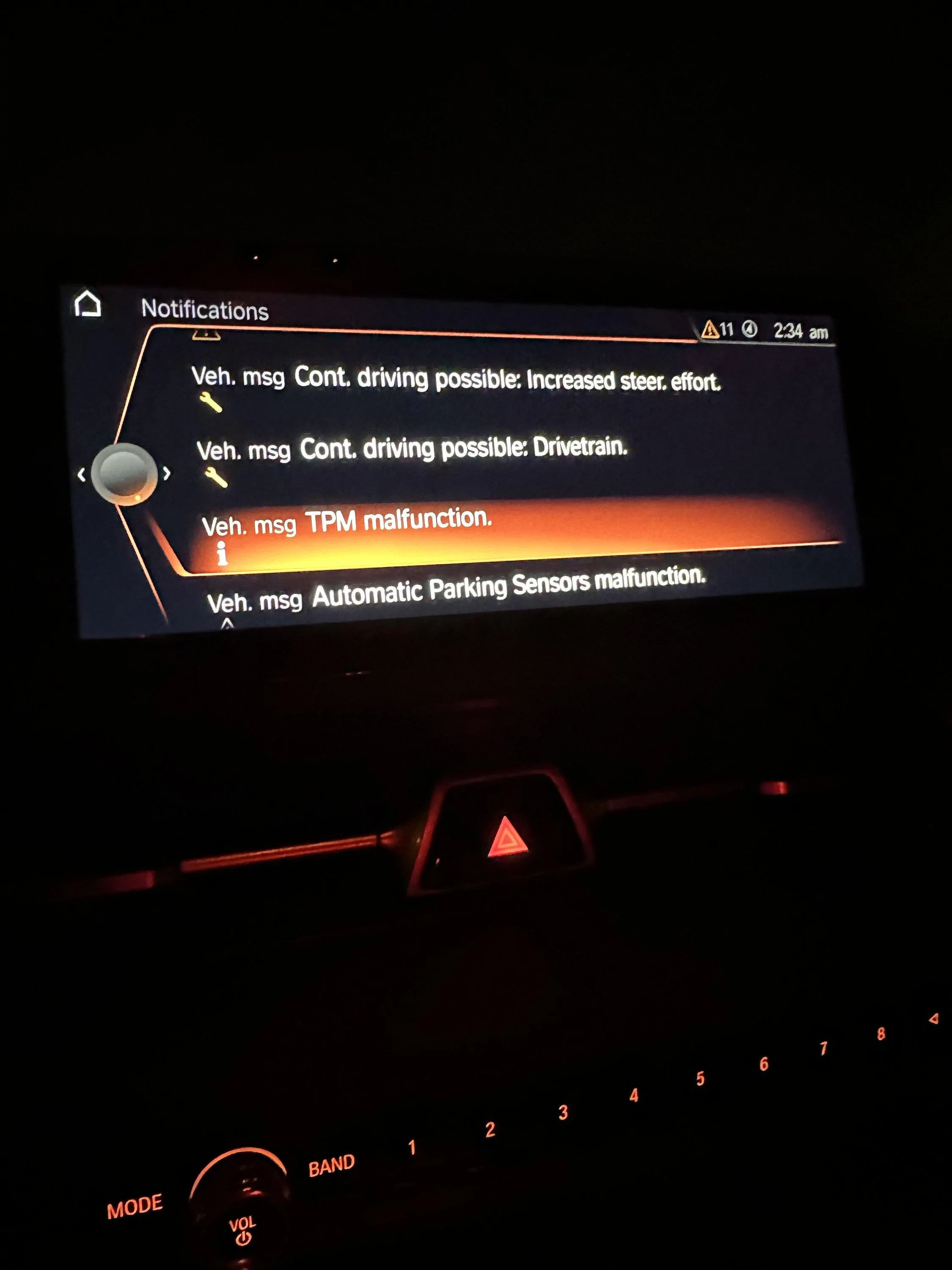

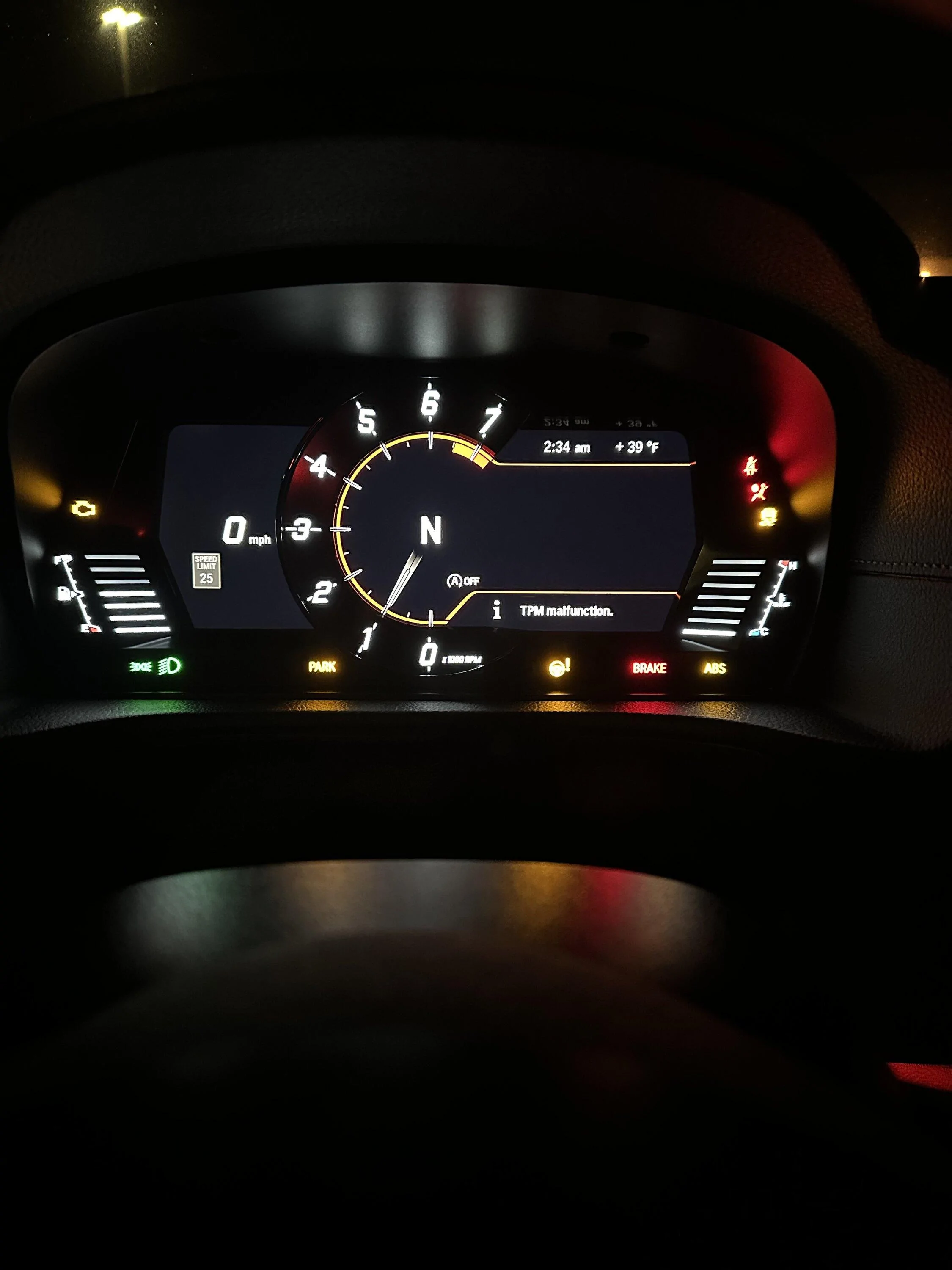

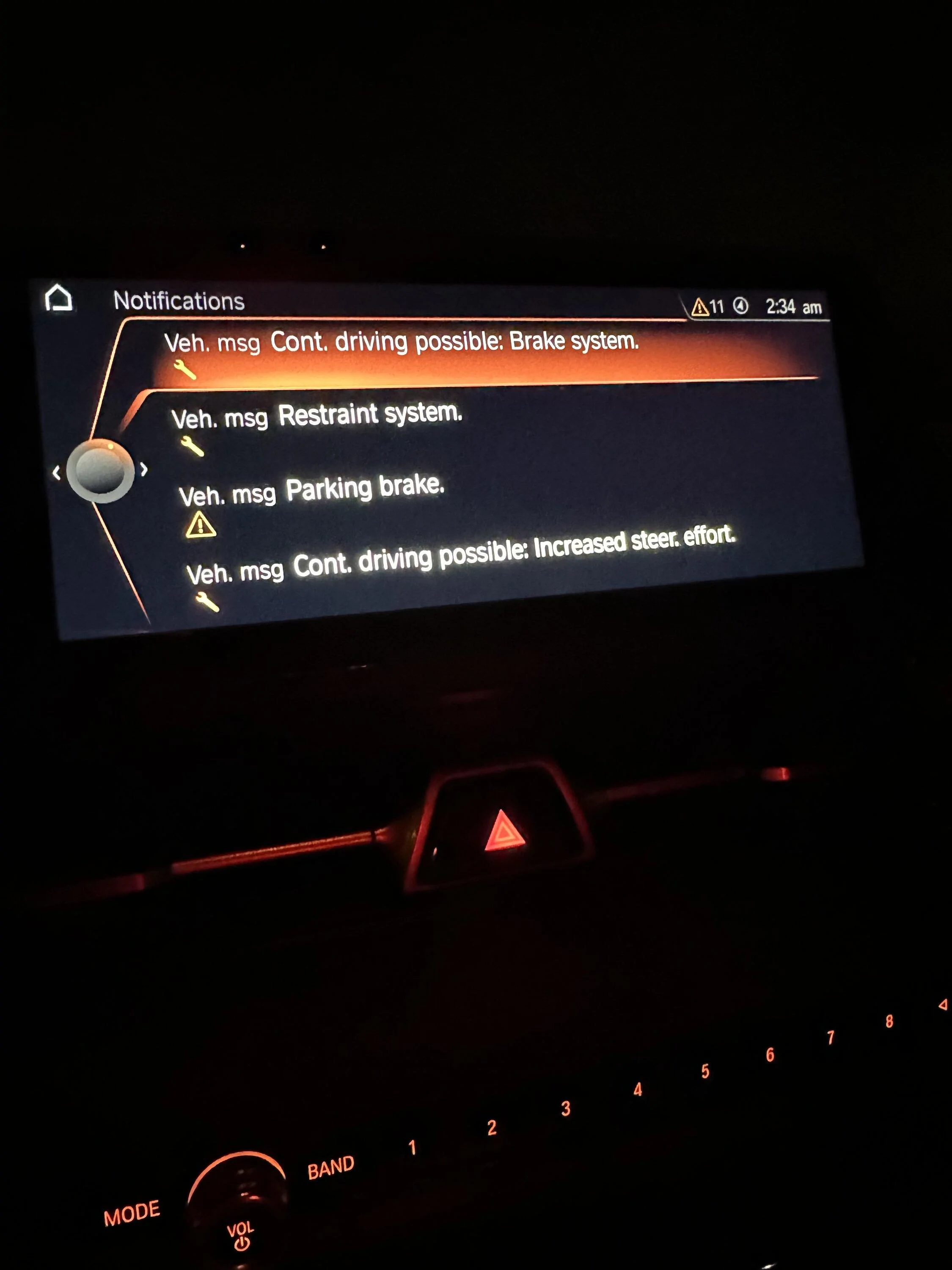

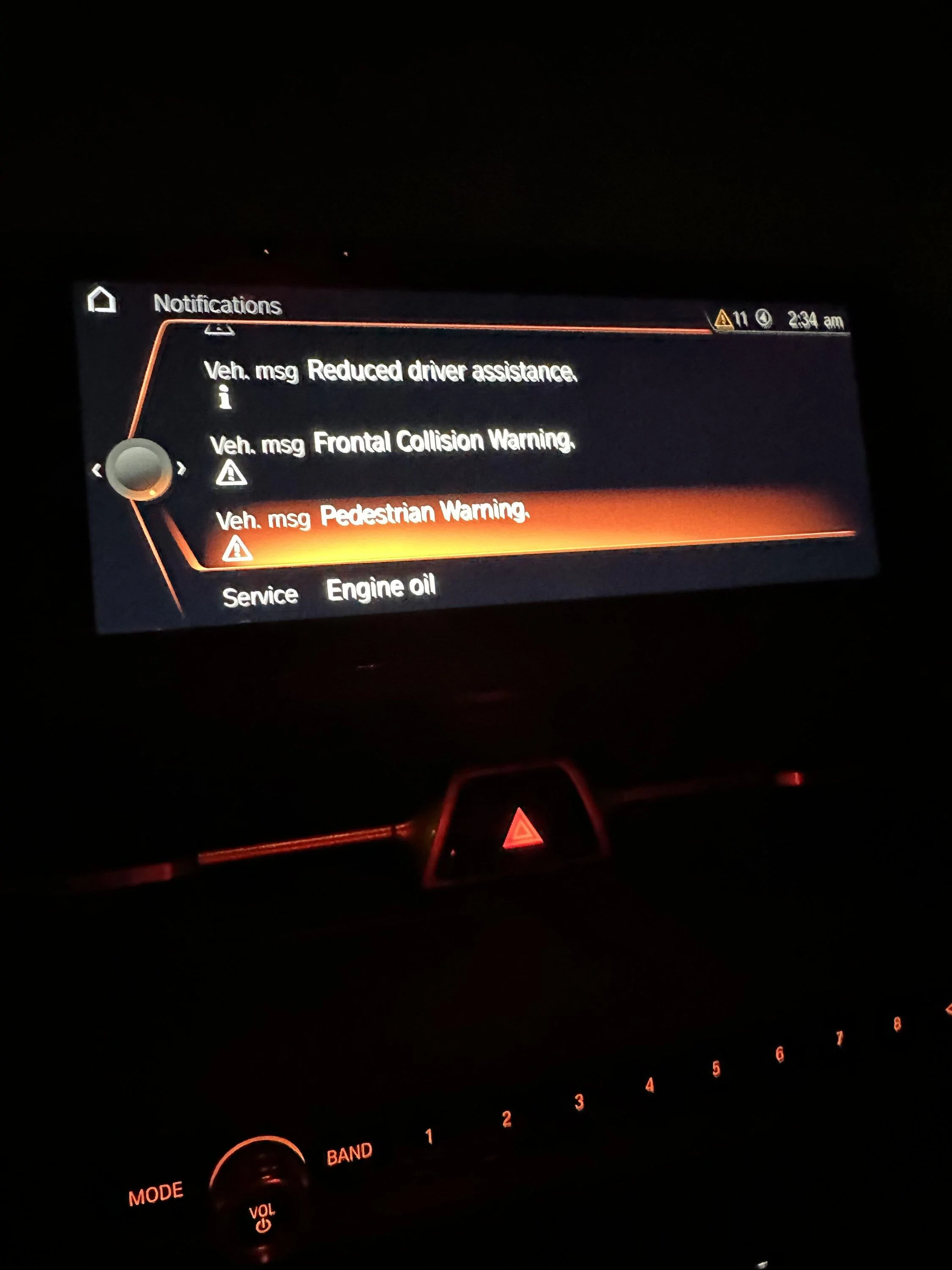

I got off of work and right when I turned on the car all these lights came on
has anybody had this happen to them? It was about 36 degrees outside so it was decently cold I guess not sure if that has anything to do with it?
what do you guys think?
could not move car, the parking break would not release

From previous experience with other makes it can be a failed/failing battery although your car looks like a 2023 model so that seems unlikely. When the load comes on a failing battery and the voltage droops the electronics can go crazy. The cold weather wont have helped. Checking the battery connections would be a good place to start.

I concur and suggest checking battery voltage with multimeter if connections are tight. My 2023's battery had to be replaced immediately when the dealer received it, since the car was sitting at the port/customs for so long and would no longer take a charge.
