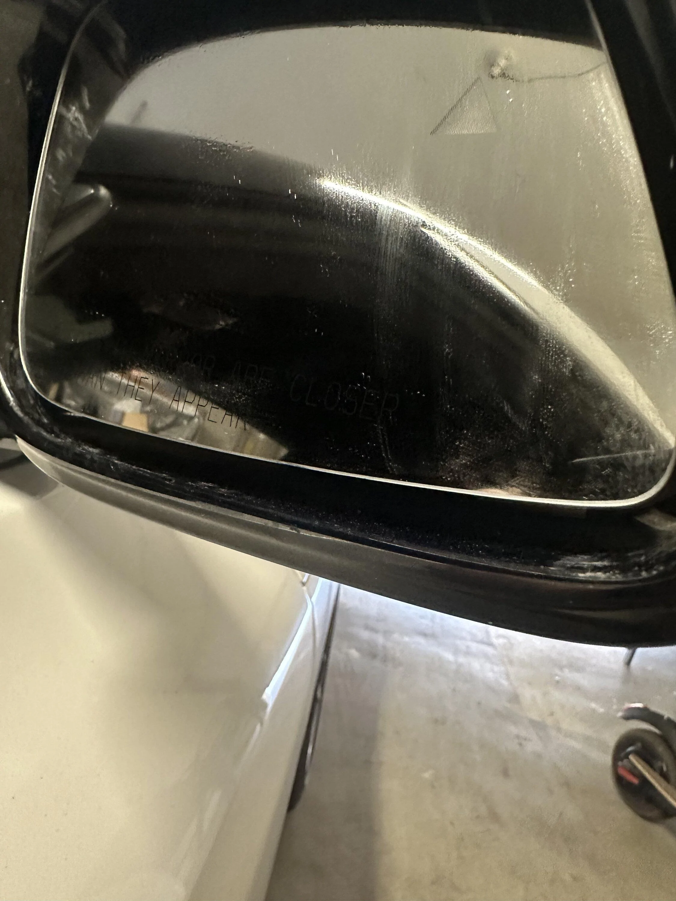

I’m putting on mirror caps and i did one side just fine but my passenger side mirror fits but the gap causes the motion of the mirror to not work any help on this ?

it’s clicked in properly but there’s gap on bottom and it’s touching on top where the drivers side is flush with the bottom and gap on top

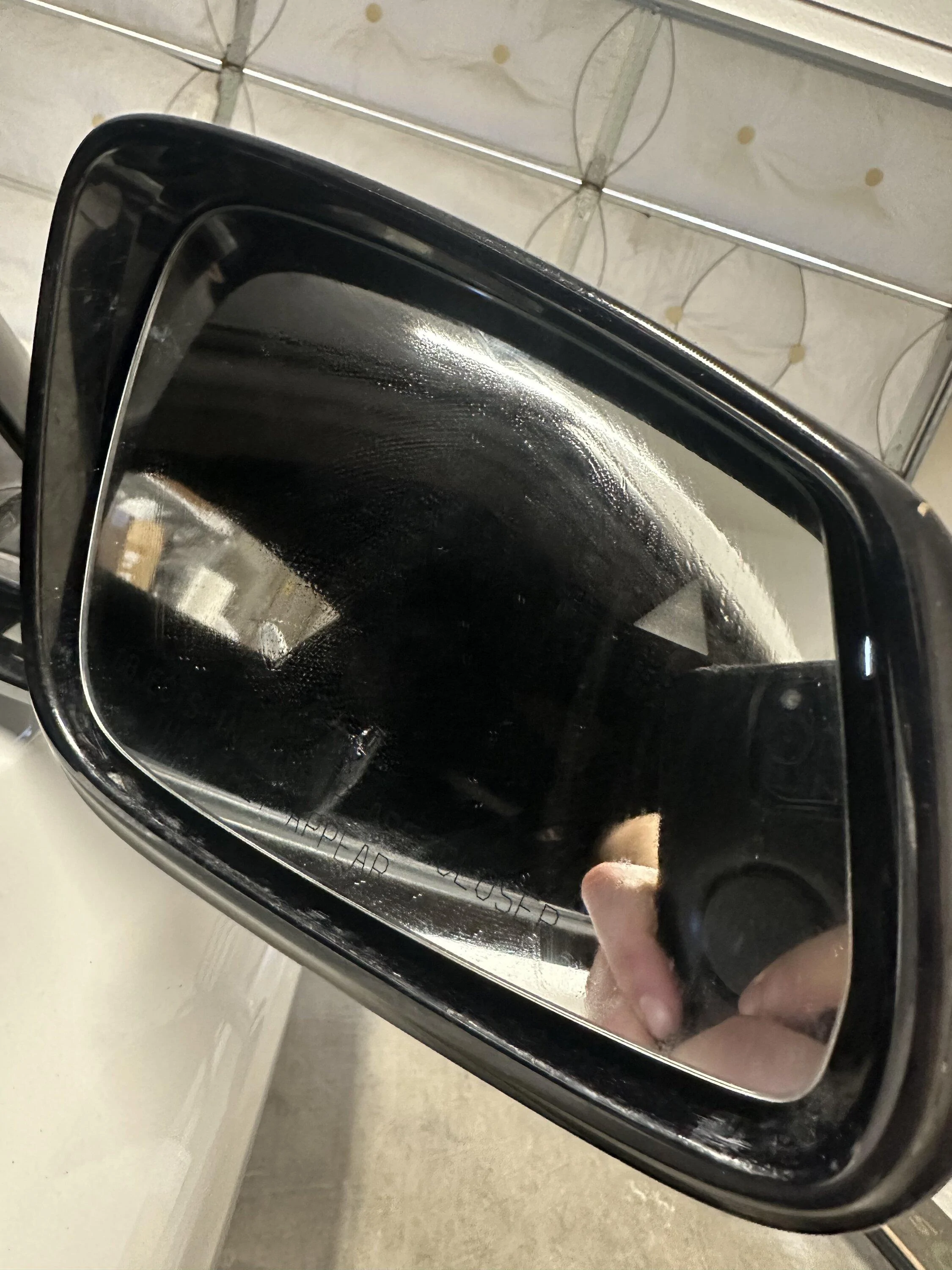

anyway to get this lower?

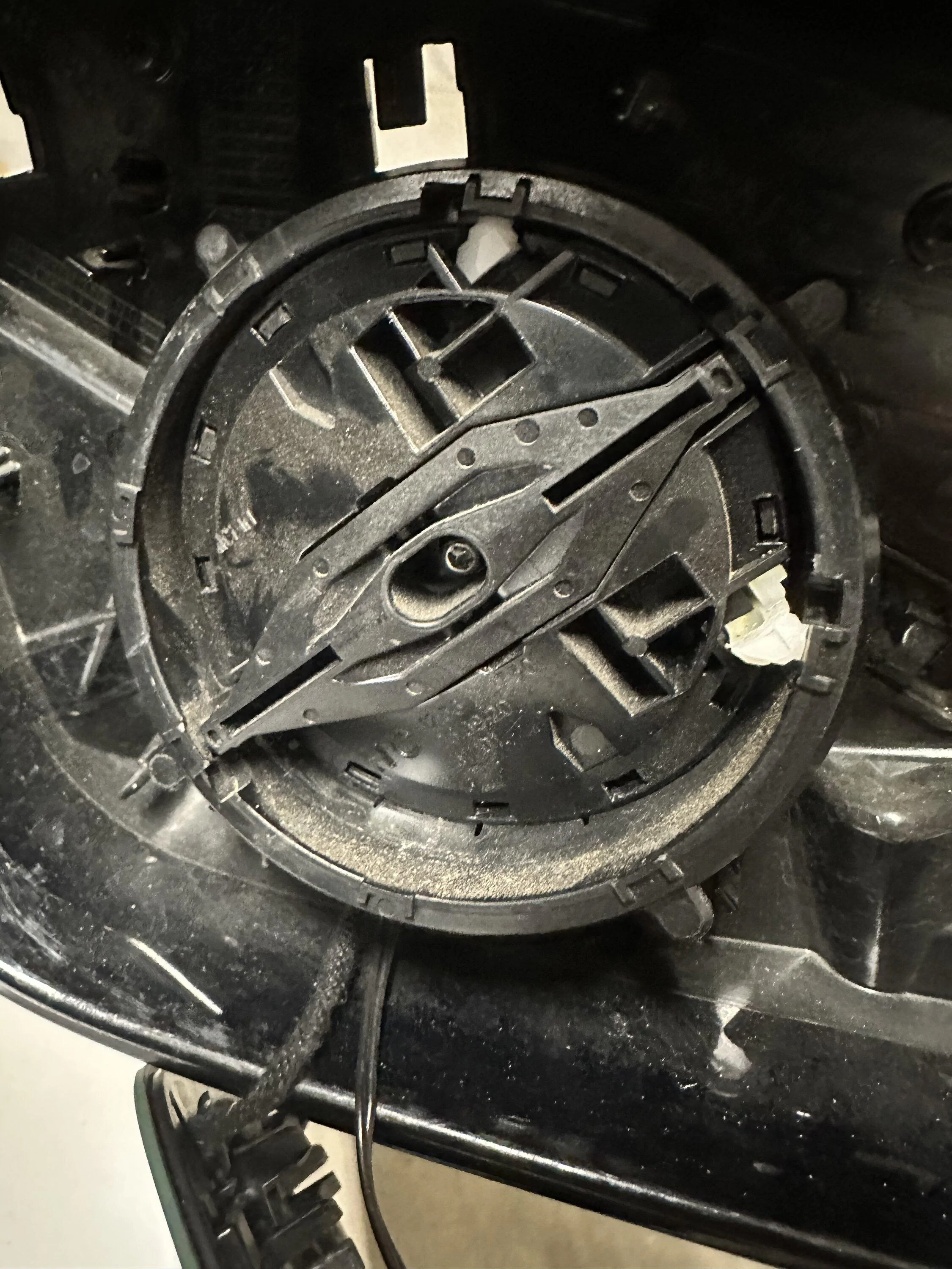

What they mean is to try adjusting the mirror bracket without the mirror attached to the car. Try to align it with center (push in on the bottom until it clicks back).

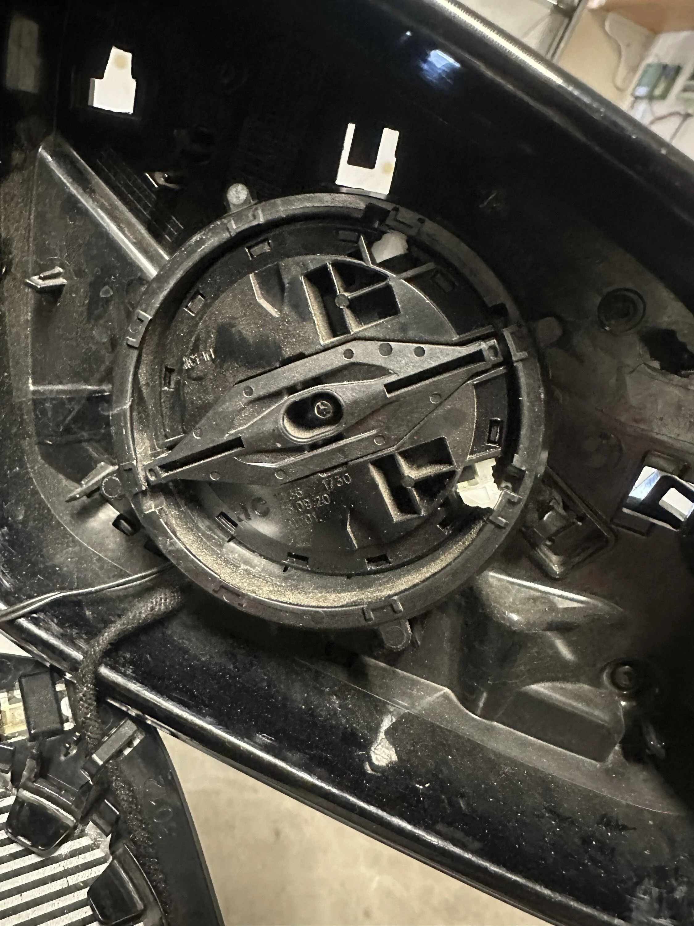

push down on this?

Yes. Thats what the motor is attached to. You pushed it to for up and it's out of whack. Push on the bottom of that to pop it back into alignment then try adjusting the mirror again
