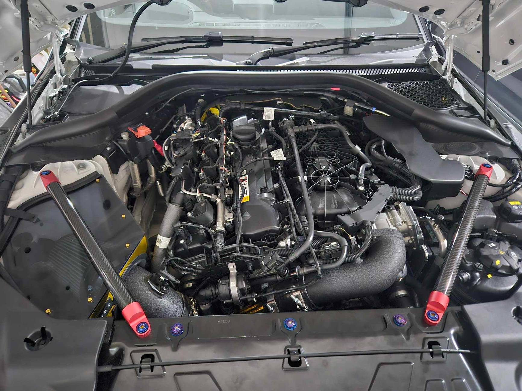

The hks intake can be fitted up to aftermarket stock location turbos. As long as it’s a 4 inch intake. Not all parts can be used on the omega 65 but I think the Pure setups can fit better. Just wanted to share what I had.

This is one reason I haven't gone with the Omega 65 because I want to keep my Eventuri intake. I don't like the look of theirs. I wonder if anyone has used an Eventuri with the Omega 65?

I don’t know of anyone else that used a different intake with the omega 65 besides myself. The hks is a 3 piece design. So it was easier to retrofit it. The omega 65 has a 4 inch intake so the hks was able to fit on part of the existing intake from omega. I believe the eventuri is a 2 piece design and the opening is too small for the inlet to the turbo.
