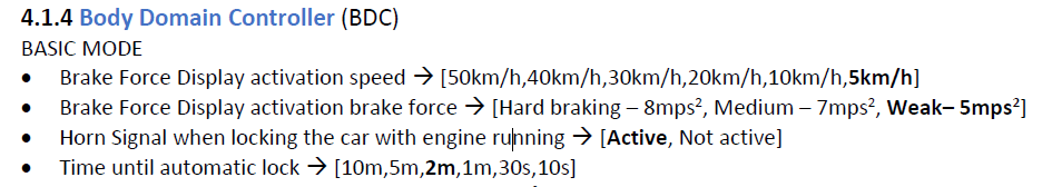

Well I had the same issue with my X5 and could never figure out how to turn that off. I saw in a bimmercode manual posted to this form instructions how to disable that function (not sure if it was verified to work as I haven't done it yet.

You can indeed code it out in Bimmercode.

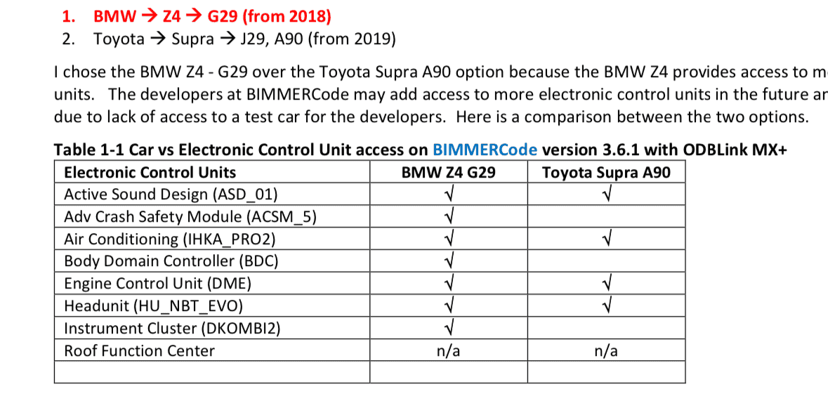

I’ve been reading Bimmercodes manual and I don’t think BDC option is available for the A90?
I could be wrong but this was the chart
