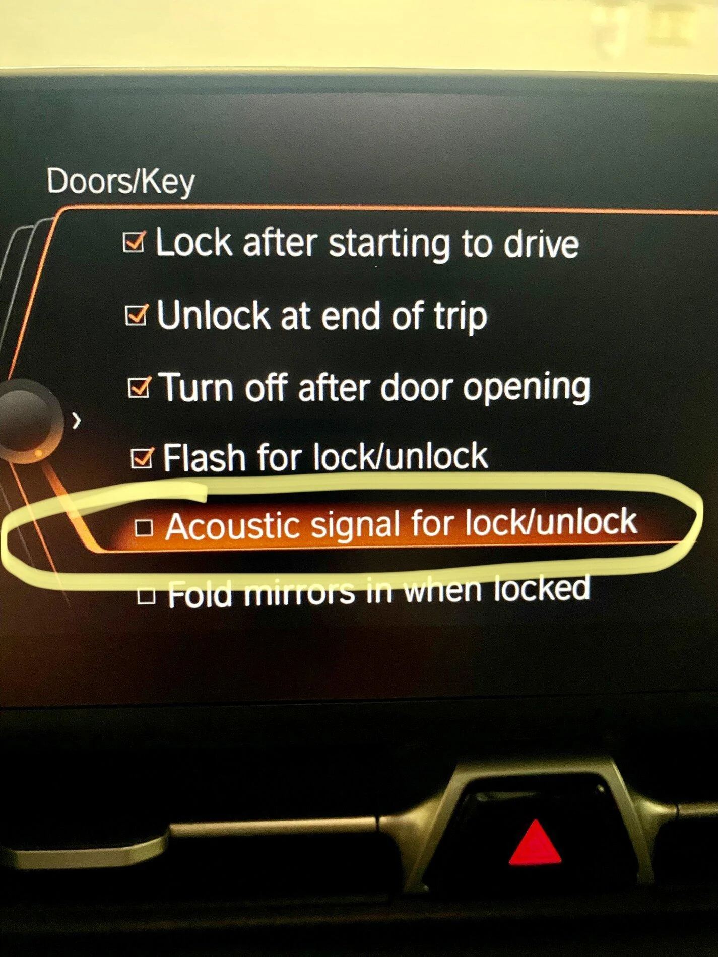

Finally figured out the coding… No more freaking chirp when locking and unlocking the car!
Bimmercode to the rescue.
Now the acoustical option appears on the dash under ‘vehicle settings” … “doors/key” … “acoustic signal for lock/unlock” …. uncheck and it’s off.
Personal preference… I like the parking lights to flash but not the “look at me” chirps.
Silence is key. ? See steps below.

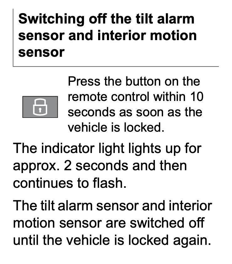

Just FYI- pressing the lock button on the fob a second time within 10 seconds of the first disables the tilt and interior motion sensors on the alarm. Presumably for folks who leave a dog or something in the car.

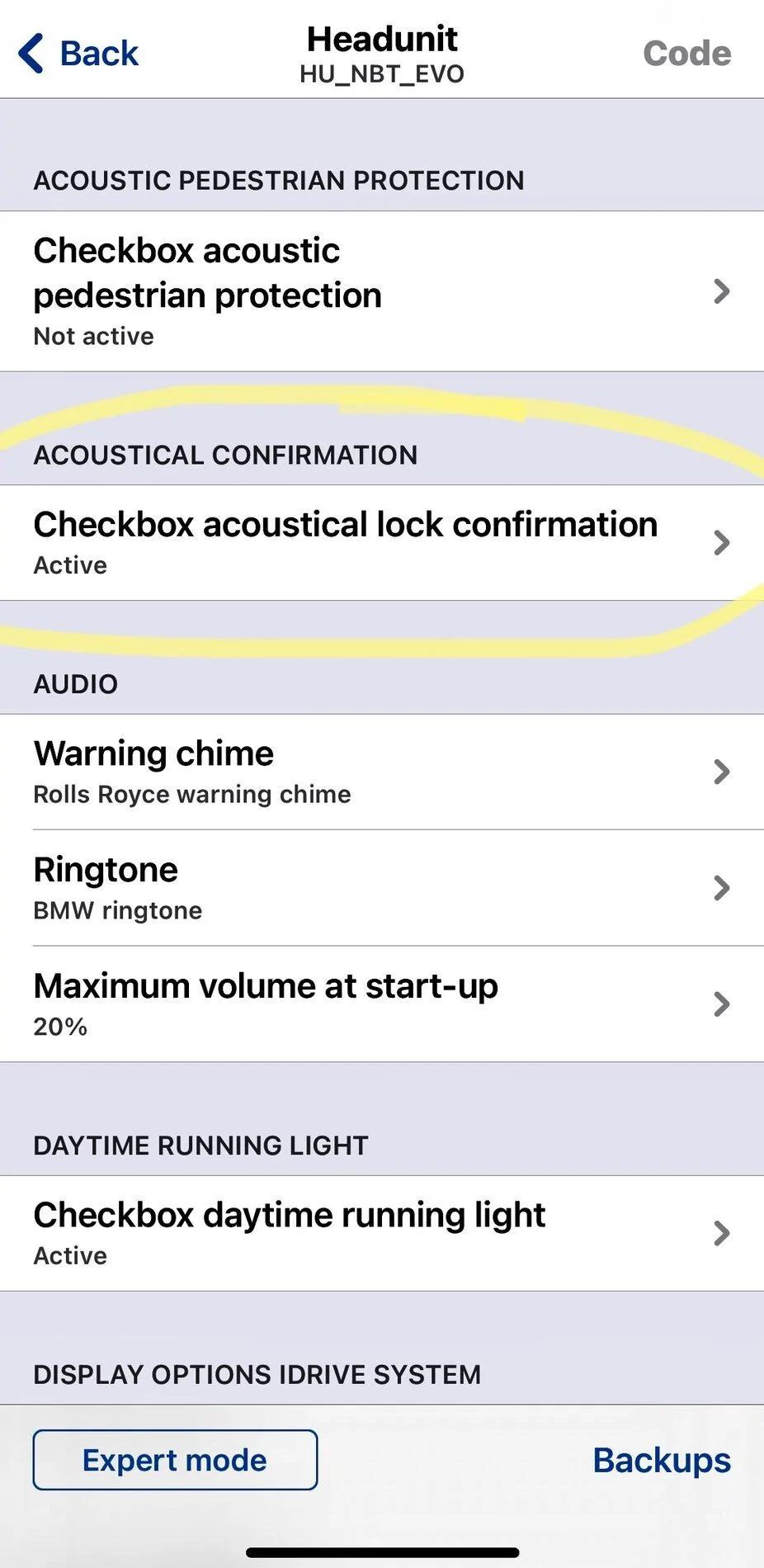

Is there a volume for this in any advanced setting? I want the beep 25% volume, full off isn't great imo
There is in BinmerCode. Turned mine down so it wasn’t ear piercing in the garage. Highly recommend it.
