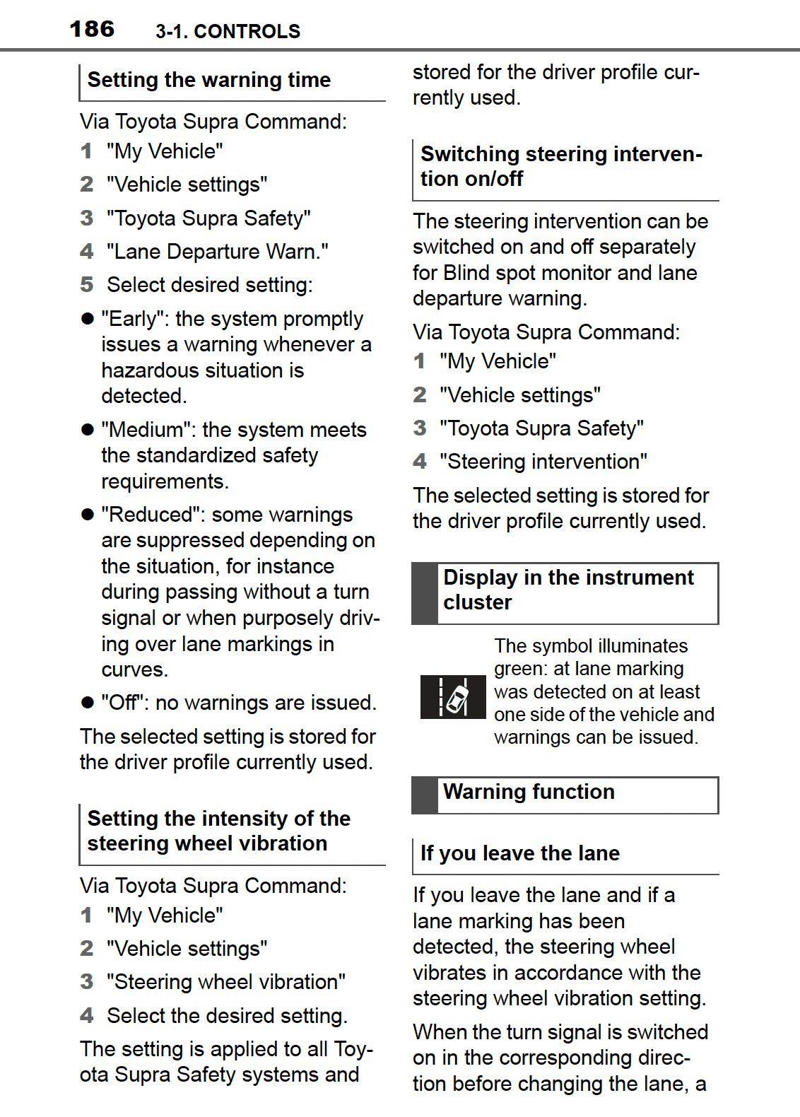

Are you talking about the line assist and what not?
Yup this. I’m with @kaj on this one. I’ve turned it off many of times in the settings. Sometimes it stays. Most of the time it doesn’t. So, I just do the @kaj pre flight checklist, good to go ✈
