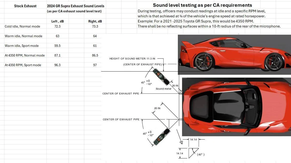

Latest development: I just had a talk with a CA noise-testing employee. He sent me a more detailed guide with layout of the test setup. I changed my drawing to the attached.

I created a video that runs through various state restrictions regarding exhaust noise levels and how to test your car for compliance. My test was with the stock exhaust as a precursor to a test of an incoming Dinan cat-back.
Of course, my stock exhaust system passes. It'll be interested to see how the Dinan does. Note: Yes, youtube rotated my photo.:rolleyes1:
Measuring at 20 inches, you're likely to fail. Here is my Dinan measured at about 15 feet. I also have a high-flow catted downpipe.
At 20 inches, you'd catastrophically fail!
I do agree that the CA test description is not very clear. I kept my sound meter at level position but 45° from the tail pipe (which is level with the ground) position.
You angled your sound meter to about 45°.
I may contact the referee to clarify.
I do expect the Dinan to fail in Sport mode, but thankfully, I have factory-installed downpipe and cat. Many Supra owners do not.

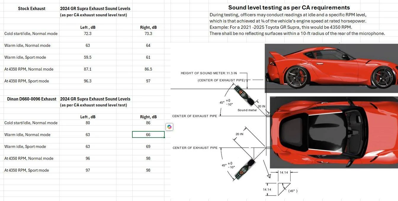

Here's what I measured after my Dinan cat-back was installed. The tone is noticeably lower but not as loud as the Borla Atak videos I've seen.
