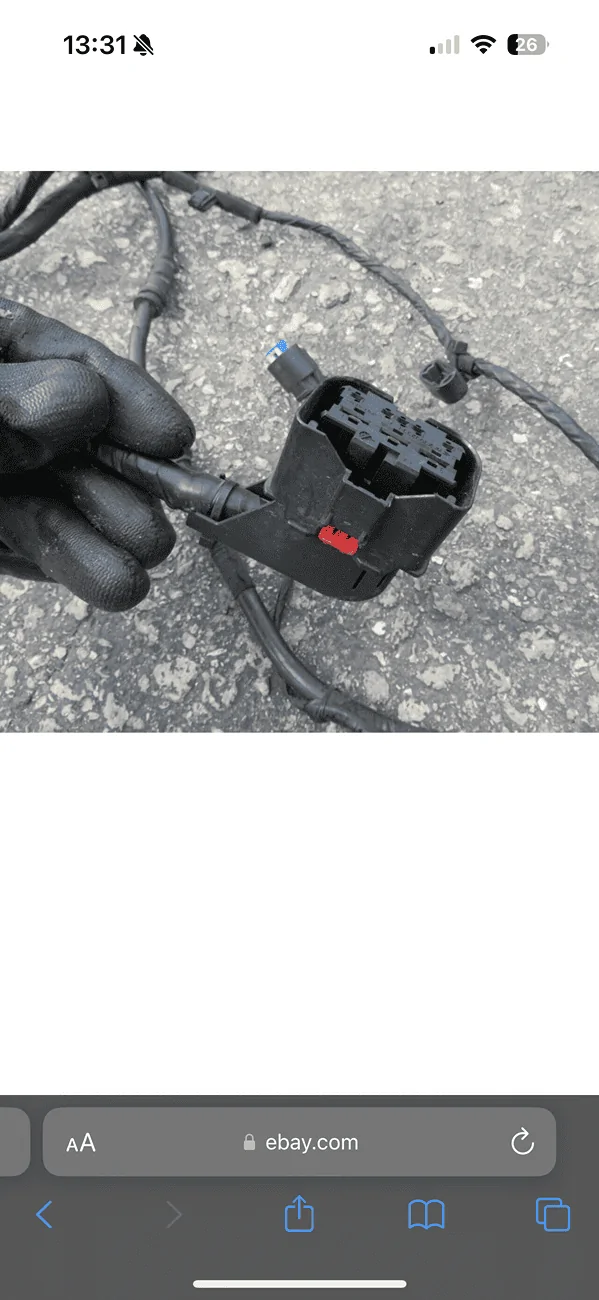

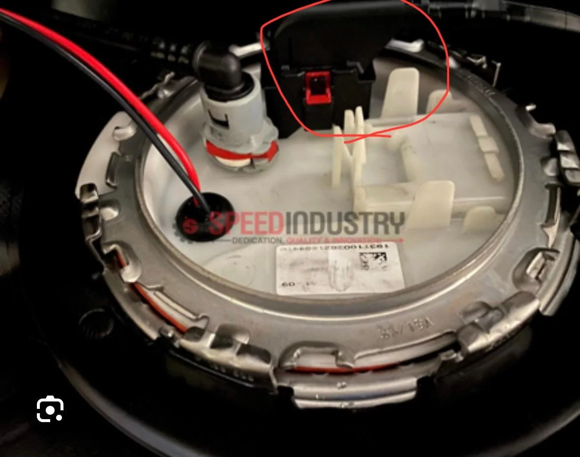

I had cut off this connector circled in red about a year ago to go with a radium top hat. Since then I have had terrible fuel issues. Low fuel pressure, hard starts, and now it doesn’t even start. It caused a short in my system. Come to find out it’s from the top hat. I am looking for this piece specifically or the entire harness it belongs too. Thanks yall.

Long story ? I had a radium top hat with 5iveperformance fuel system and reflex. I had a 340 racetronix pump in the housing. Well ever since I did the fuel system I somehow had low fuel pressure. I replaced the factory LPFP and HPFP. Still low pressure. Well come to find out something is wrong with the radium top hat. I’m getting continuity between almost all the wires. I checked the prongs and they are insulated but I’m still getting continuity. So my reflex says ground short and because of that we suspect that’s why the car won’t start. So I’m swapping out my entire system. Going back to factory top hat with a PFS drop in. Imma keep my fuel lines though. -8 PTFE from top hat, through external fuel filter, reflex pressure sensor, Y off, one line goes through flex sensor then to direct and other line goes to port rail with a pressure gauge at the end.
