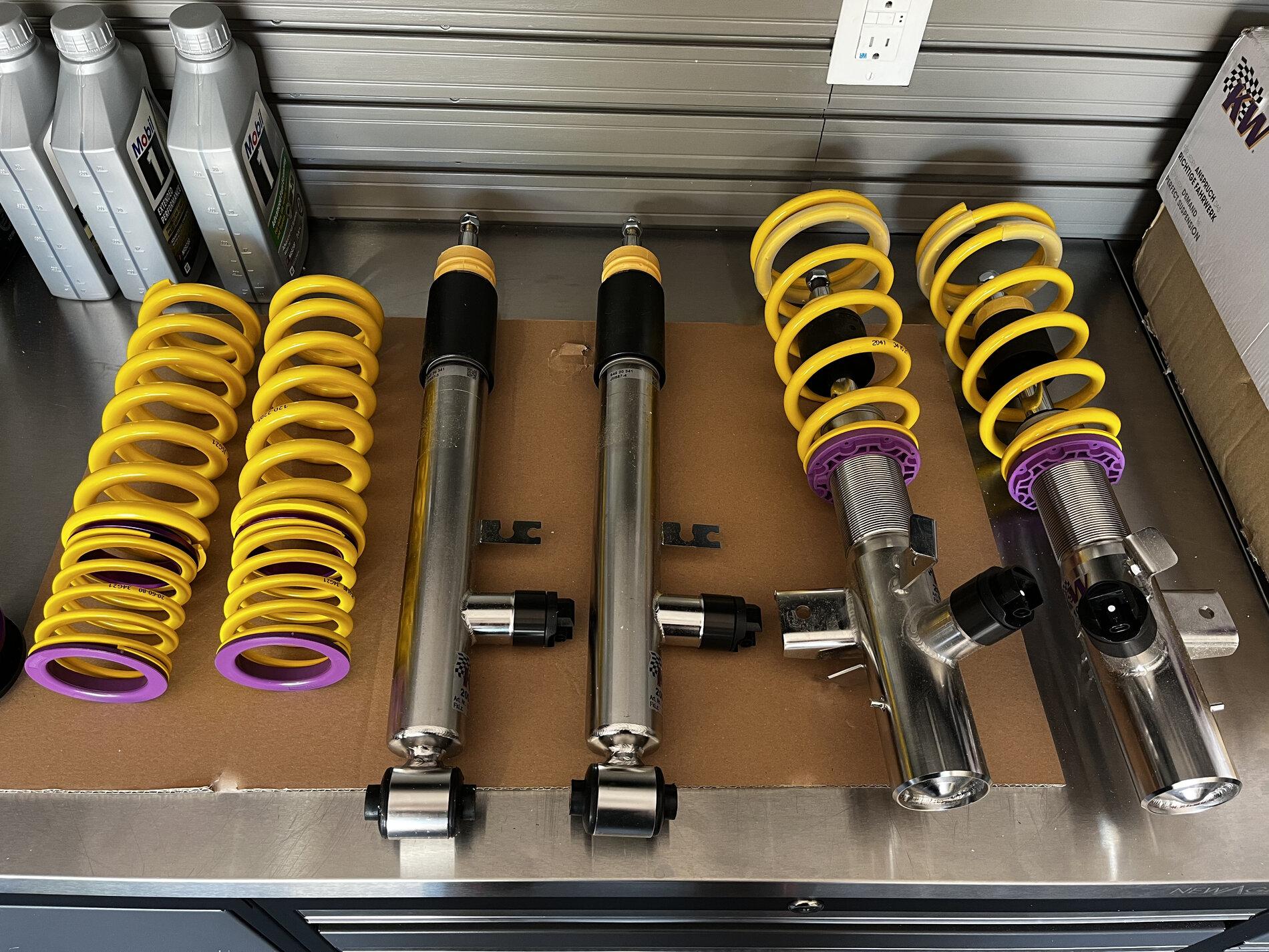

Sorry to bump an old thread but theres not a lot of DDC coilovers out there.
After a 19 week wait I FINALLY got my KW DDCs in yesterday. I was reading through the install and watching a few youtubes (for V3, nobody seems to have the DDCs). I think im missing a part.
Heres what i got from KW:
Looking at the manual, and watching youtubes, I think theres suppsosed to be a sleeve on the bottom of the front struts:
Does anyone know if this part is supposed to be included?
THANKS!

You appear to have all of the parts. Are you referring to the "distance collar" or the top hat. There is no distance collar, just the lower strut mount but you need to make sure that the peg on the strut aligns with the slot on the mount. You reuse the factory top hat unless you buy an aftermarket hat. I purchased the aftermarket unit which allows for camber adjustment.
