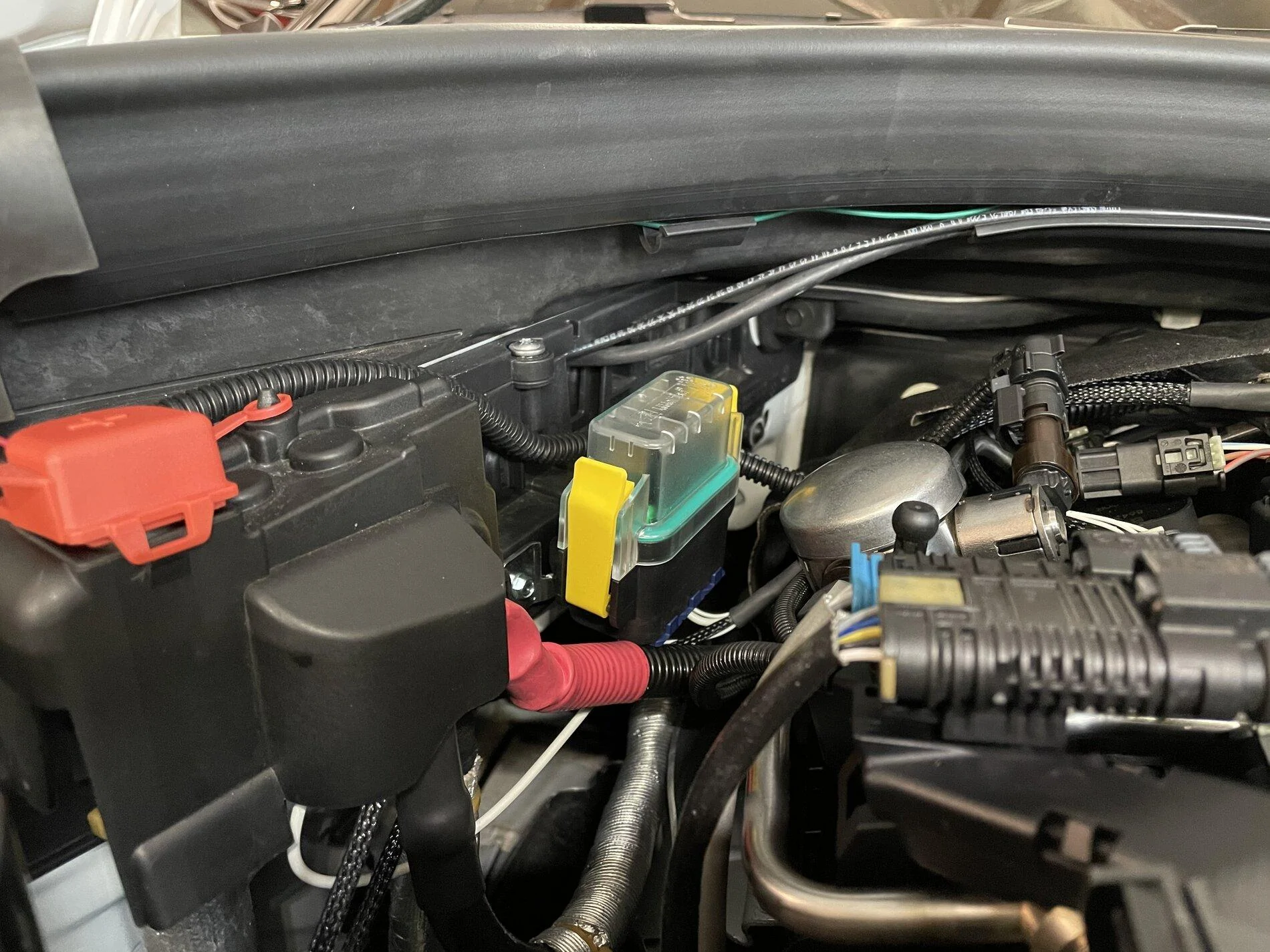

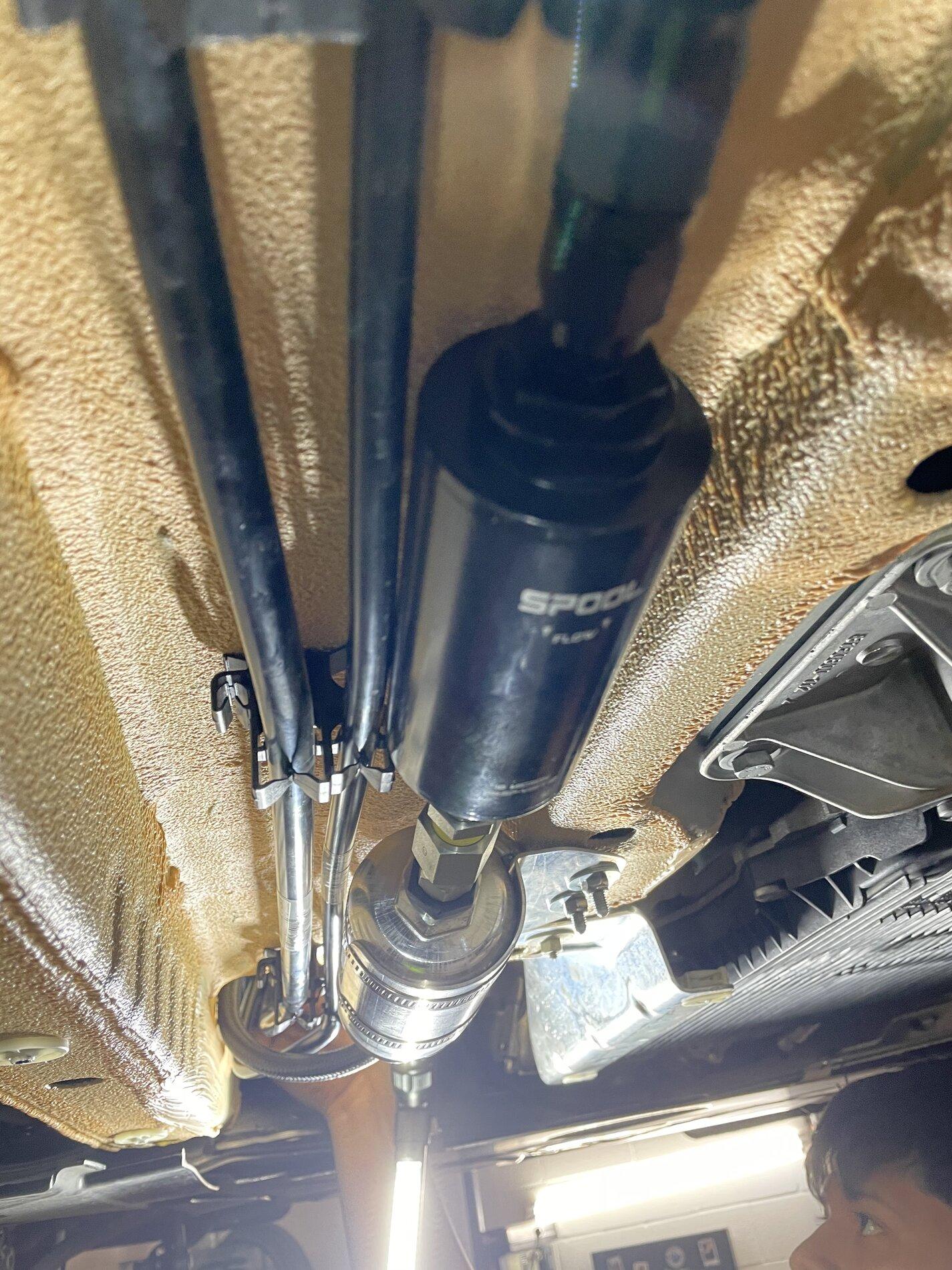

We installed it on 2 of our shop Supras.
These pumps are known to flow for days!
