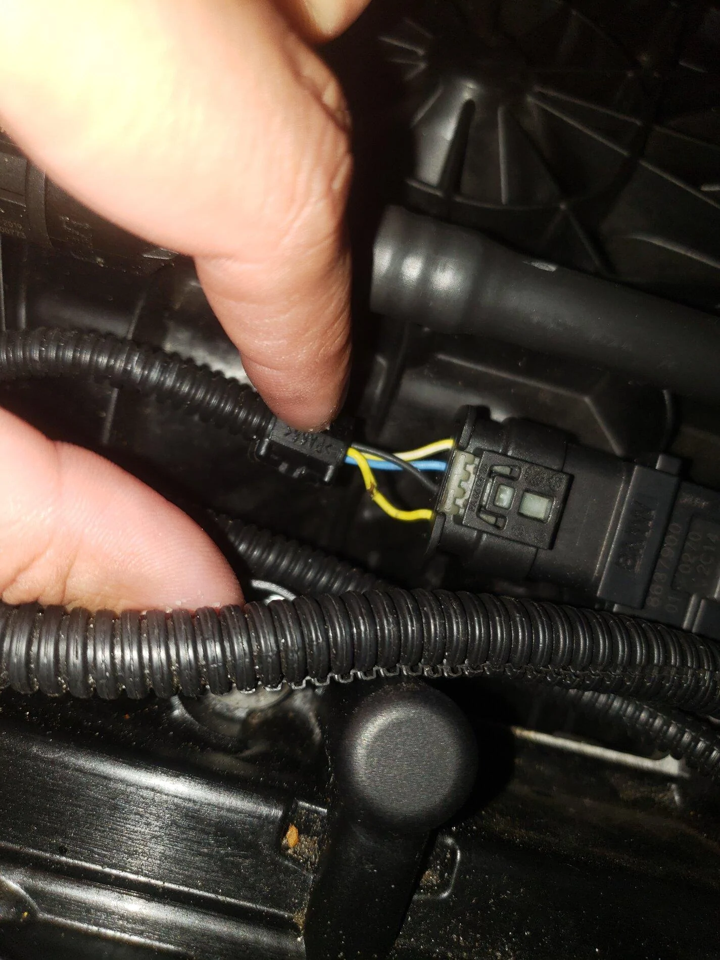

Hoping someone knows a place to get these, looked over stuff today and clearly the P.O probably had a piggyback, however that wire sheathing is damaged and om getting some odd abrupt and then unabrupt acceleration cuts that almost feel like boost cut. Im wondering if this exposed wiring leading to the MAP sensor could be the issue. Problem is I dont think you can get just a small replacement section with the new pigtail so was hoping someone might have a source for the pigtail ?

I'd just unplug the harness temporarily and solder it back together.. if that really is a continuity problem. If not, just e-tape it.

Thats the plan as of now, I think im going to cut the harness on that wire and solder in a new piece
