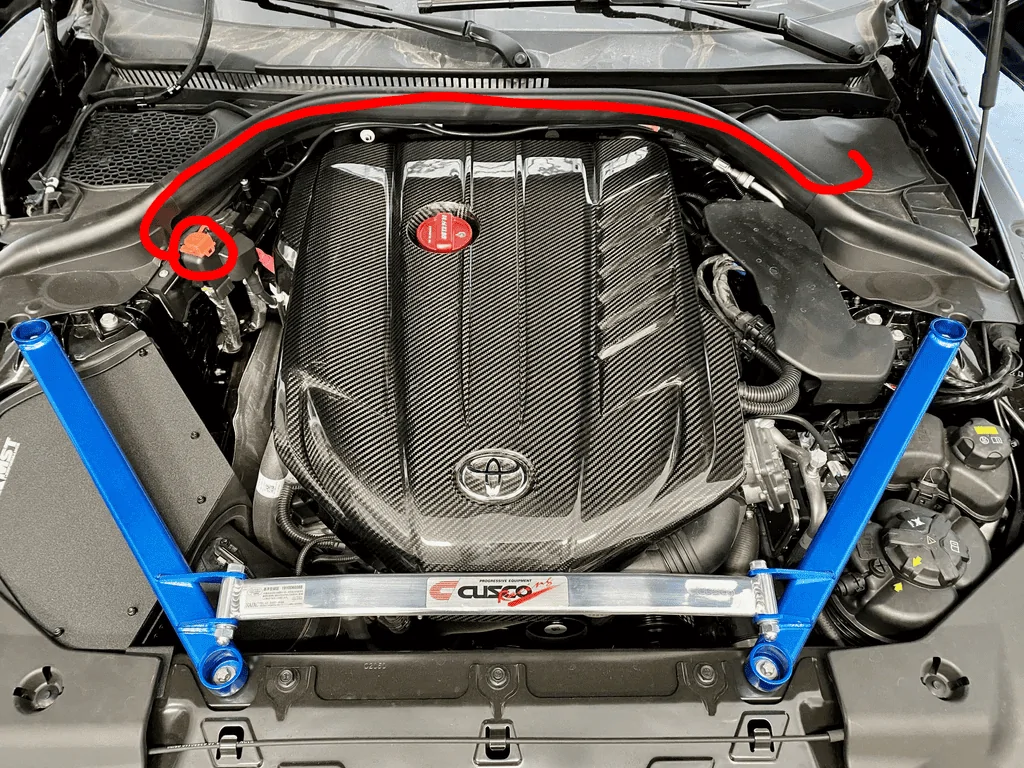

Hey guys, wondering if anyone has install LowGlow on the Supra. I watched the YouTube videos of the install but they don’t go into much detail. Wondering if anyone has any pointers and what they did with the button on/off controller when installing, placement etc.

The easiest method would probably to use the +12v from here and the ground next to it on the strut tower. Tuck the cables under here and run the controller through the hole in the firewall where this marking ends. The strips you would just zip up under any plastic trim pieces.
