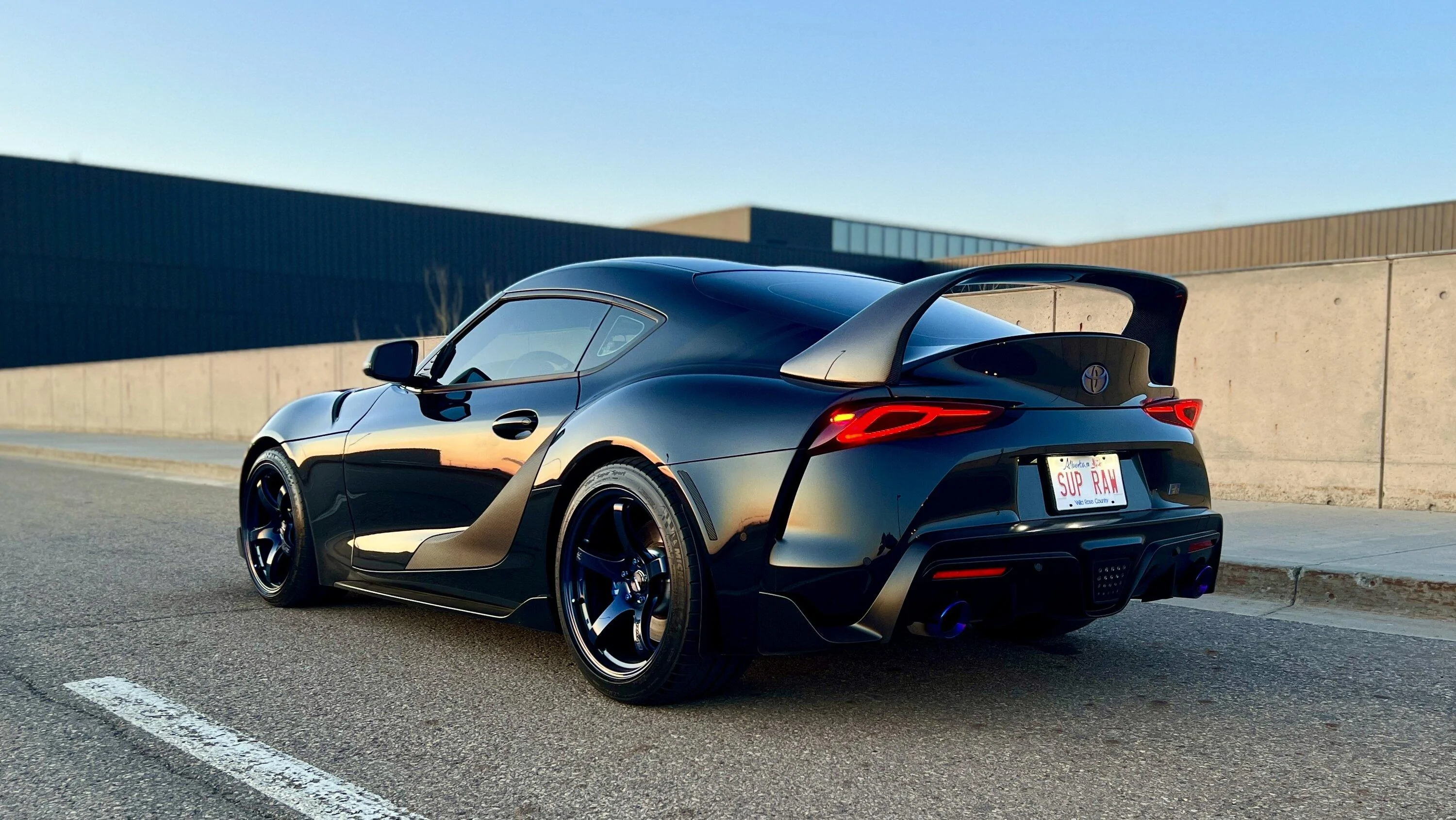

Surprised a shop wouldn’t do it. There is no kit that I know of, but I did it myself in my garage. Measure 6 times, drill once. Seriously, it isn’t hard. Lay down painters tape and adjust until it’s perfect.

^ I did the same thing. Kind of traced a template on a piece of paper from the bottom of the wing and laid it out on the hatch.
Super easy to drill once I discovered it was plastic and not metal, haha
