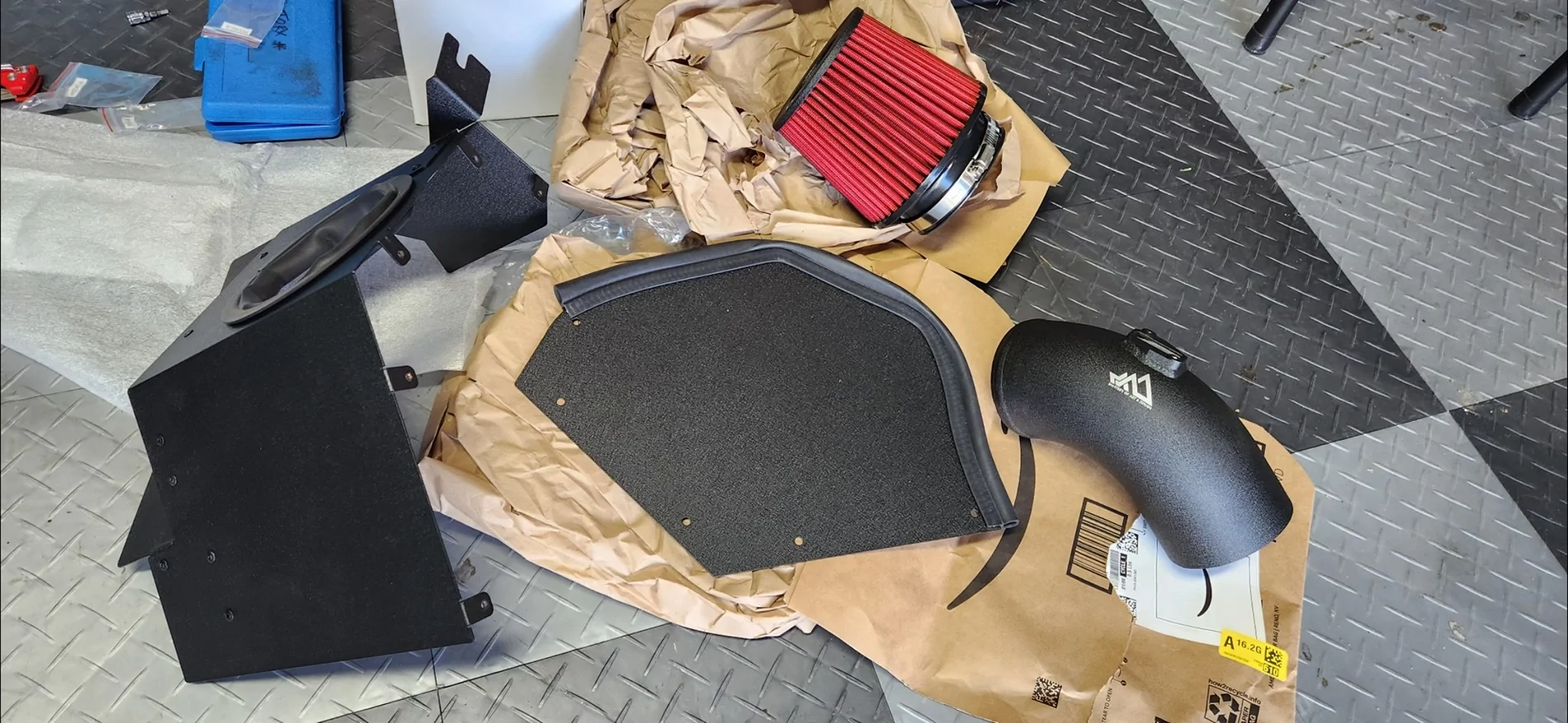

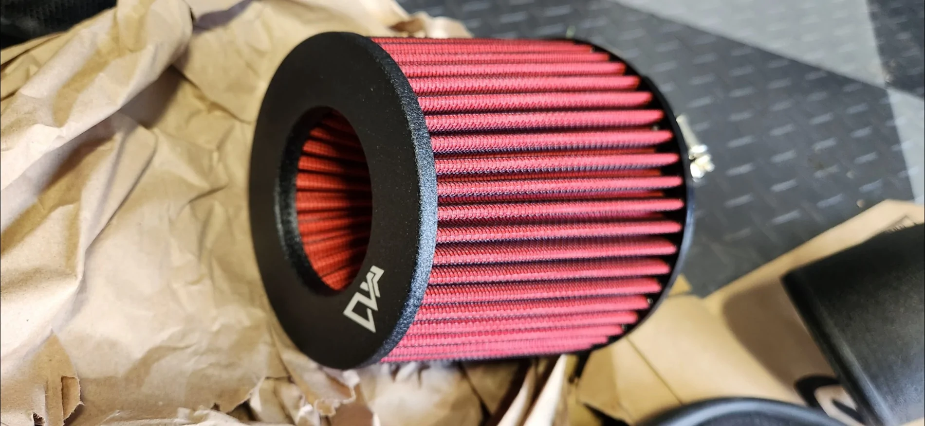

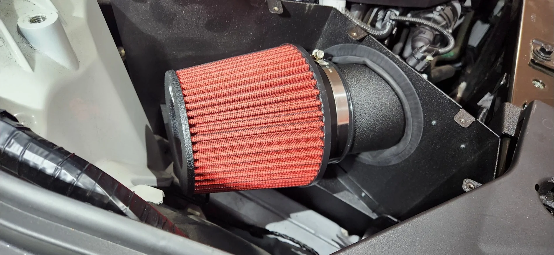

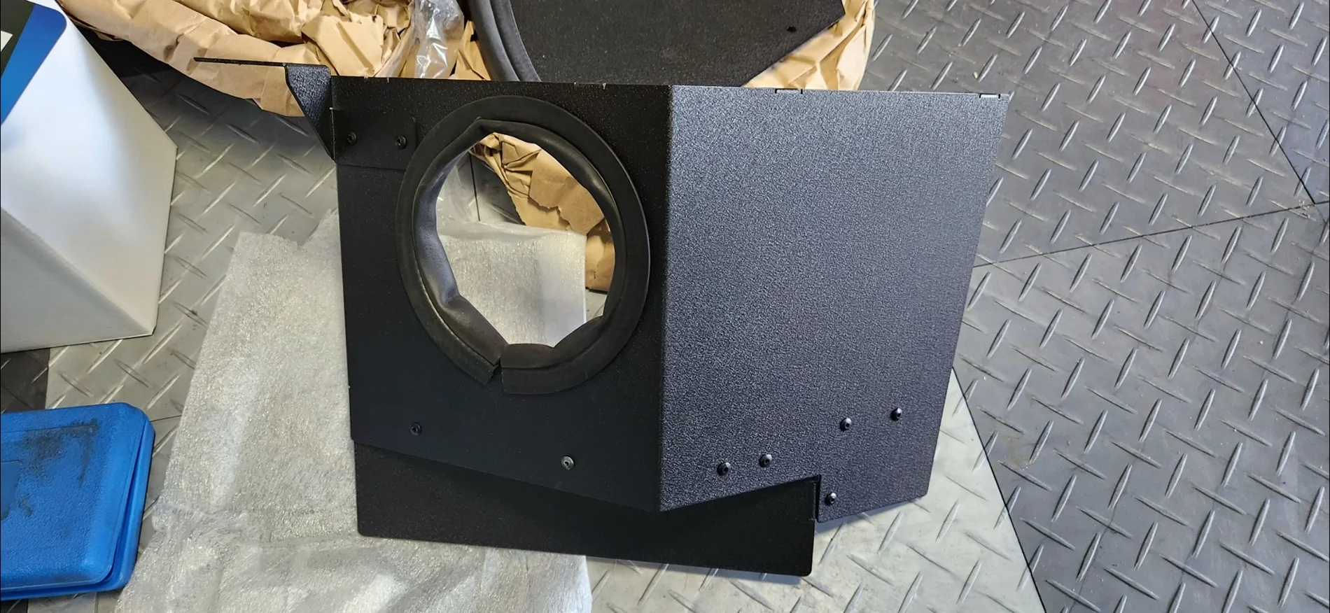

Well packaged with all the screws, clips, and fasteners needed. Zero instructions though. Finish looked good though intake tube had a tiny blemish. From what I can tell, the intake tube and heat shield are identical to MST, but the MAD filter appears to be slightly smaller than MST.

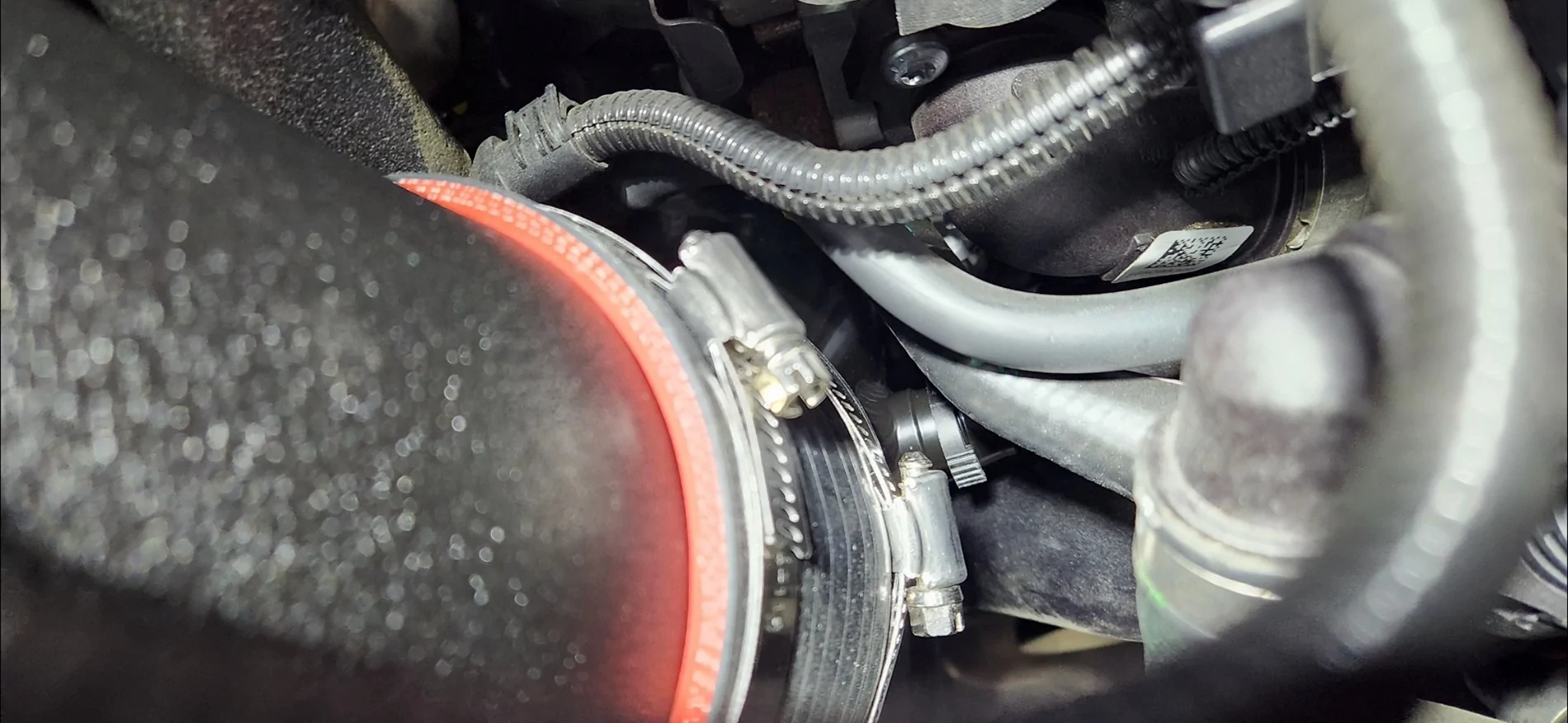

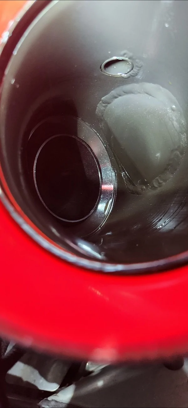

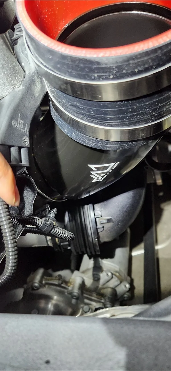

The inlet is enitrely different though. MST inlet is made of silicone, but the MAD inlet is all aluminum and looks identical to the Paradigm inlet (e.g. the way it uses a C clip to attach to the turbo, and the indentation at the bend to make room for charge pipe clearance).

The inlet fit very well and the breather hose had no issues reaching it. There was almost no struggle with this.

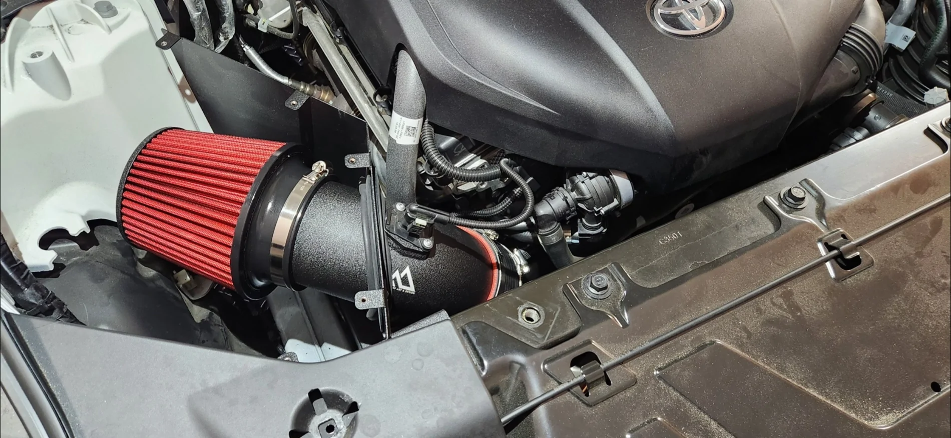

Intake fitment was fine. Just follow the many youtube MST install videos and you'll be set. I did reuse the screws that attach the sensor to the intake tube, though later realize I was supposed to use the screws that came with the intake. This is where INSTRUCTIONS would have been helpful lol. Slight struggle getting everything lined up into the heatsheild but nothing crazy.

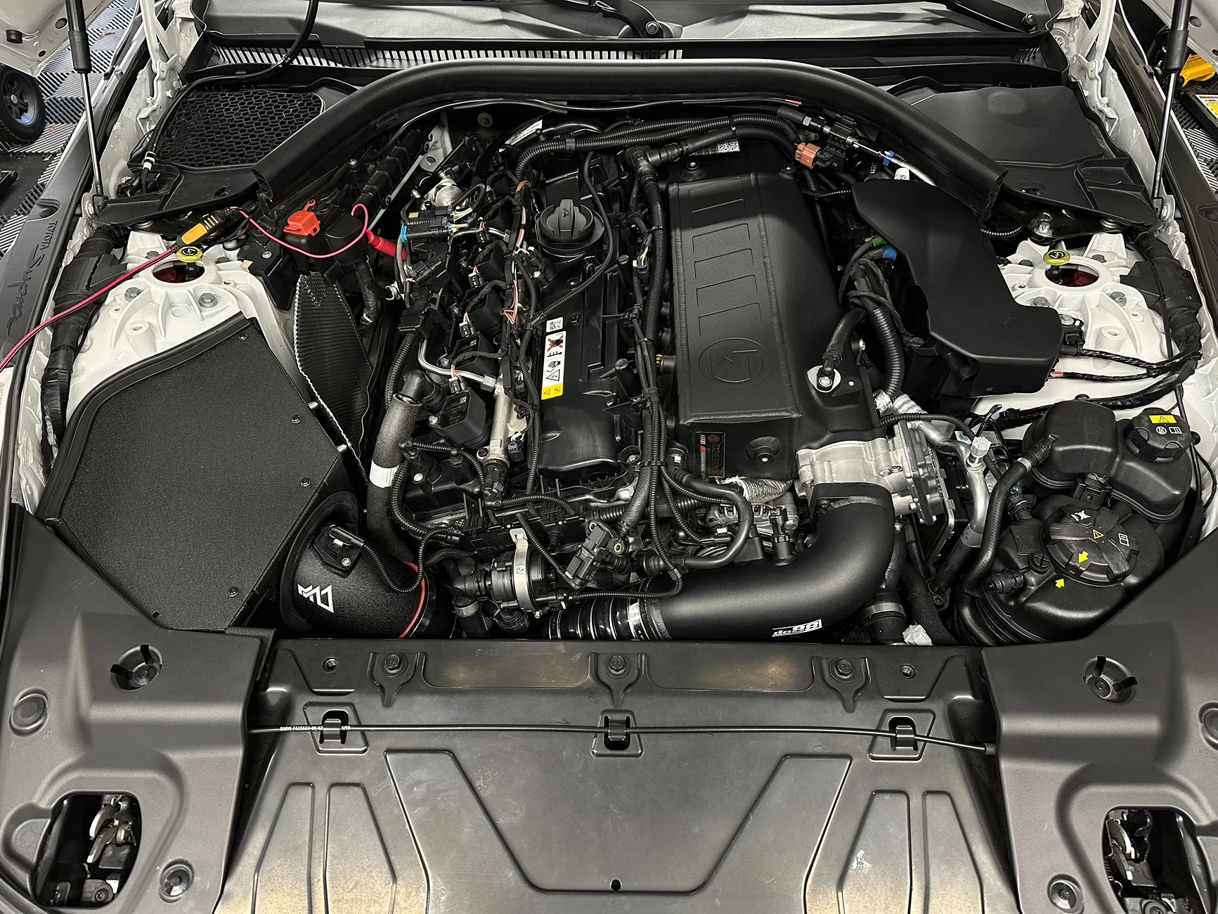

After everything was buttoned up, started then engine. No CEL. Yay! Took her for a ride and can definitely hear the turbo. Slightly disappointed because all the youtube videos show downright orgasmic reactions. It's noticeable but not life changing like some make it out to be. I also noticed some reviewers put the microphone in the engine bay thereby exaggerating the sounds even more. Granted, I already have an AA catted DP and an HKS exhaust installed, so maybe I was unfairly expecting the intake to be louder. It is not.

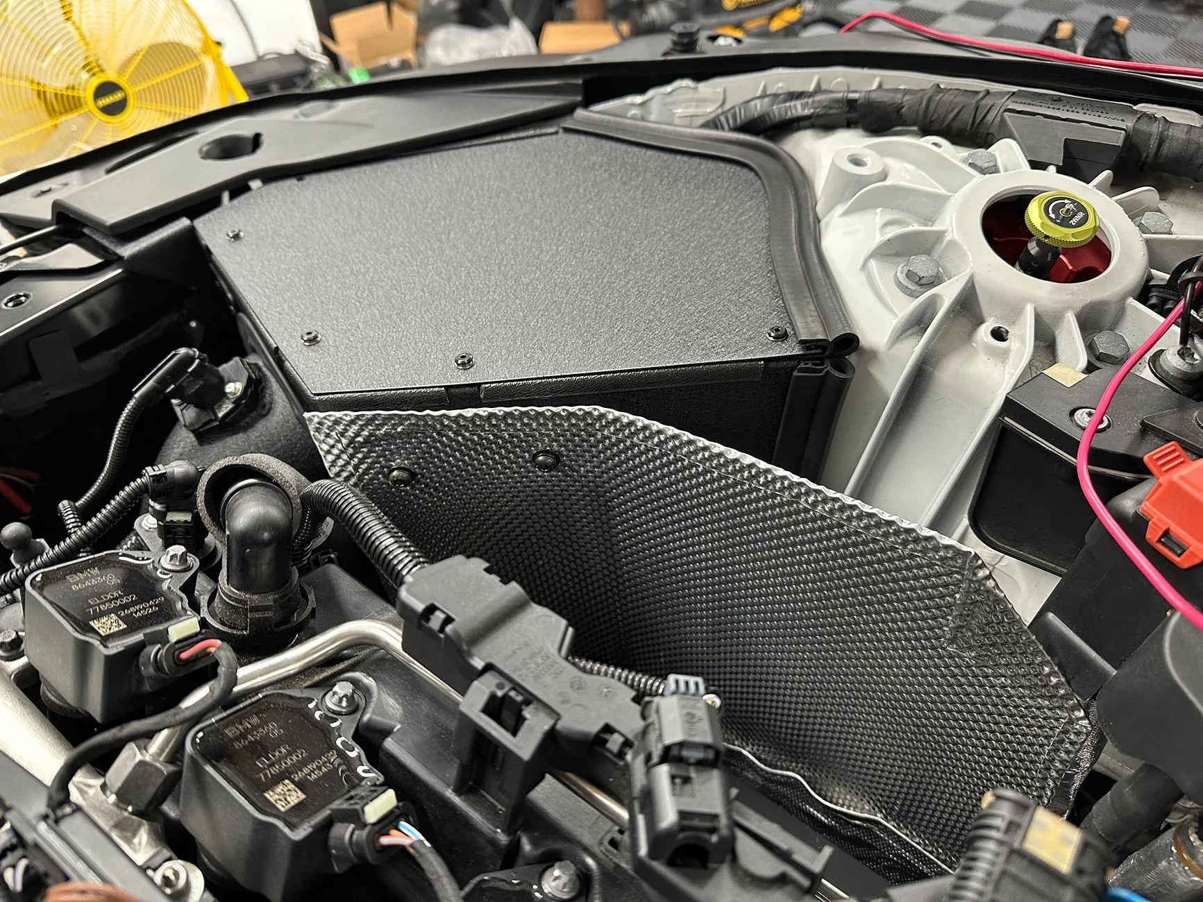

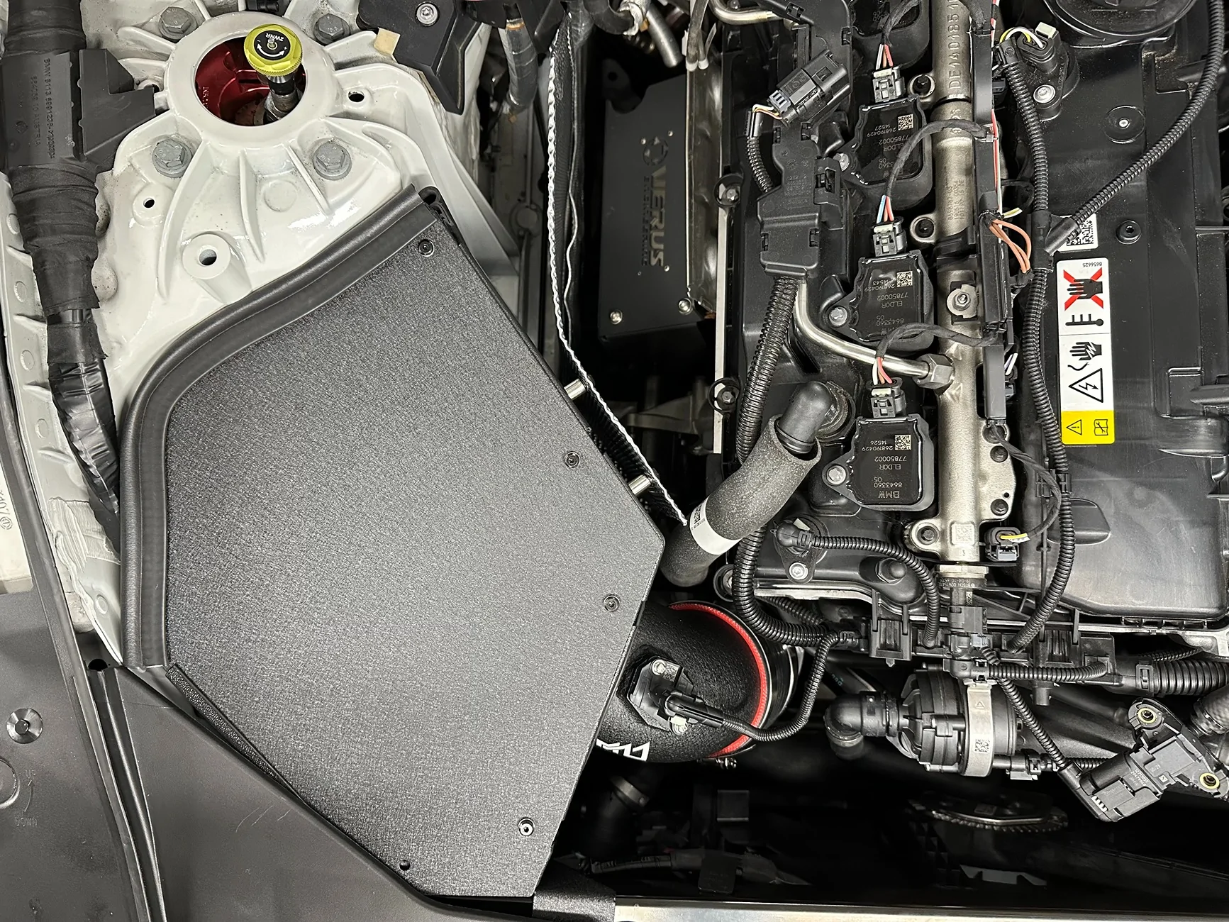

I have not tested any IATs which is what turned me away from intakes for so long. I already have the Verus heat shield ordered though. I also don't track or race the car so heatsoaking risk should be minimal.

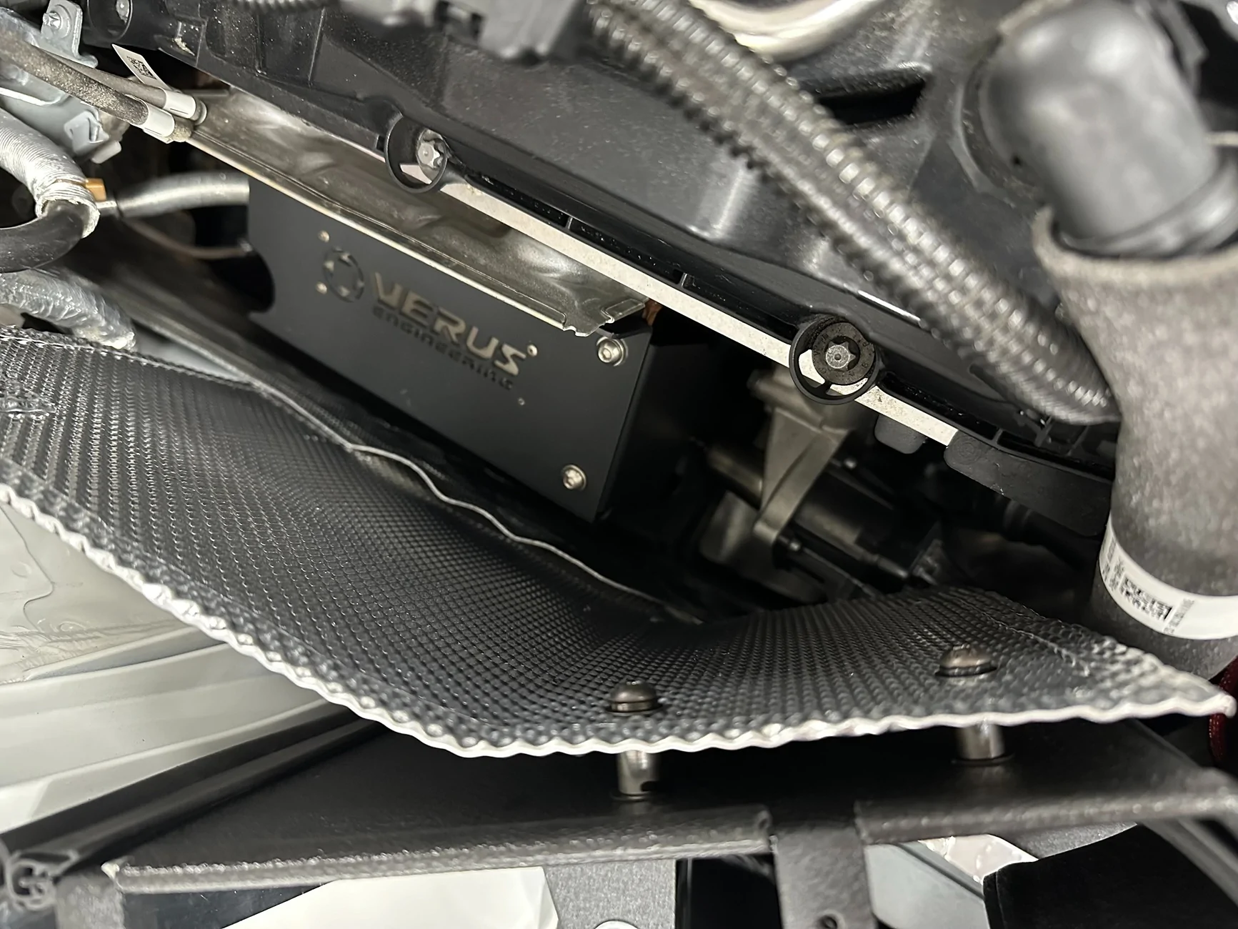

You can add an additional heat shield pretty easily. I did to mine with the some cheap Amazon aluminum shielding, dowels and some bolts:
