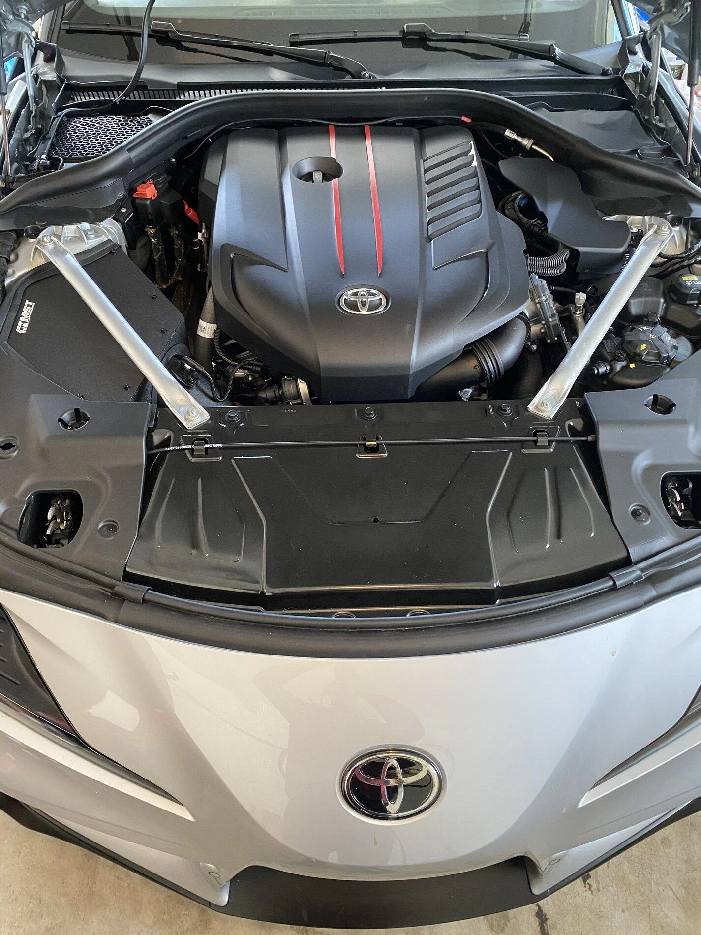

I have the mst intake and it’s super loud too , but also think your setup has a better overall top sealing and fitment . Is your car a 20 or 21 I noticed the 21’s wiring look like it sits higher then the 20’s causing the mst box not to sit as flush on the 21 vs the 20

That fitment though. I've never heard of this brand but I love the design of that box.

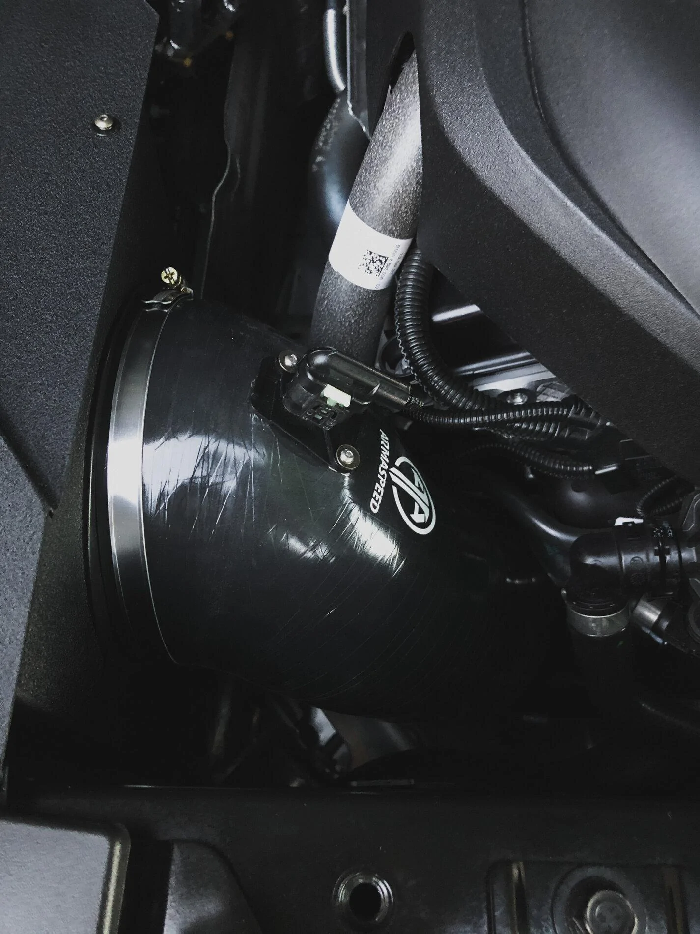

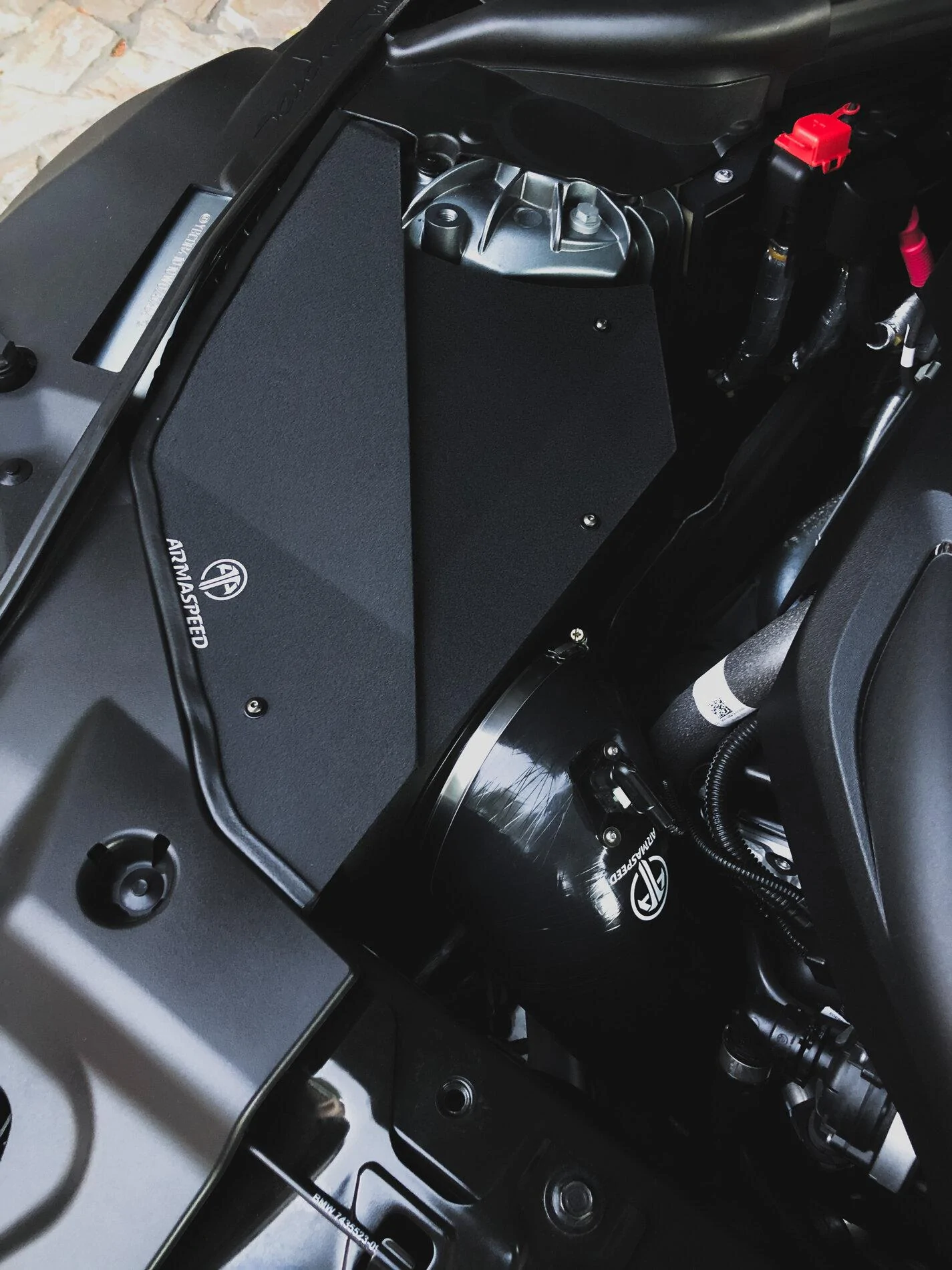

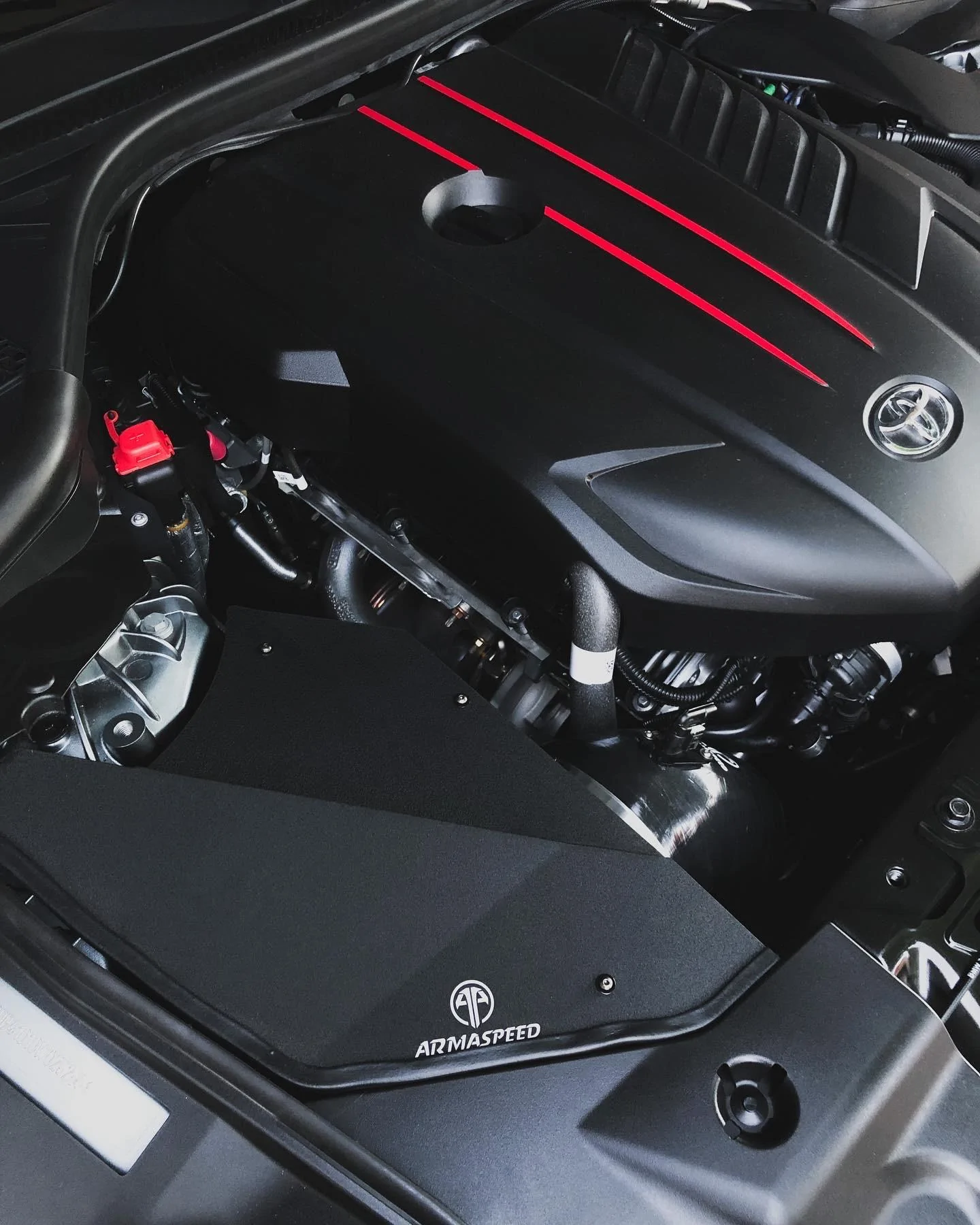

Hey everyone! So I recently installed the Arma Speed Alloy Type intake system and I wanted to make a review to give my honest thoughts and opinion on it.
In selecting an intake system I had a couple requirements. I wanted something that made a loud induction noise, so a fully enclosed box wasn't really an option. More importantly I wanted a system that replaced the complete intake pipe instead of just the top part. Finally, I'm not a fan of carbon in the engine bay so I was looking for something made of other materials.
To begin, the quality of construction and fitment of the intake is perfect, I couldn't be any happier. This particular model Arma Speed offers has the silicone inlet which is massive! In fact it's probably the largest intake pipe I've ever seen. The heat shield around the intake also creates a very tight seal minimizing the possibility of heat soak. An additional heat shield around the turbo could be added for summer track days, but. haven't noticed any problems on the streets.
The sound this thing makes is actually insane! The induction noise got amplified significantly and it's very noticeable from the low end all the way till redline. When letting off the throttle it also makes a loud turbo flutter sound and my favorite part is the turbo whistle that comes from the exhaust on deceleration. I believe this might be the loudest intake available for this car currently.
I haven't dyno tested the car before and after so I'm not going to hit you guys with the typical "it feels faster" line, but I've spoken to a third party shop who claimed 20whp gain on a stage 2 car without making any software changes. I'll try to find their dyno graph and post it in the comments section.
Overall, I'm very impressed with this intake system and I couldn't recommend it enough to anyone looking for something similar. If you are looking for maximum sound, this is the one to go with!
Mine is a 2020. But to confirm I do have the 2021 strut braces and it fits perfectly.
