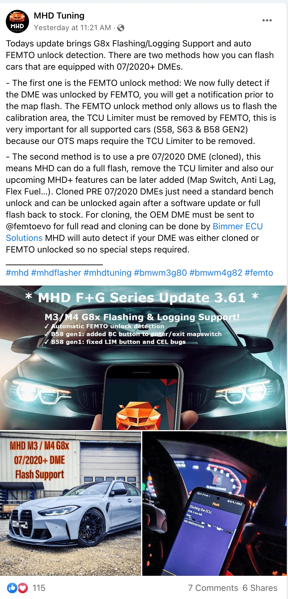

But there is no map switching, anti-lag, flex-fuel at all for the Femto Unlock only.. so why mention it here? There's some deets here if you're not sure.
I messaged them on instagram and they said they’re porting their changes to latest software and will have all that updated soon so when Femto does unlock they’ll provide their software to them and customer gets all that preloaded.

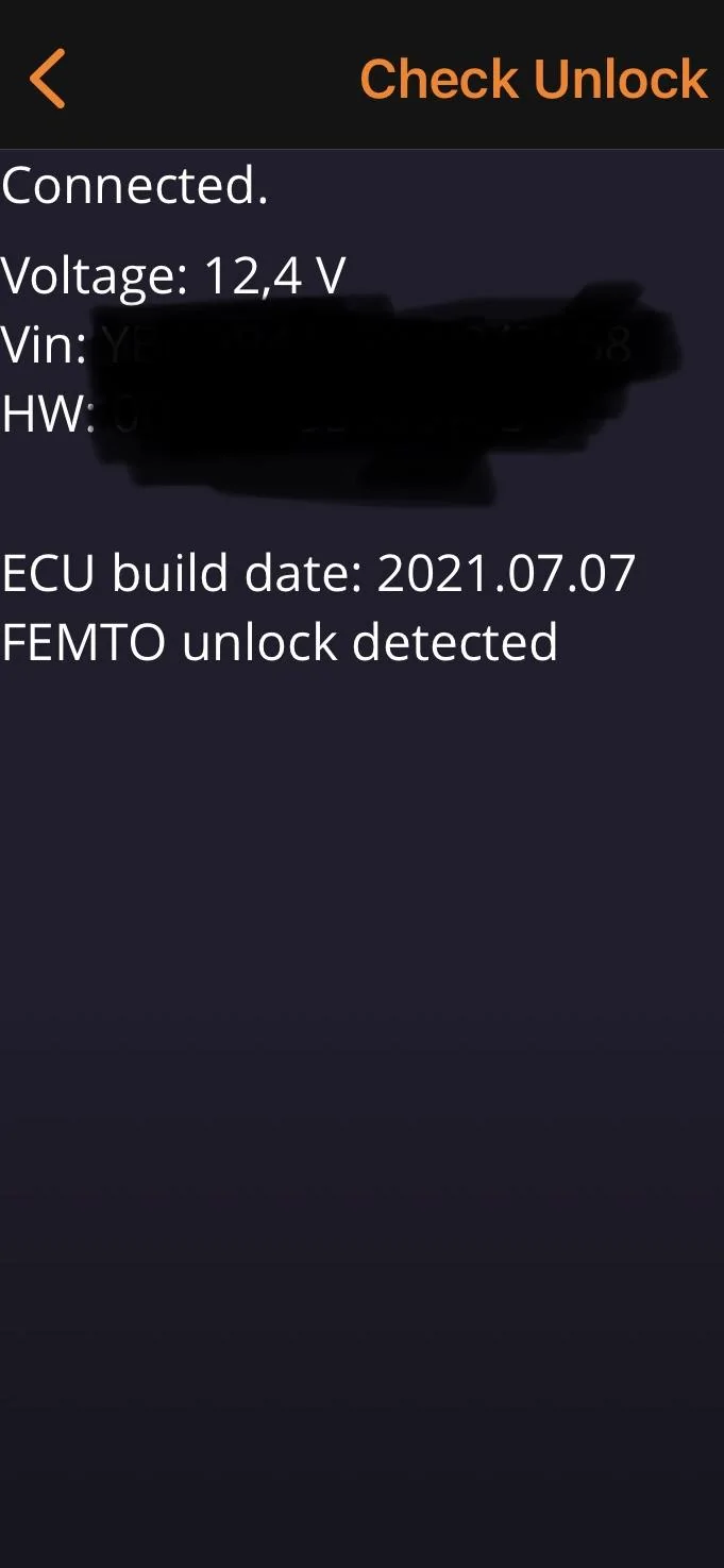

I think i have a bug with mhd, my mhd detect a femto unlock but my supra is stock and never send my ecu in russia, strange
Please send bug report to mhd along with your car's VIN.
We would like to know your car's VIN as well (send it via PM).
Could you please try to test same thing using mgflasher app?
Thank you.
this is a known bug specific to FEMTO unlock support. Right now its blanket "recognizing" ECUs as having the FEMTO unlock. Fix will pushed in a coming update. so for now if you know you didnt get the FEMTO unlock done, carry on as such.
