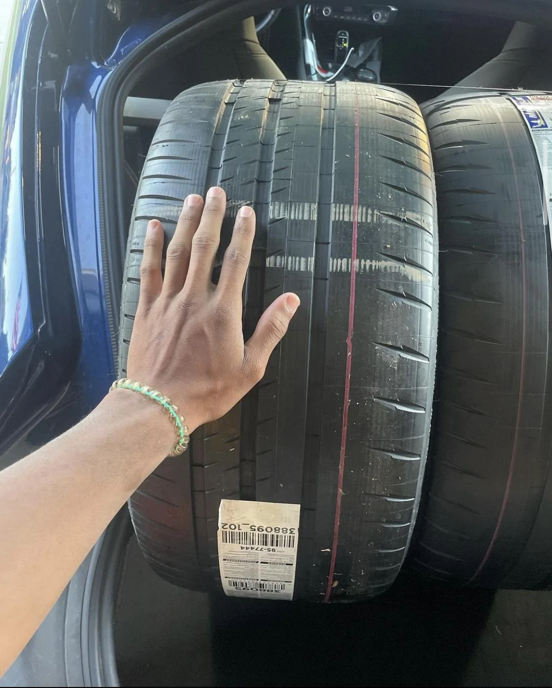

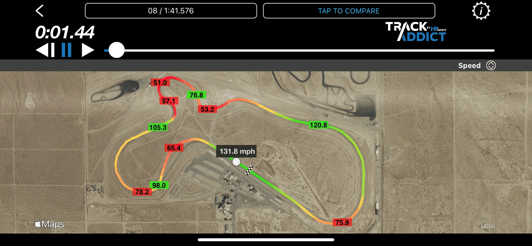

Li
I've used cup 2's on previous car and must say that are superb tyres.
Is anyone running cup 2's on their supra and can comment?
Tia.
A little late to the thread, but just switched new cup 2's after I wore the factory tread off of my ss. Ive got to say the dry handling compared to the ss is amazing. I live in SoCal so getting my tires warm is not that much of an issue. The ride is a fair bit firmer and louder, but the trade off is amazing grip off the line wheelspin is almost non exsistent. only had the chance to take to willow springs once, but lap time decreased about a second and some change. Only negative is tread depth being 7/32 from the factory lol.
