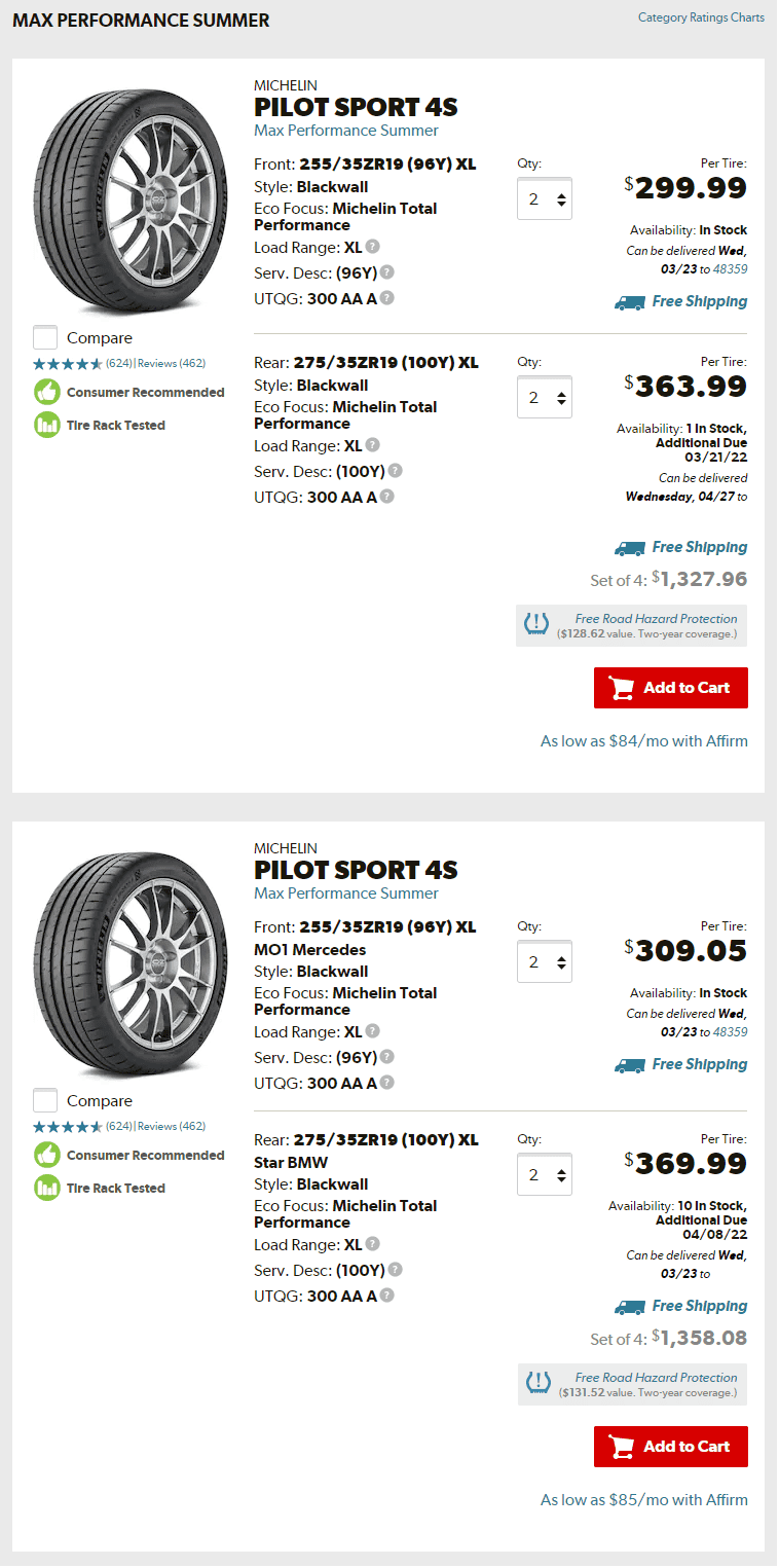

Tire rack offer two options in stock sizes for the 4s. Standard blackwall, and then a combination of Star BMW spec (rear 275/35ZR19) AND M01 Mercedes spec (front 255/35ZR19). Star BMW spec is not offered for the fronts.

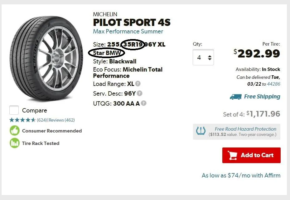

To add to the confusion, if I search by tire size I CAN find the front 255/35R19 in Star BMW spec. The only difference is there is no "Z" on it. My understanding is the Z means nothing now b/c the speed rating of the tire is Y, which is higher than Z.

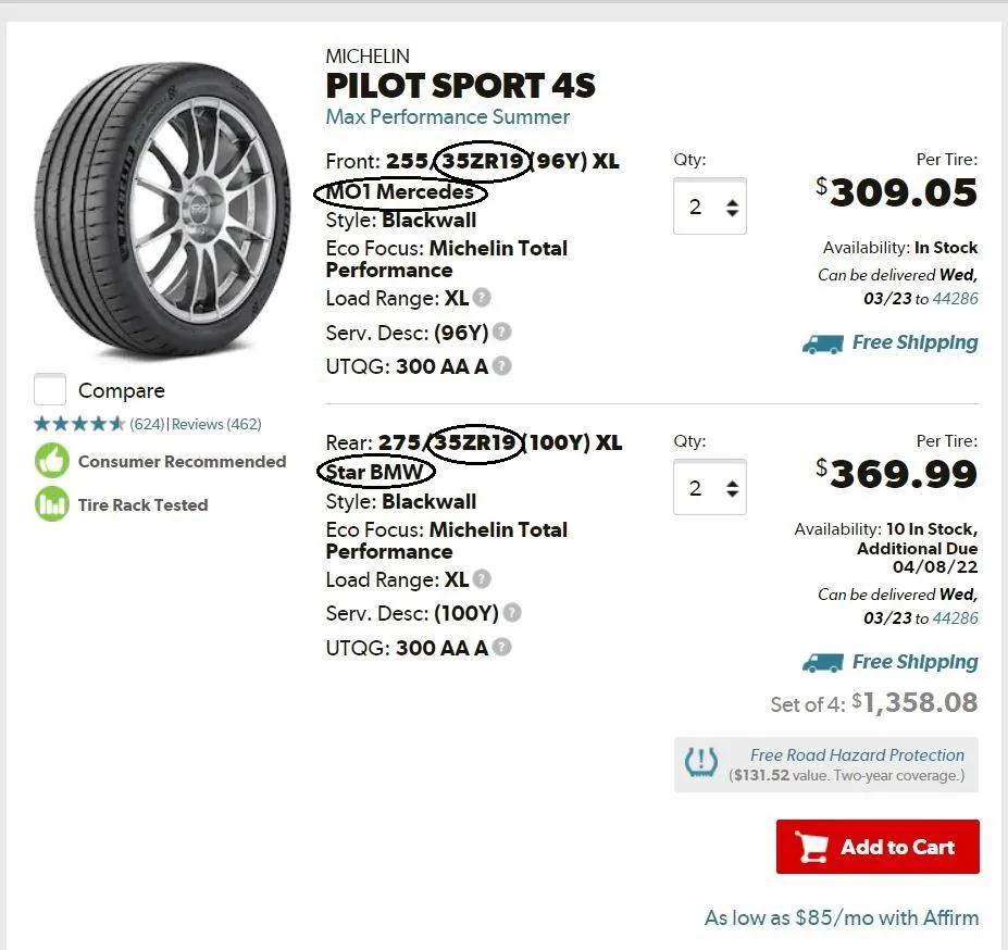

EDITED the pictures to show the differences with circles around them. First picture is the combo front/rear that comes up when you search by car. The second picture is when I searched by tire size and found the bmw star spec in the front size...

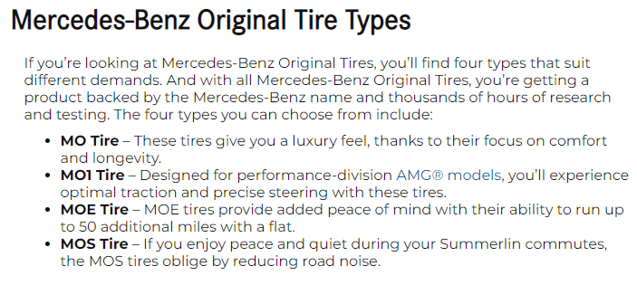

Mercedes one is manufactured for a specific Mercedes vehicle per Mercedes specs for that vehicle, hence the logo. They're offering it for any car.
BMW one, again is manufactured for a specific BMW vehicle other than a Supra!
You cannot know the differences. They can be different, or they can simply be the same exact spec, but different logos as OEMs request it.. I'd venture that they're the same exact tire.
Pricing difference can be attributed to many things. Inventory, sales figures, etc..
Z - depends on what tire global spec they're using. ETRTO, TRA, etc.. It's as you put it means not much as speed/load rating is specified already.
Don't let the below screenshot fool you. Could be for a 10,000lb AMG model. So, can be designed for a different car or SUV...
ow and if you put your vehicle in tirerack, it gives you front/rear options like my below screenshot, unless you're changing OE size..

pure speculation: Michelin FR company. FR made could be better :D. AMG tire and perhaps M-tire. Probably is the case..
Or could simply be designed mostly for EU customers, hence selection for close-by facility..
damn. it's difficult. voids are larger on BMW spec vs generic so are the grooves. more likely NVH/dampening and bit improved wet traction..
Also to consider: front/rear both generic or front Mercedes, rear BMW spec..... couldn't find Mercedes picture.. dunno..

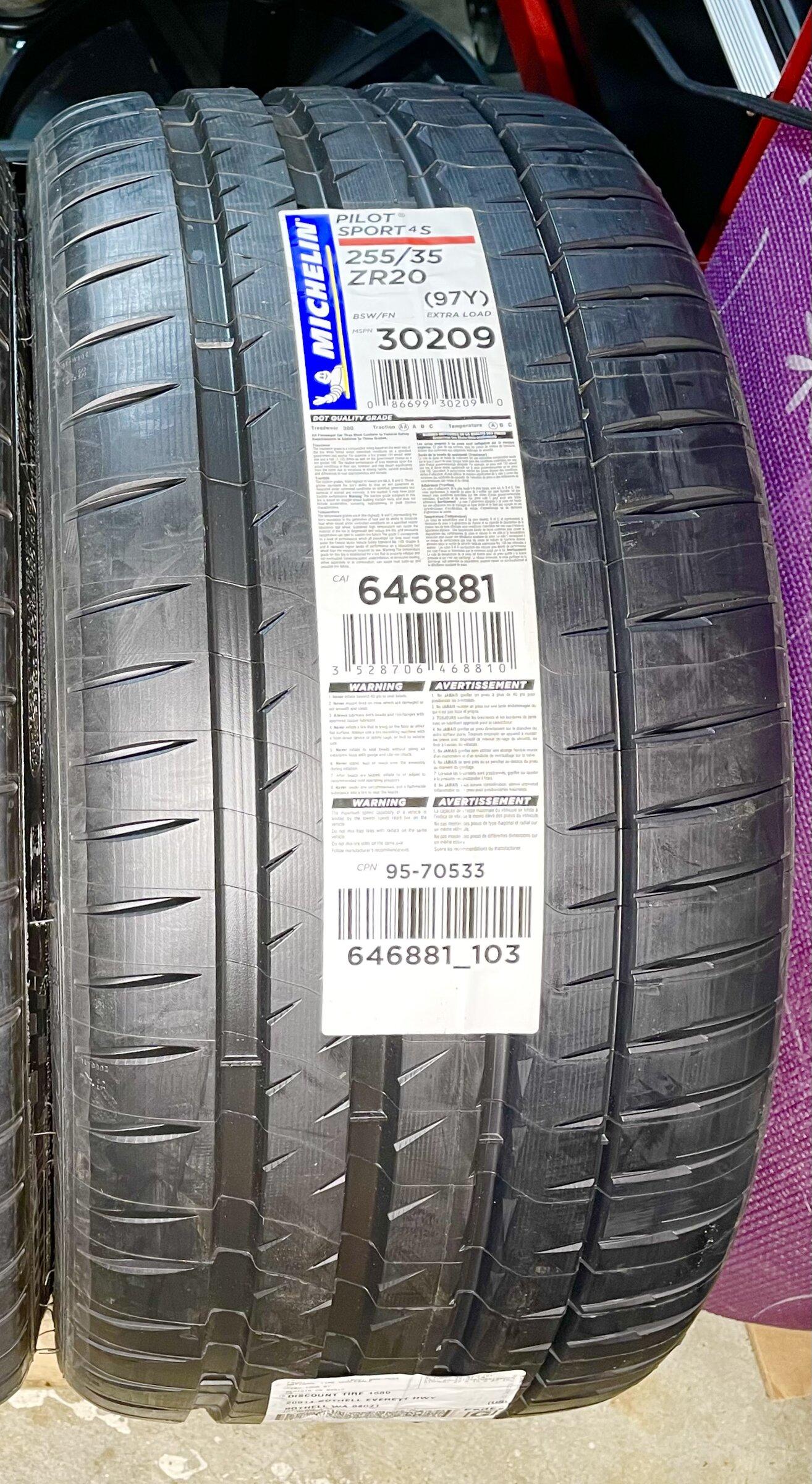

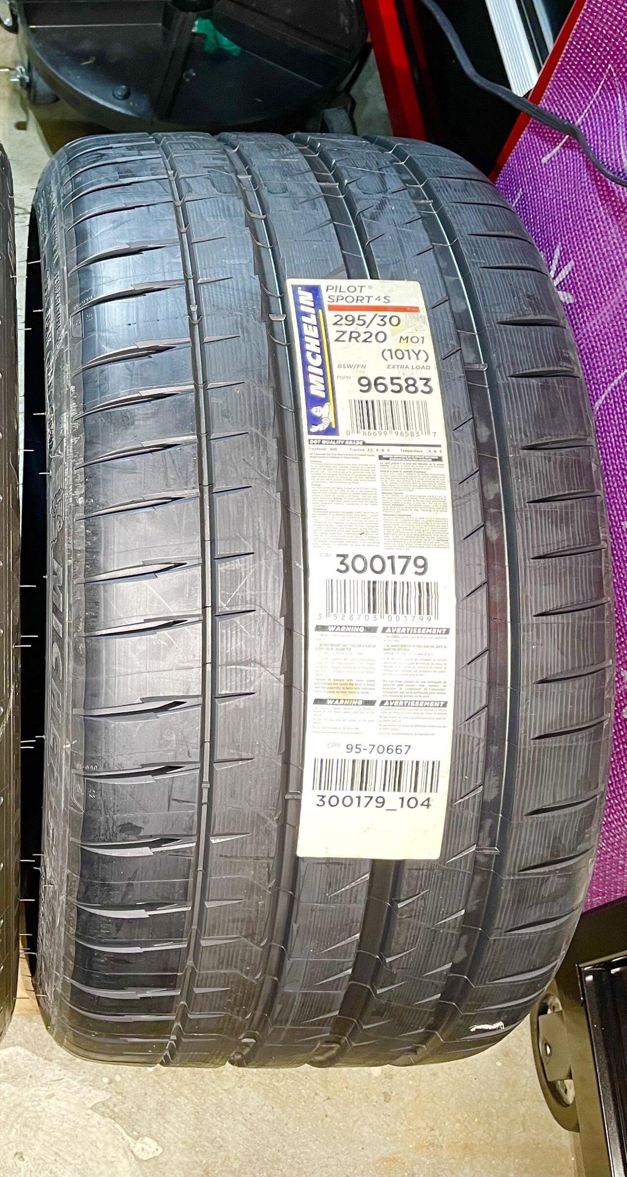

I went with standard up front and MO1 spec. for the rear. I wanted the maximum traction offered in the back. Here are some reference pics for the tread pattern, hope it helps.

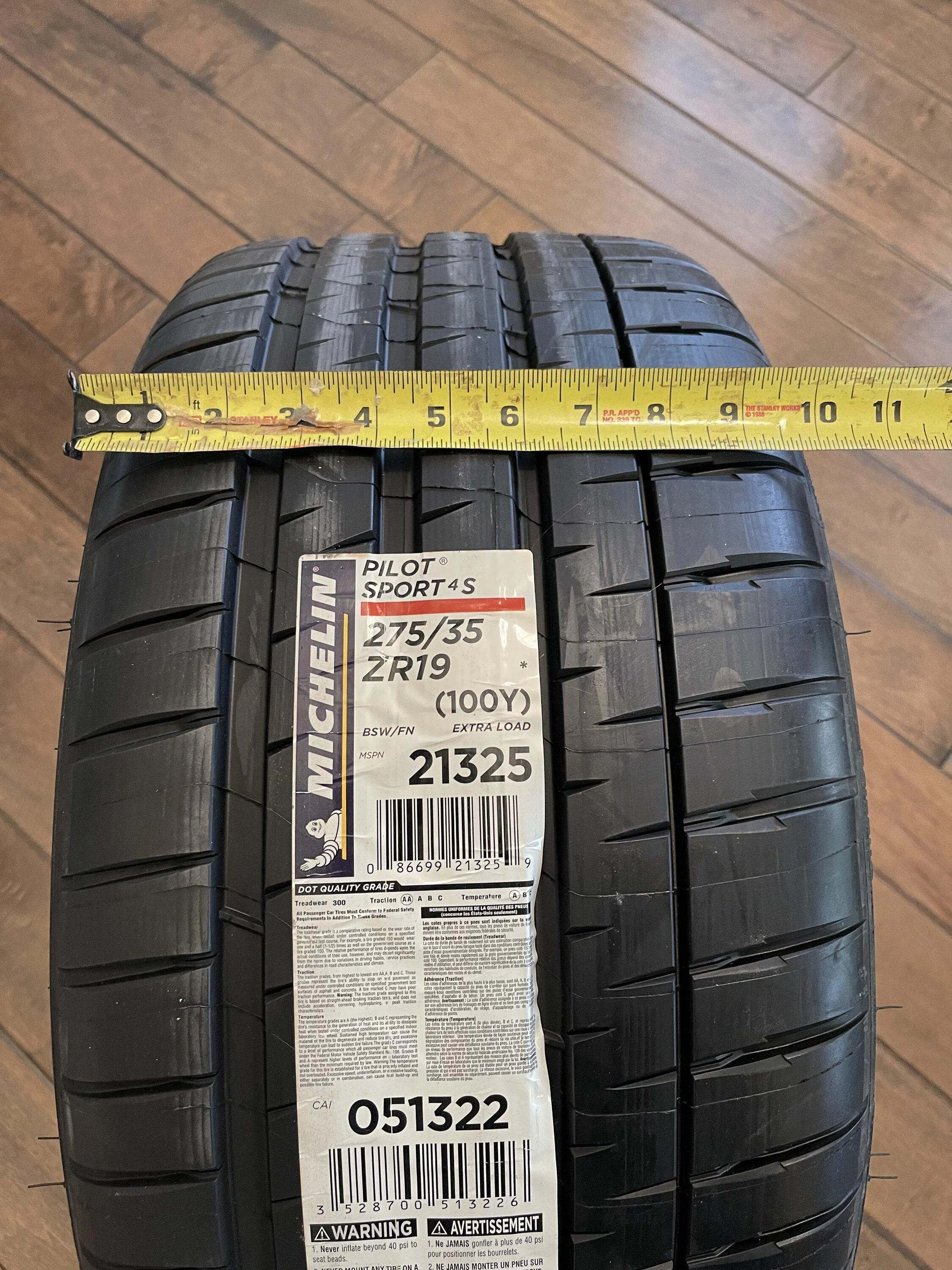

In case someone is still interested, just had my BMW spec PS 4S’s delivered (275/35/R19) and can confirm the tread is 9.8” (or damn close).
