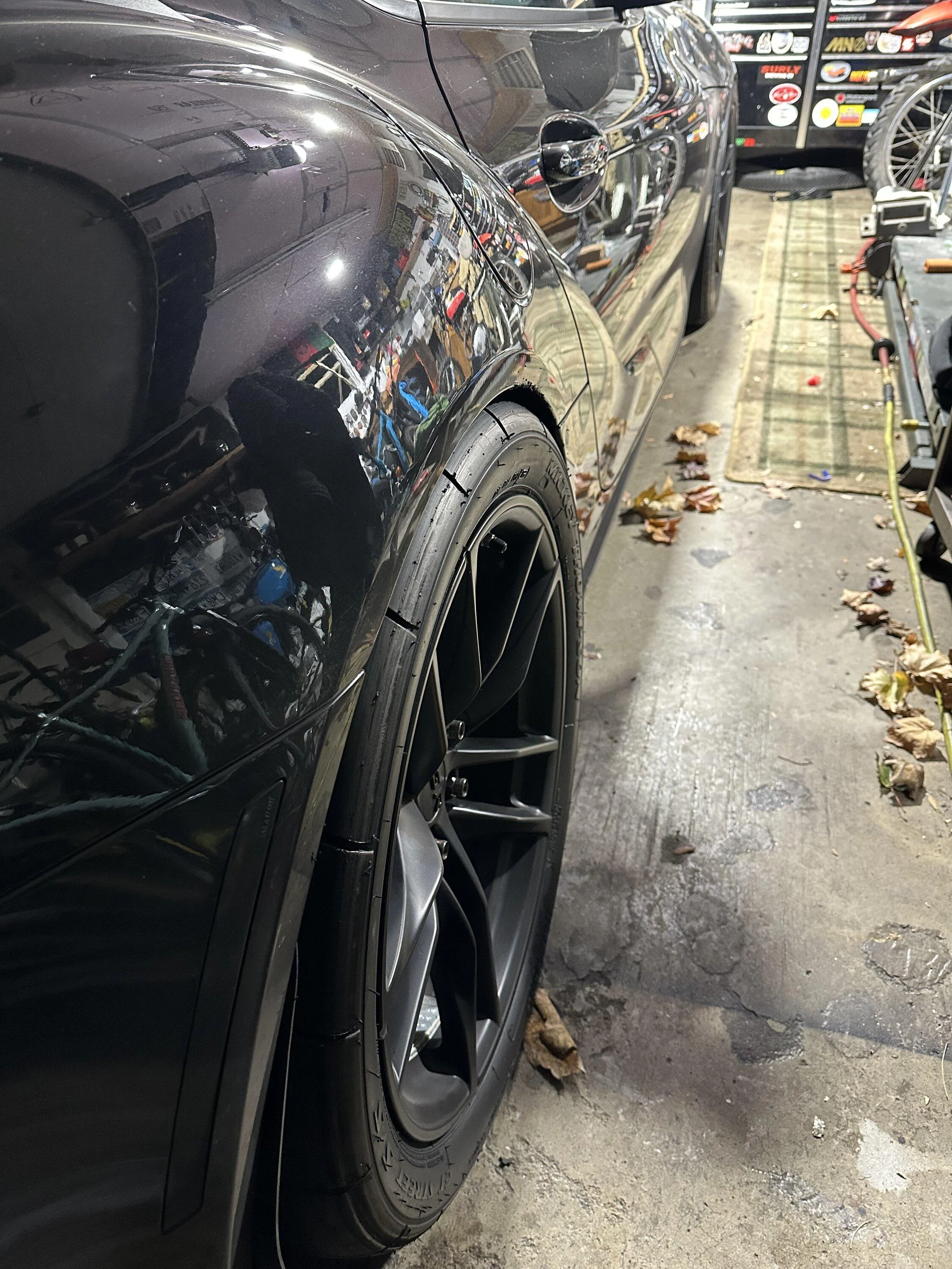

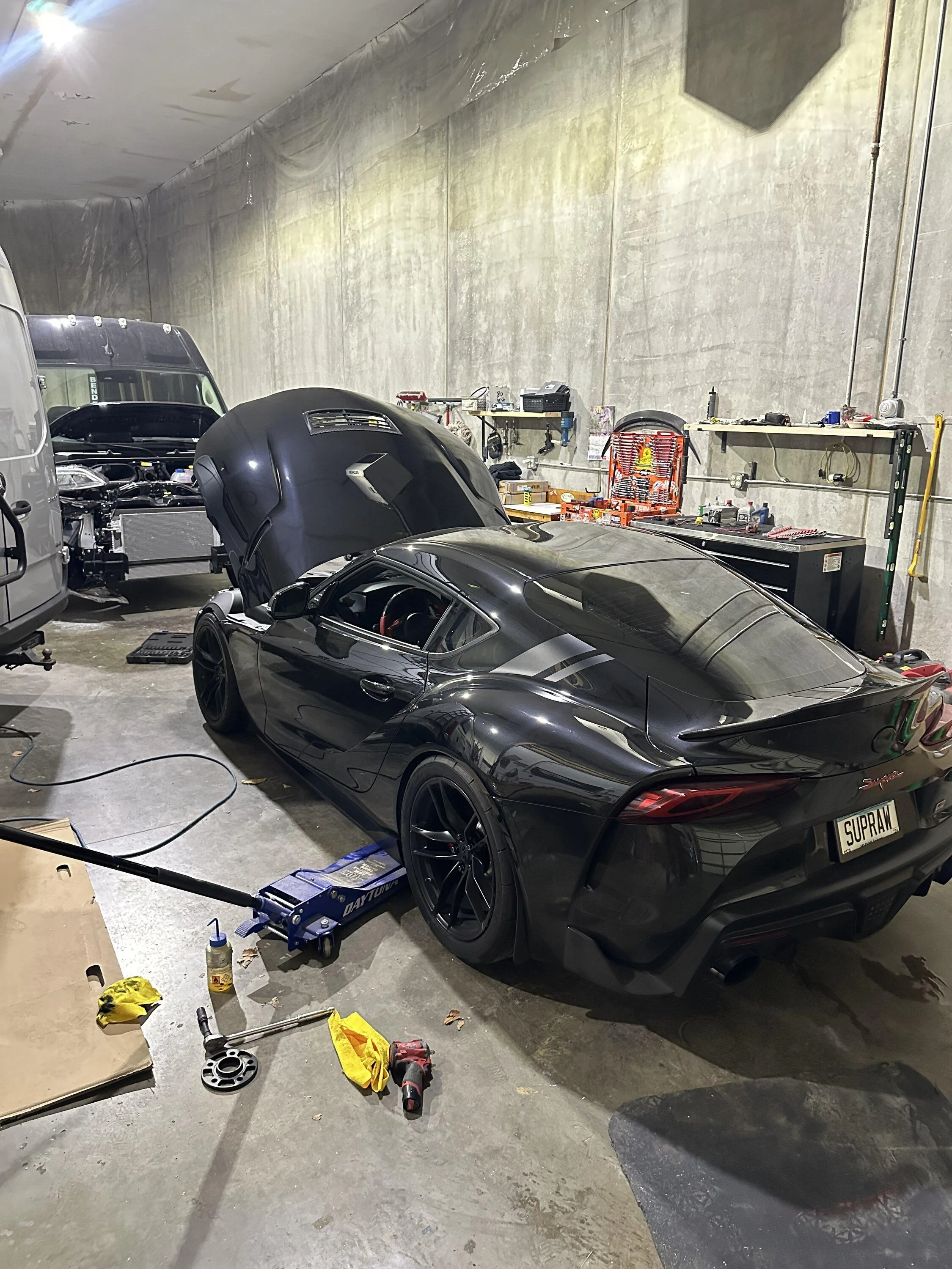

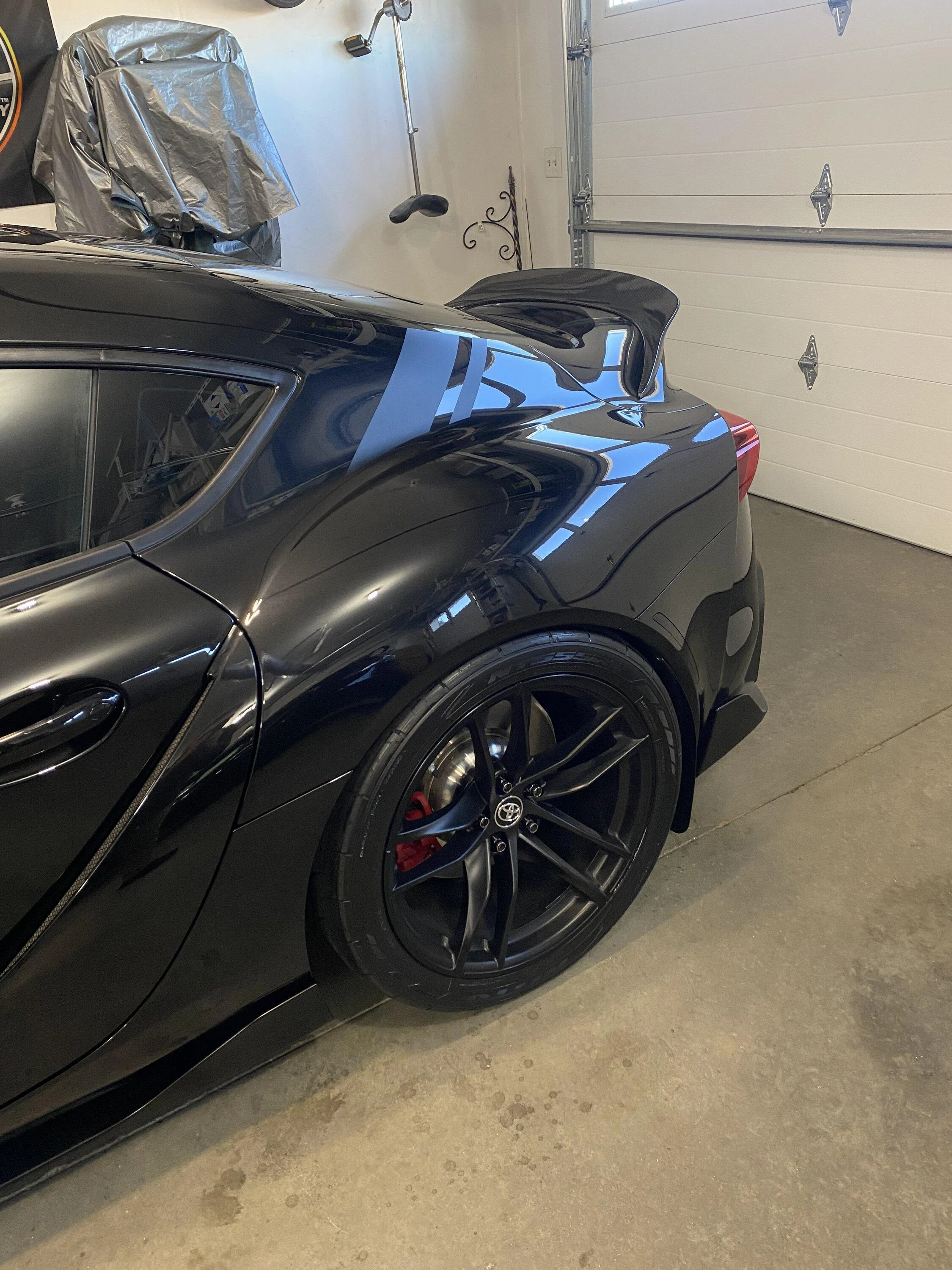

Nitto 555r2, 285-35-19:

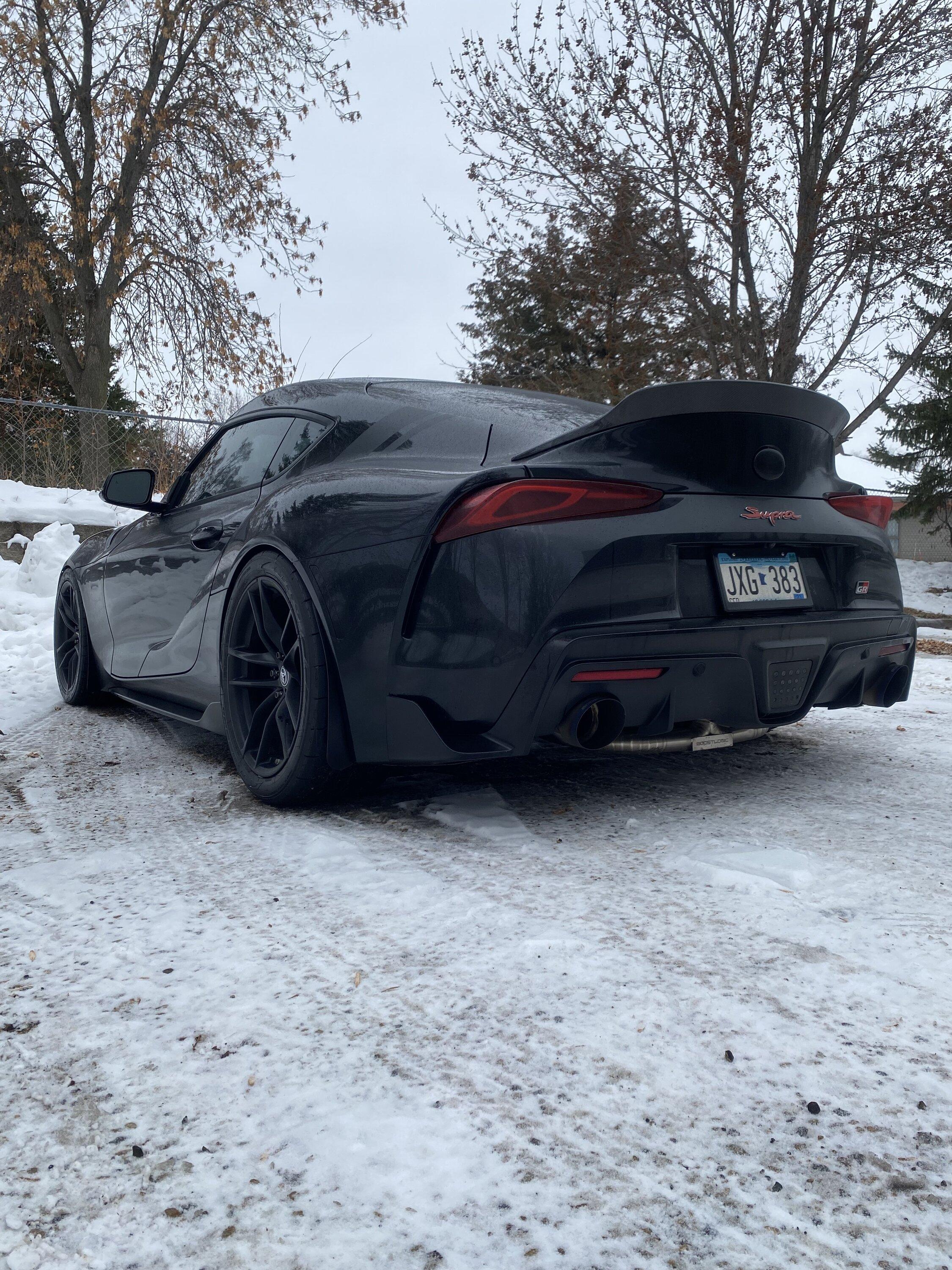

With eibachs and 20mm spacer fitment was *perfect* (see first 3 pics). Some initial rubbing until the tire burned through a small portion of the fender well liner. It’s up inside the fender where you’ll never see it and I couldn’t care less. Took about 500 miles to quit rubbing on big bumps but once the material burned off I never had another rubbing issue. Much grippier than stock, but I was never blown away by the grip, even after a burnout, but again, my experience with them is street use only. I had them at 30psi for commuting and ~18psi on weekends for cruising/roll racing. They lasted ~8,000 miles with a decent amount of rolling burnouts and donuts on them. They felt great on the highway and were no louder than stock tires. They cornered well and I was always confident on them, I never felt like I was on a drag radial. Once tread was about half I hydroplaned on any amount of standing water and they were not safe to drive in the rain (expected).

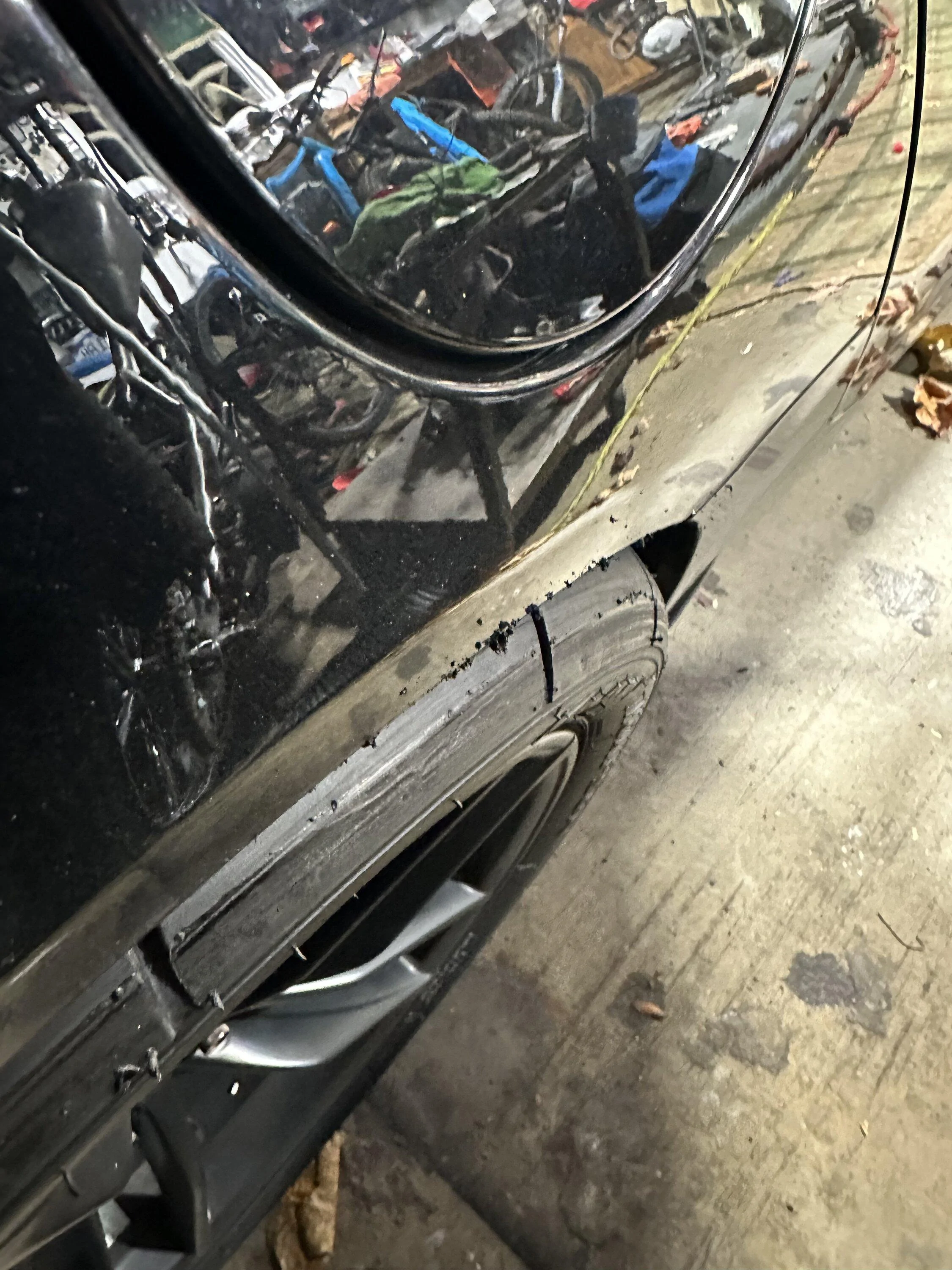

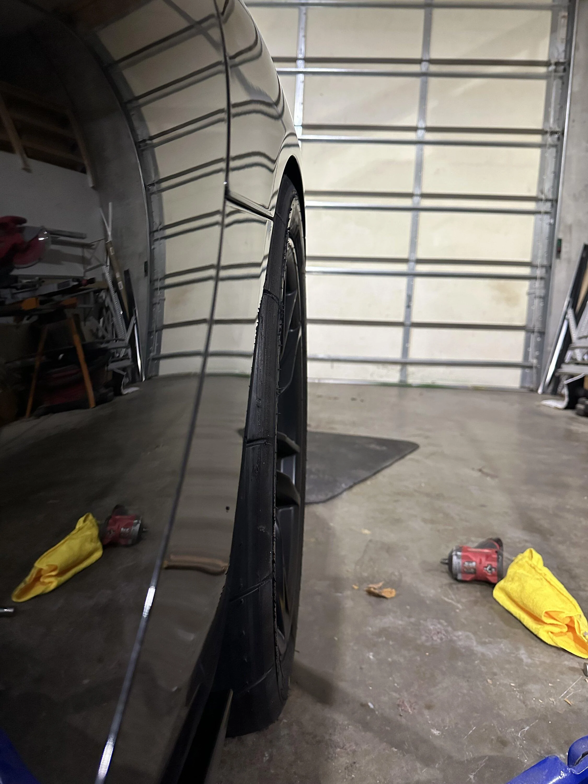

Mickey Thompson ET Street SS, 285-35-19:

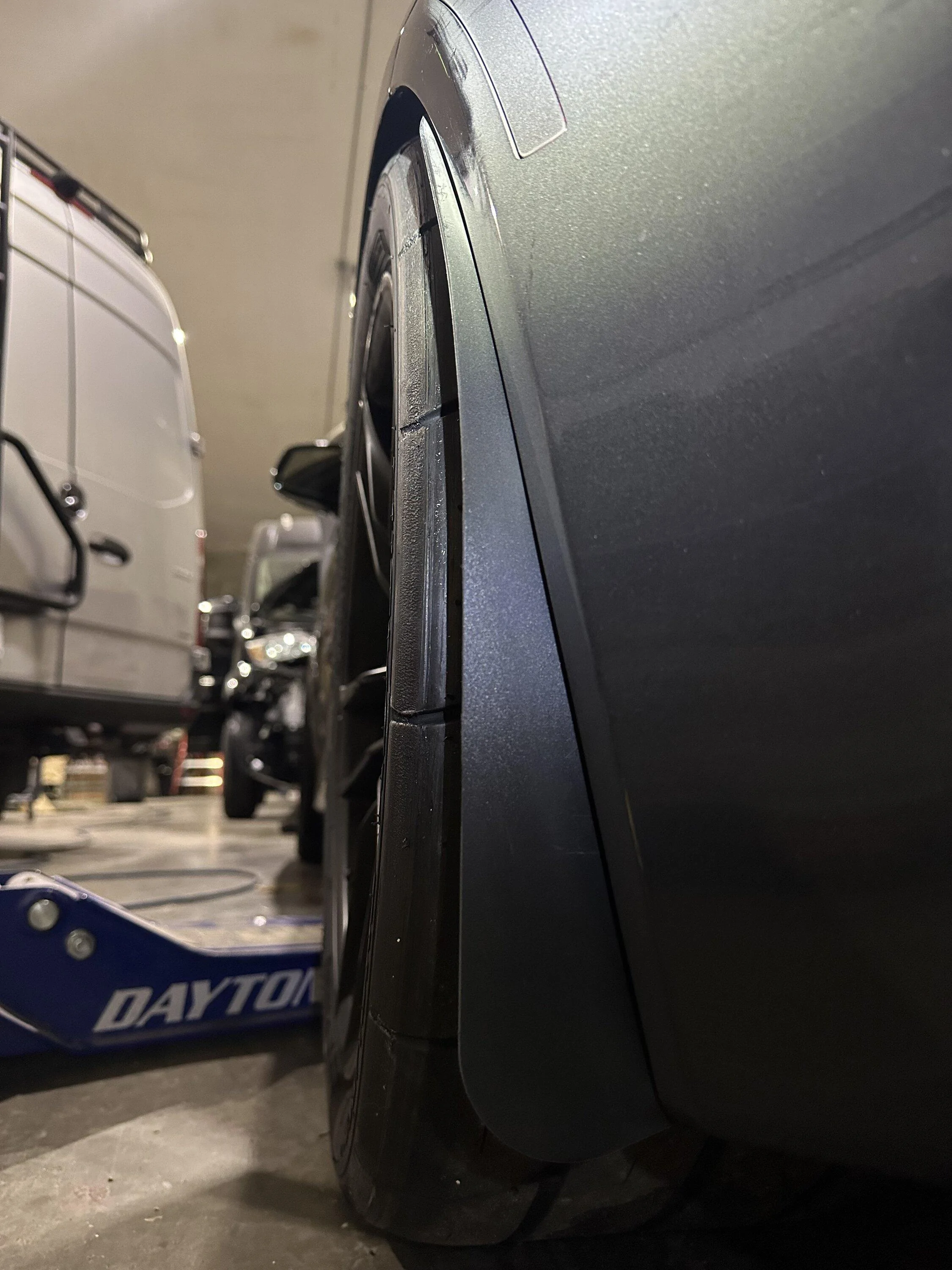

First thing I noticed after having mounted is that the sidewall bulges out beyond the lip of the wheel, whereas the Nitto sidewall ran flush with the wheel face. I removed the 20mm spacer and installed an 18mm which is all I had on hand. The wheel face sits just inside the fender but the sidewall of the tire still protrudes ~10mm (See last 2 pics).They obviously rub but mama didn’t raise no bitch and I’ve got about 1,000 miles on them. I’ve got some 5mm and 10mm spacers coming to fix and tuck, just not thrilled that the wheels will be inset so far-minor gripe though.
