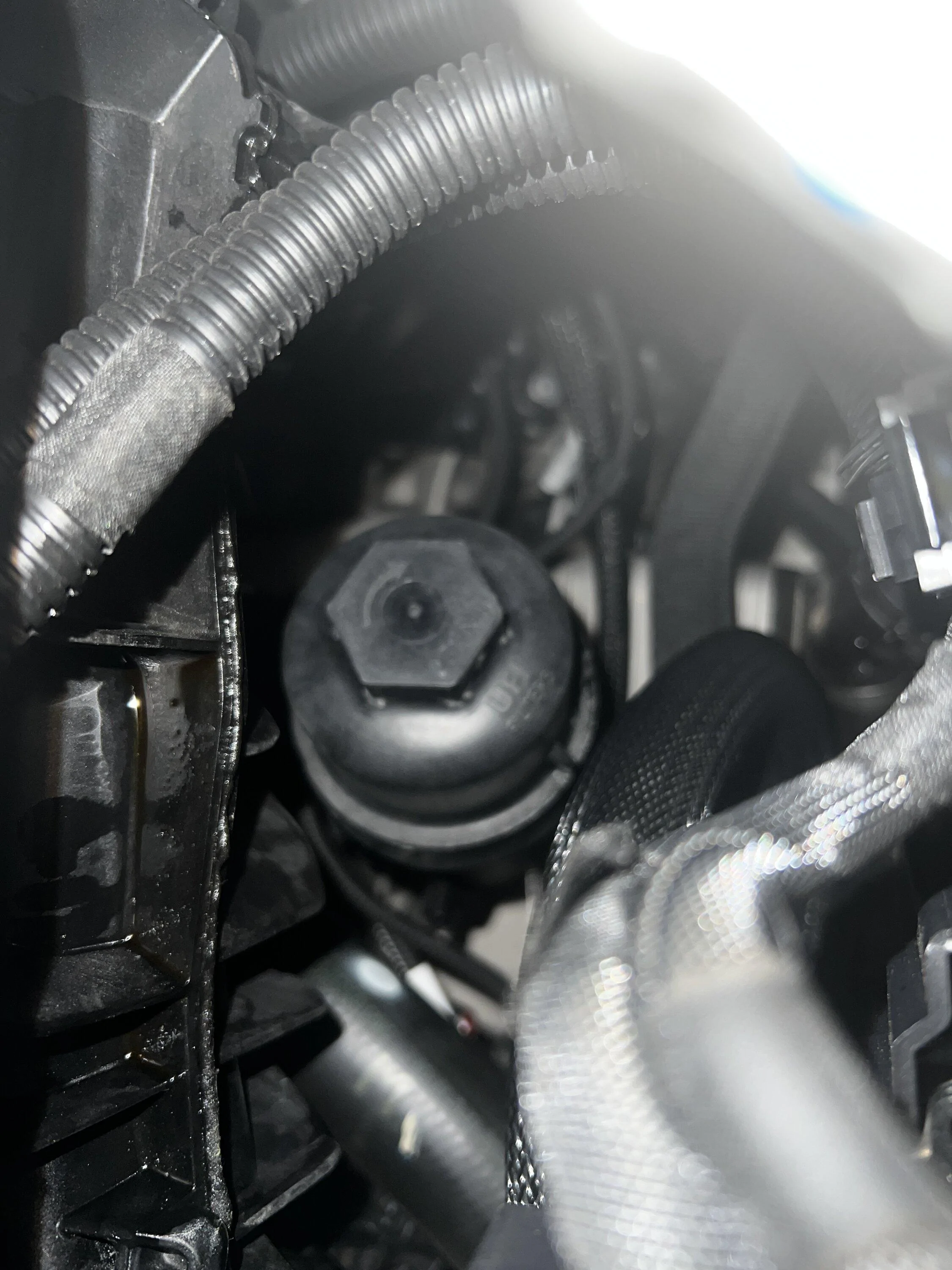

Lol. Same here. Took it in for the recall. Agreed to the free oil change.. guy spilled oil all over the engineā€¦ and as for the sound, they heard it but didnā€™t know if its normal or not and would need a day to figure it out. No thanks!
