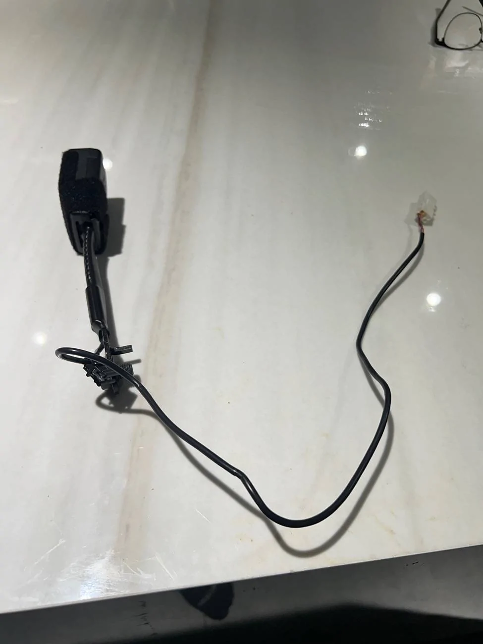

I removed my OEM seats. Installing the buckets. For the driver’s seat I can install the left point of the OEM belt to the sparco base but what about the right side?
The buckle where it clicks on the OEM seat is attached to the OEM seat and has 2 wires.
Do I need a custom buckle?
Can I unbolt the the buckle from OEM… and the wires????
thanks. I searched. Could not find.

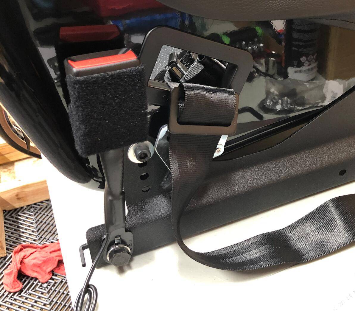

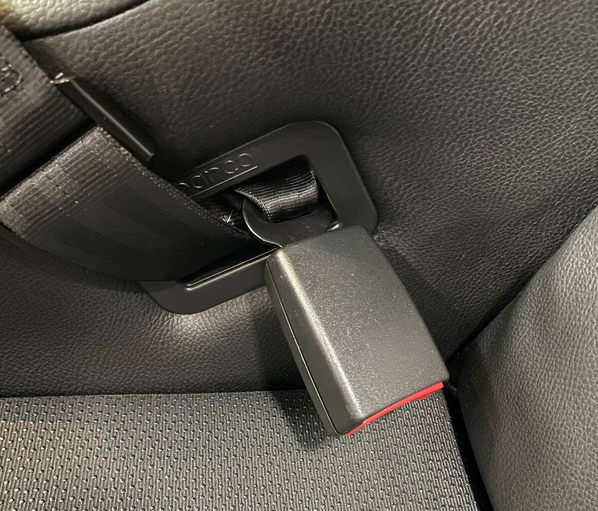

Yes you take it out of the harness... or.. buy one off ebay. All the modern BMW's use the same. I use one off a X3.
Then you plug it back into the yellow harness and use an extension to route it through the seat hole to make it proper safe.
