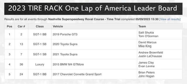

Last video is up - co-driver Clyde running the dry skidpad. We were 1st overall...for about 5 minutes :-D
We got home about 10:30 last night, and I've spent today in a haze of tired, doing low-brainpower tasks. It's a satisfying tired...
The thumbnail for the video is Dave Marcus's Supra. Dave and Mike King managed a 2nd overall finish with a killer 1.18g skidpad performance to lock it down. Dave and Mike were really emotional after the run, as those guys had been killing it all week.

One more thing...at the lunch/awards banquet after the skidpad, I sat down at a table with James Clay (Bimmerworld owner, pro driver), and he asked me some questions about the car, as they had talked to all the Supra teams during the week. He's considering if he wants to start working with the G29 Z4/A90-A91 Supra platform. In my opinion, Bimmerworld one of the best BMW shops because they race with what they sell, and James himself is still actively involved with amateur motorsports...not just his pro gigs.
I've said it on here before...I identify as a BMW guy, and Bimmerworld is one of the first places I looked for parts, especially for my E36s. I'd love to have him support this platform - nothing but a positive for this community.
