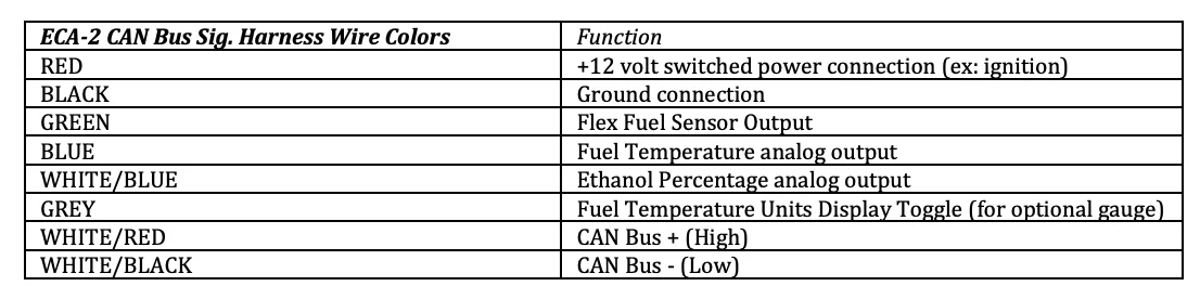

Visconti just uses the zeitronix ECA2 hardware. You can grab all specs and output wires here: https://zeitronix.com/Products/ECA/ECA2CAN.shtml
