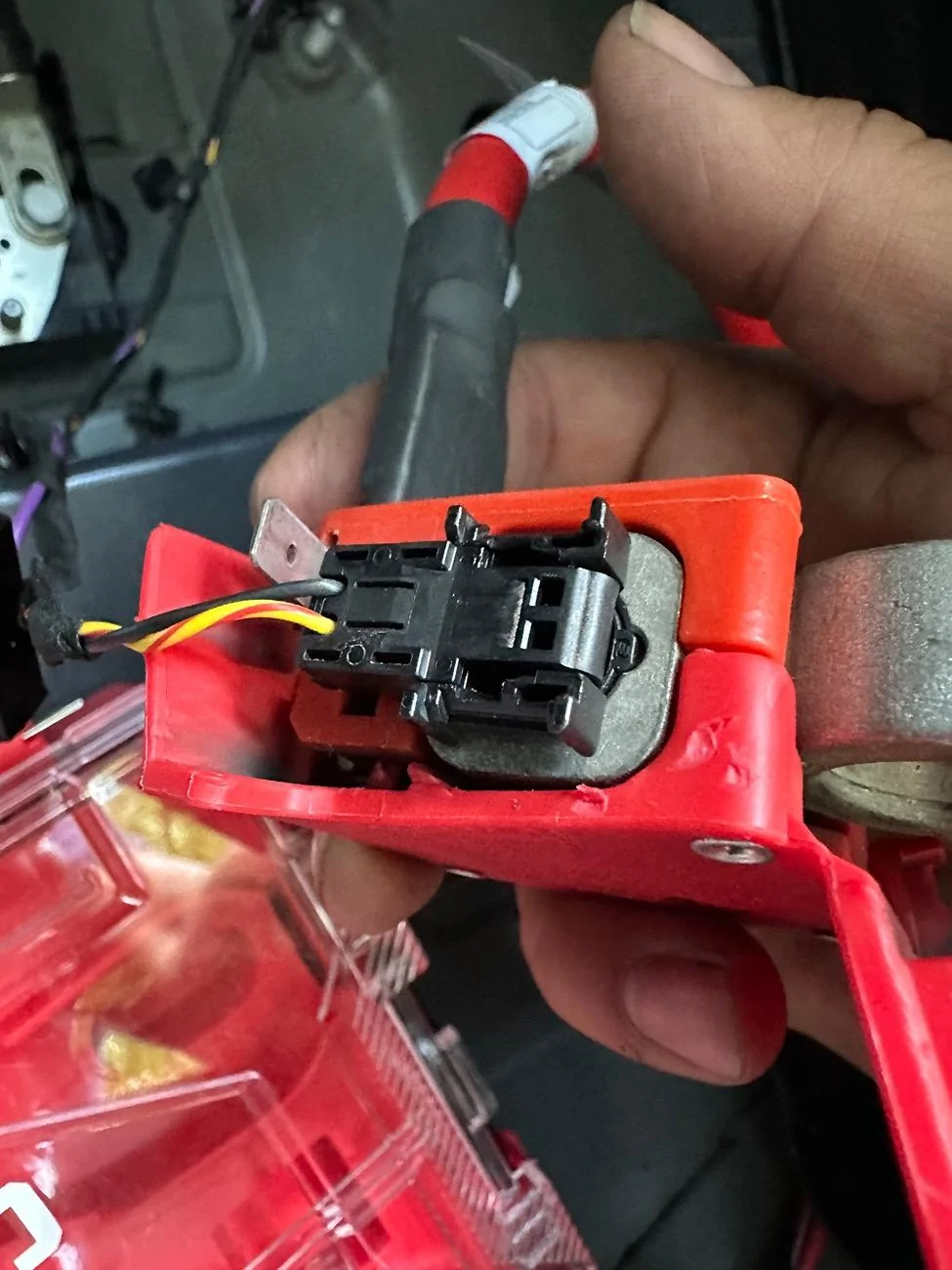

New part came in today. How do I remove this plug?
