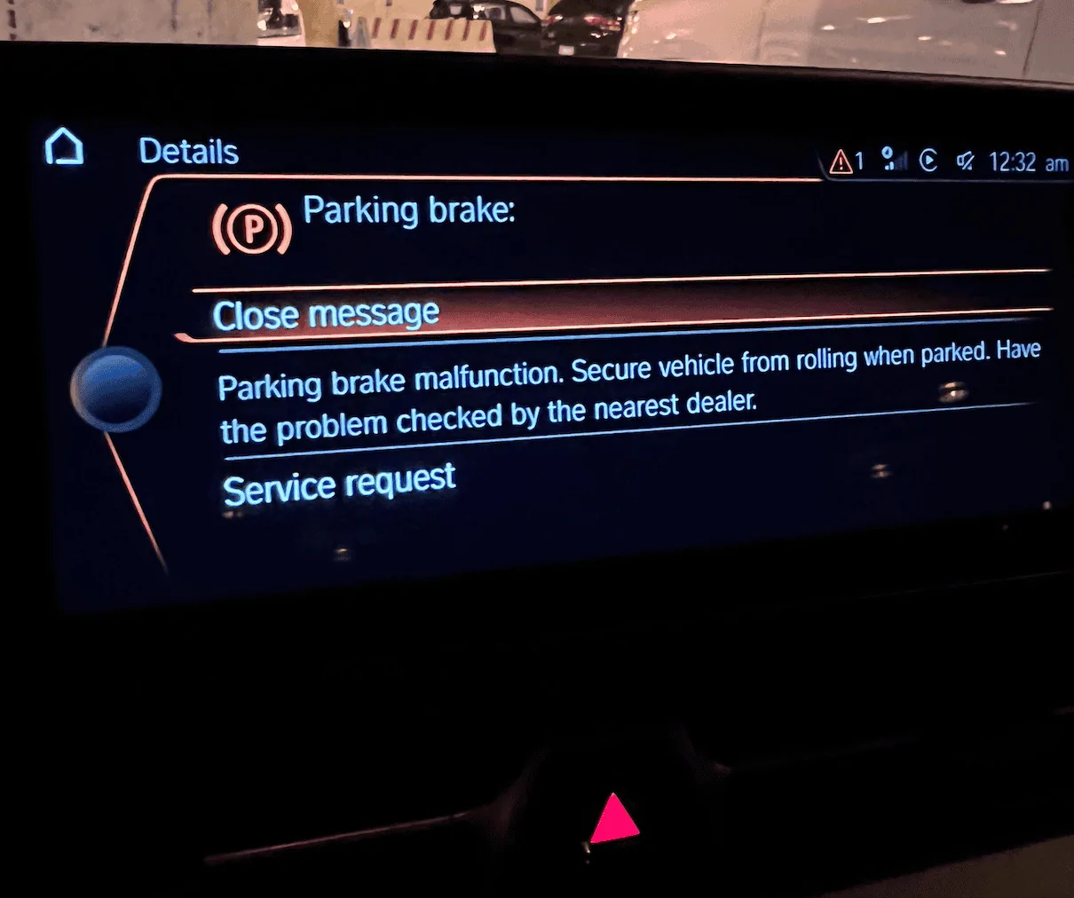

With no prior issues, I went to the airport the other day to pick my husband up. I have 15+ years of habit always using the parking brake when I park the car - so I always engage it in the Supra.
Pulled into a parking spot, put the car in park, pulled up on the parking brake switch, and immediately got the error "Parking brake malfunction. Secure vehicle from rolling when parked."
I've had a few error messages pop up randomly before so I assumed when I came back to leave, the message would clear itself by shutting the car off and turning it back on. It didn't.
When I started the car, I closed the message and put the car in reverse. It showed it went into gear on the shifter, but I didn't *feel* the car change gears like I normally do - it stayed completely still - so I had no idea if it actually went into gear. I tried the same thing putting it into drive - no change.
I spent about 45 minutes trying to clear the message by disconnecting the battery a few times. I didn't find anyone else online who had experienced the problem before, so I was kinda stuck.
I was afraid to try and step on the gas pedal while in gear because I didn't want the car to jump into the cement pole in front of my parking spot or backward into another car so I just left it there and called an Uber to get home until I could come back the next day with some tools to poke around.
The next day I eventually gave up searching for the damn gremlin causing the problem and I ended up giving the car some gas while in reverse. It hesitated for a second like it kinda felt "stuck" but then it drove like normal and got me home. The message never went away.
Took it to the dealership yesterday and they kept it overnight. The final consensus was to replace the parking brake switch (part number 84390-WAA01) which wasn't in stock, of course, so I'll have to bring the car back in a couple of days to have them replace it under warranty.
