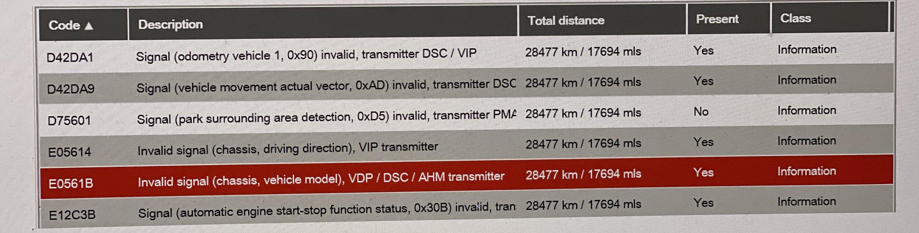

When backing out this morning, the sensors work, camera work, etc.. but after about 5 seconds, the car then throws the "parking assistant malfunction" even though the sensors are all working and beeping.
When arriving and parking at work and throwing it back into reverse (reengaging parking assist), the system just doesn't use any of the sensors at all. Really puzzling.
Here are the errors that I gathered, (ignore the last). I thought recalibration would work but I'm going to try to update the SW package tonight once I get a battery charger.

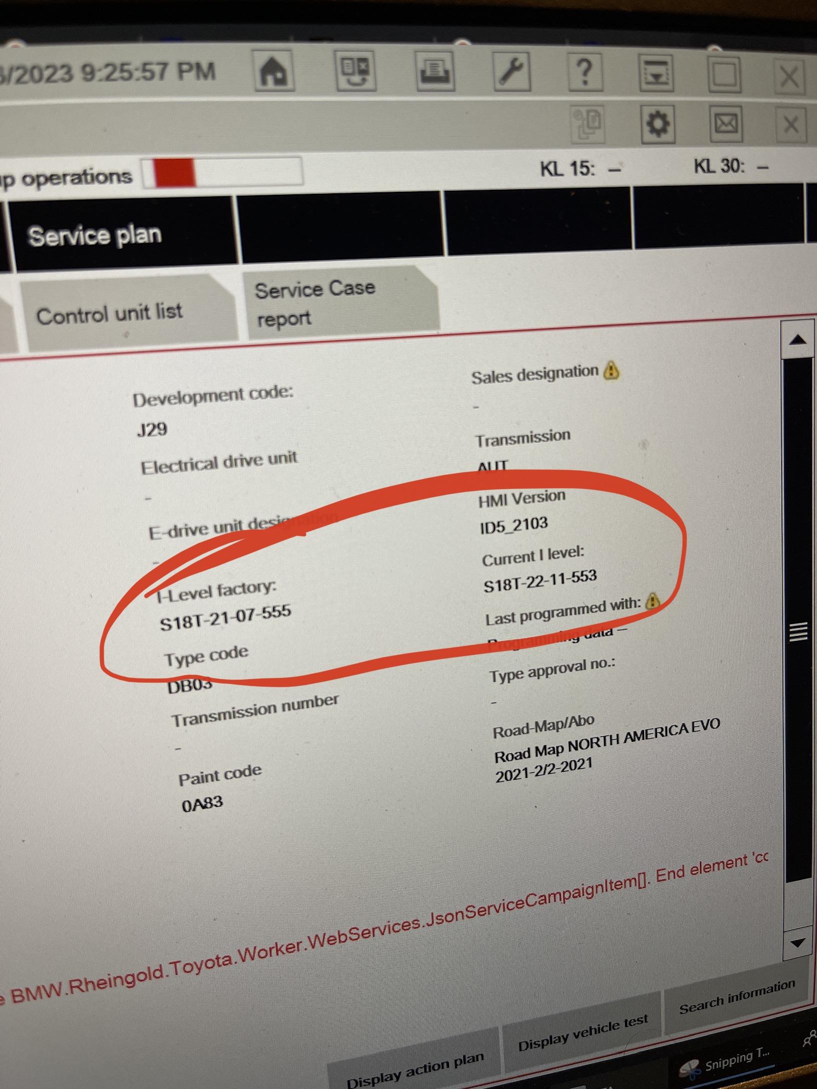

Update for anybody who runs into this issue in the future.
I updated my car from S18T-21-07-555 to S18T-22-11-553 and no more parking assistant malfunction. I'm guessing itā€™s a common bug as suggested by others. System is working like it should and car isnā€™t throwing anymore errors.

how was this updated?
Via the latest (Toyota) ISTA from the TIS website. I noticed there's not a real DIY guide on the forum. May write something up this week.
