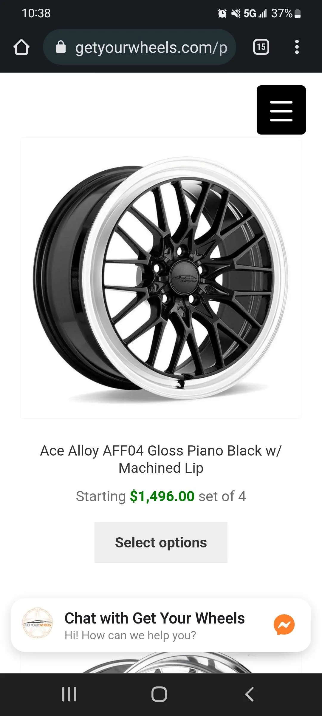

Hello all. This is my first post to a public thread. Greetings from Albuquerque!
After a frustrating amount of time searching, I turn to you. I haven't been able to find a single set of black wheels with machined lip in the size, price, and look that I'm after. I'm looking for something in 19X9.5 and 19X11 to be wrapped in 265/305 R888Rs. Also not looking to spend more than $600 per wheel. For reference, I attached a pic of some that I love, but couldn't find them in the desired size.

Get some te37’s. That’s the fav wheel for the a90’s,
That's not a very compelling motive for a purchase. Lol. They're alright. Some setups/colors are better than others. I'm also the type that doesn't really want what's considered overly popular.
