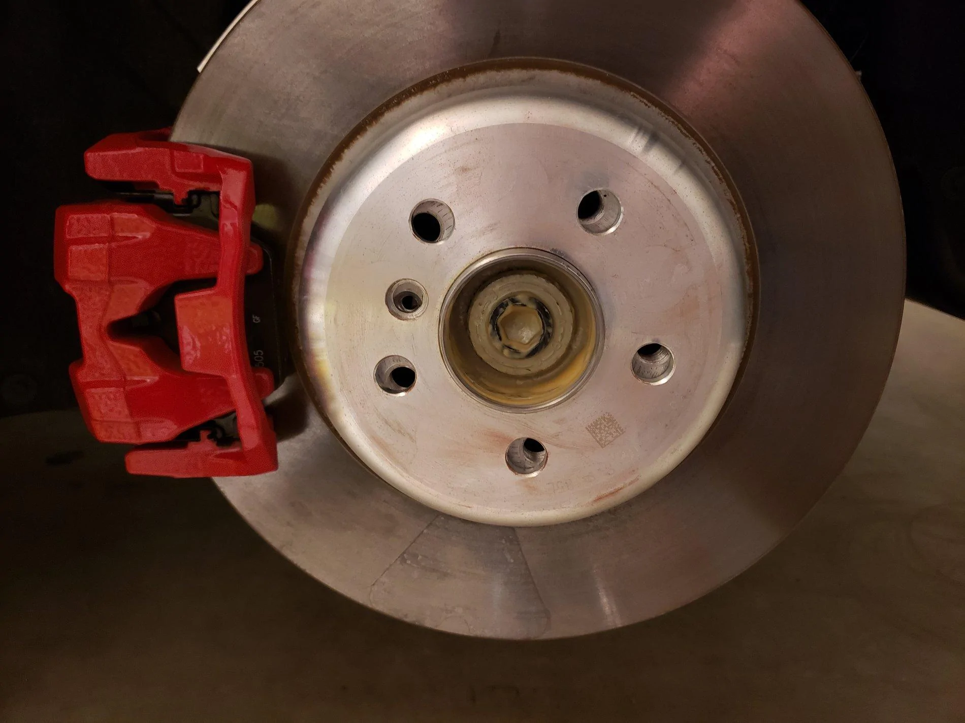

So this is my first experience with lug bolts. Removed rear wheel to install spacer. Removed factory hub bolt so I could mount spacer and new hub bolt. The hub rotor hat has shifted and is not lined up with the hub now. And it WILL NOT budge. I feel like a full blown retard, but I have never messed with these before. Something I'm missing?

How did you misalign the rotor like that?

Yeah I'm feeling ya. I am doing a stud conversion first thing. When I unscrewed the hub bolt it just twisted like that. Was bound up tight. Just had to work it a while.

The odd ball hole in-between the stud holes should have a flat screw in that spot to keep the hub and rotor aligned, at least going back to the old E36 had it.

Correct. I had to remove it when installing spacers as it includes a new bolt to hold spacer in place.

Sorry should of fully read original post, saw the picture and my inner 24 hour of lemons nerd self sprang into action. Glad you figured it out.
