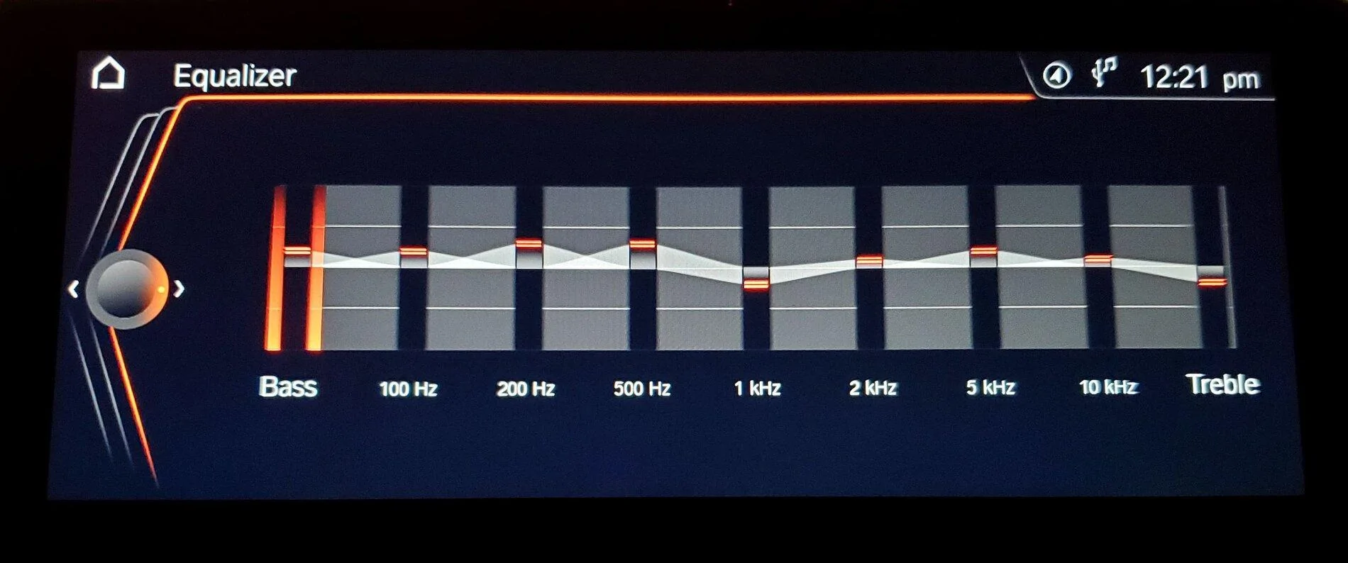

I'm not experiencing any better sound quality with XM / Sirius then I do with USB sourced music...That said, the Satellite receiver source voltage level sent to the amplifier is noticeably higher than the USB resulting in higher volume levels at same volume setting...And while the satellite signal has a higher signal level than the USB source I find the satellite sound quality is far less as it transmits a fairly compressed audio signal...
The USB sourced music I'm experiencing has very good bass response and sound quality ...Curious as to what are your audio system settings set to?
Here are my current audio settings: (after making design modifications)
  • ASD / Active Sound Design (off - using Bimmercode)
  • Surround (off)
  • Speed Volume (+4)
  • Balance: (0)
  • Fade: (front +2)
  • Broad Bass (+2)
  • Broad Treble (-2)
  • Equalizer (shown below)
These are my new EQ settings (below) after improvements made to current OE Subwoofer system...I can also now raise the volume to 2/3 of max with no low bass distortions or vibrational noise...
If your looking to significantly improve bass quality I would take a look at this thread below....
