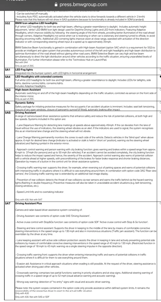

Based on the following, it would be in 5AG, however we dont have that option. So that means if someone wants to keep lane departure, they would need to leave 5AS on, and selectively turn stuff off to disable front collision. Will explore the protool "add-on" function tomorrow and see what it does.
VO CodeOfficial NameDescription
5AGLane Change WarningThe standalone code for blind spot monitoring. It activates the rear radar sensors and the warning LEDs in the side mirrors.
5ASDriving AssistantA safety "bundle" that includes 5AG as a standard feature, along with Lane Departure Warning and Collision Mitigation.
5ATDriving Assistant PlusAn advanced bundle that includes blind spot monitoring plus Active Cruise Control (ACC).
5AUDriving Assistant ProThe most modern suite (G-series) that includes blind spot monitoring, 360-degree radar coverage, and semi-autonomous driving.
(i didnt mean to post this here but fuckit. We were talking about how to get blind spot monitoring back with the latest coding strategy)
