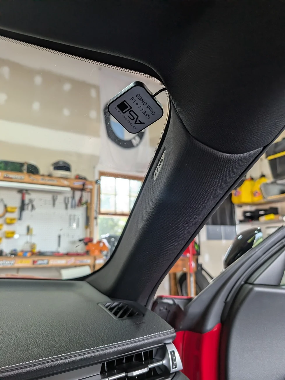

Where did you place the GPS antenna?

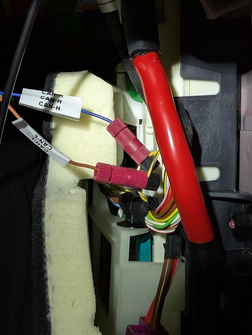

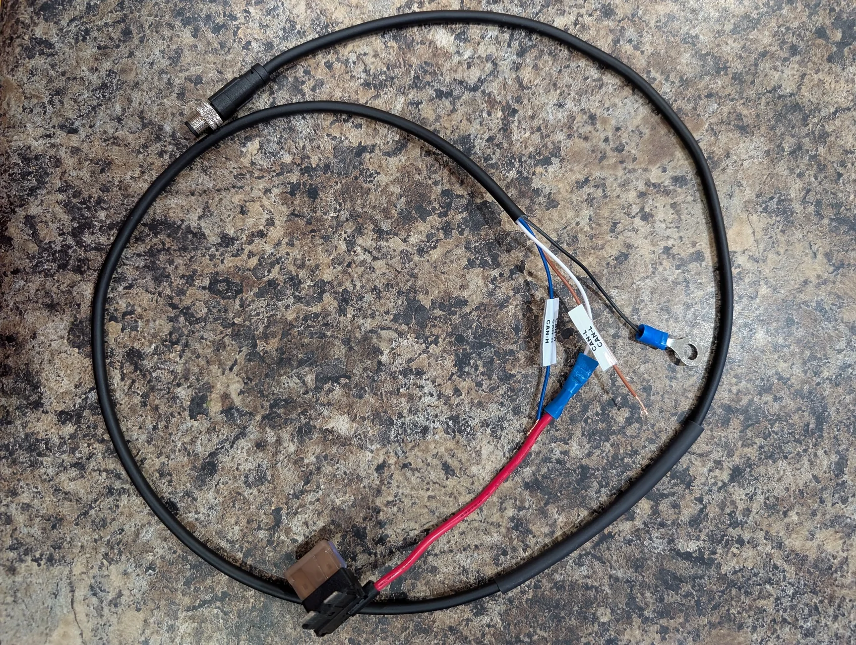

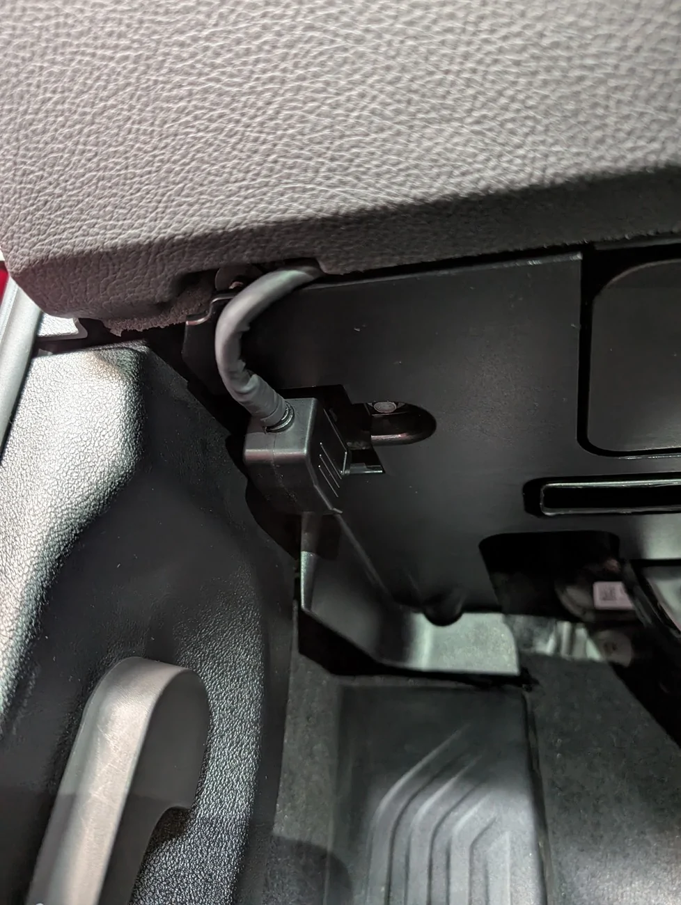

I did decide to cut the power wire on the OBD2 (CAN1) side because that guy is not switched; we'll get power from the PT-CAN (CAN2) side. I also found another dude's website for tapping into both networks https://thesecretingredient.neocities.org/racecapture/#three which is super helpful. I decided to just use the OBD2 adapter cable that came with racecapture but modified it. And another thread on here for radar detectors was helpful. Anyways, I'll do a write up once I'm done 🤘🏼

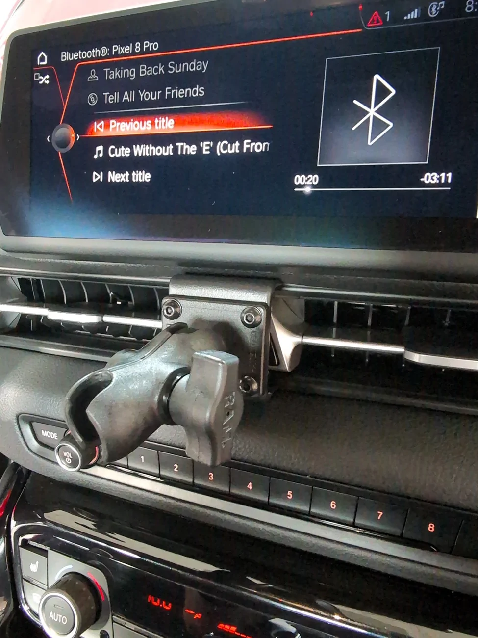

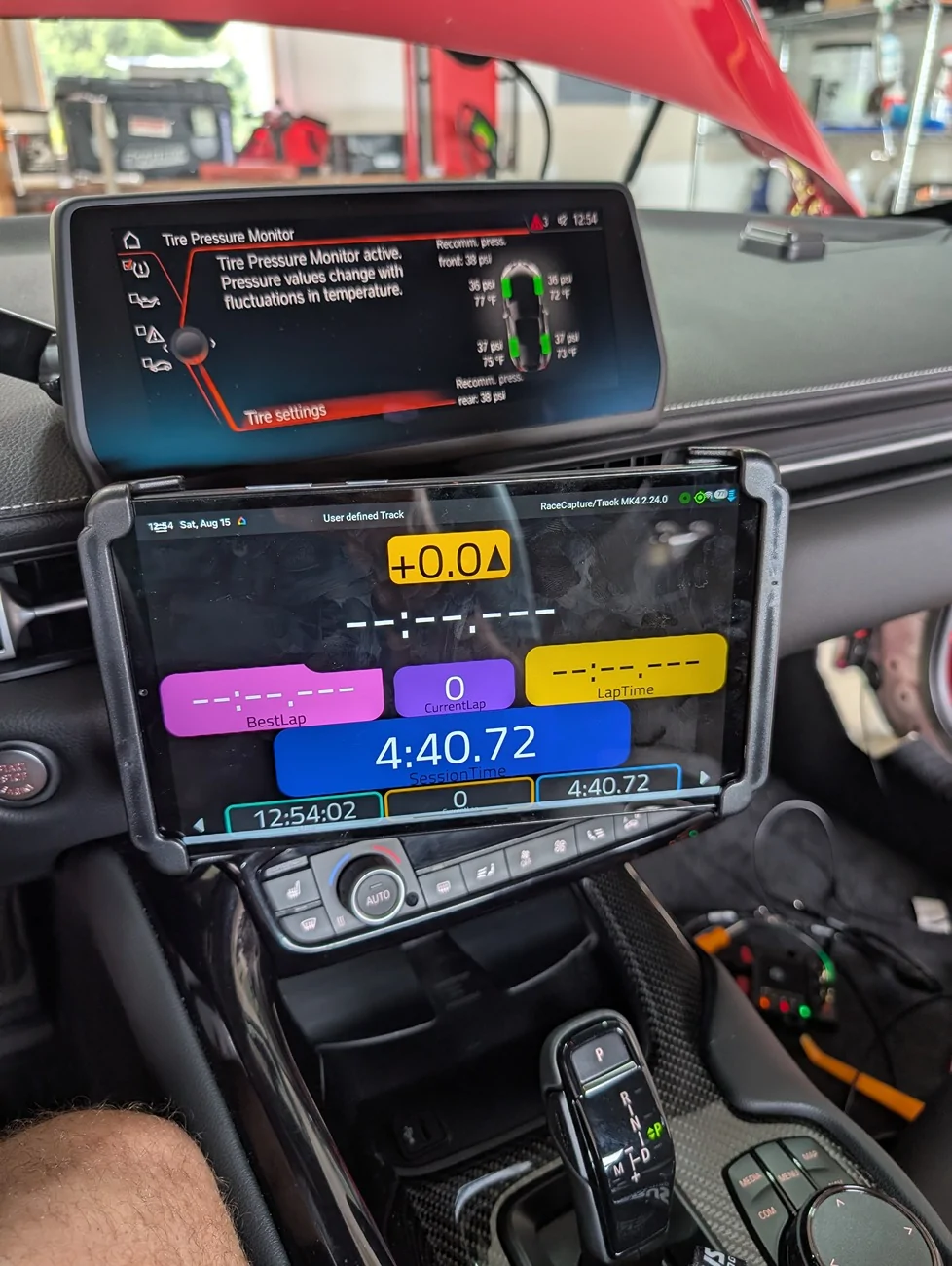

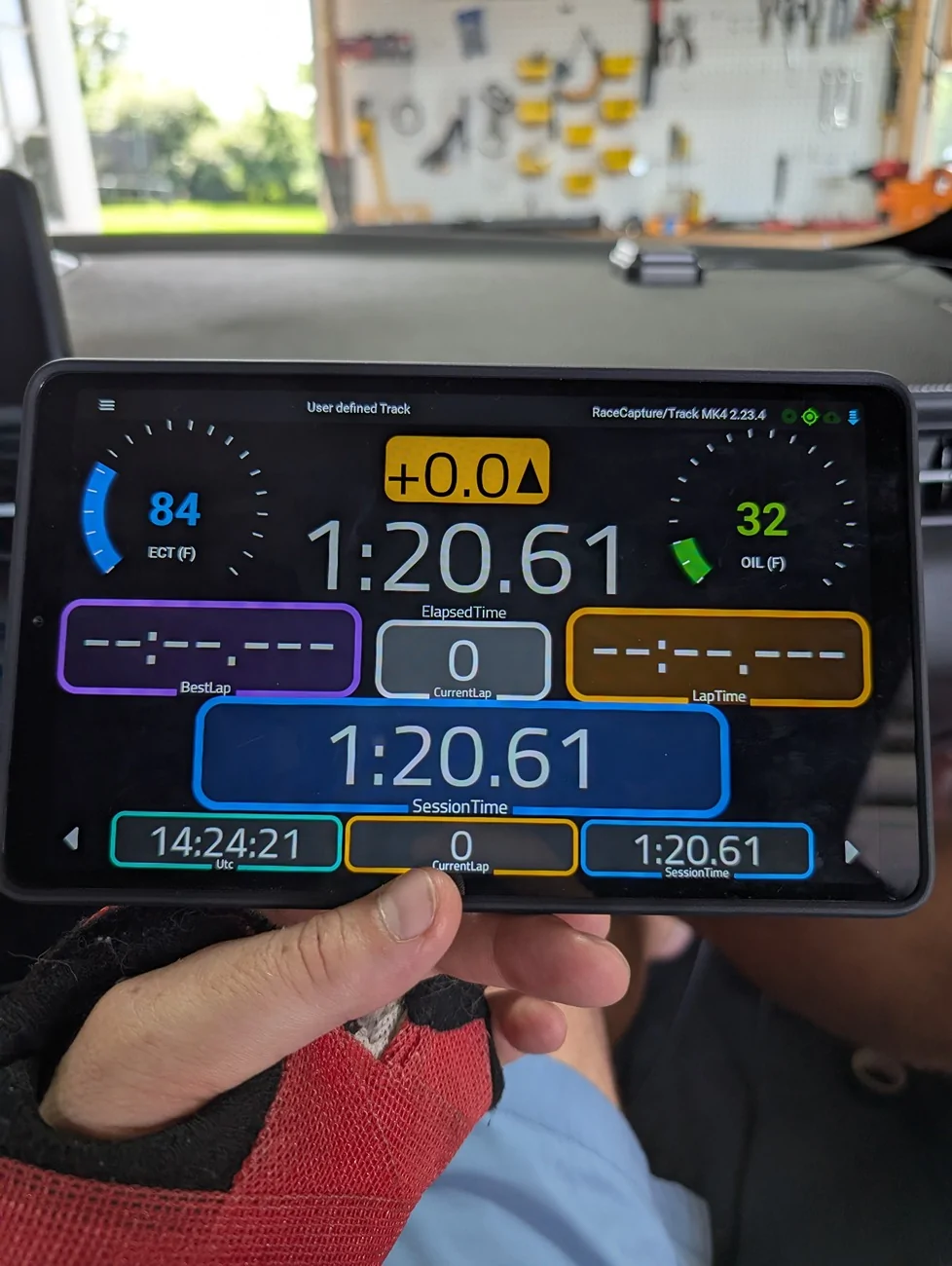

I got most of this set up working as it should. I purchased the race capture Mk4 from autosports lab along with a can pigtail and can splitter. I ordered the wrong pigtail so I bought another one with the mail connector off Amazon and just looked at pinout diagrams to match up the colors. A used a pro clip and a ram mount and a Samsung a11 tablet. The only thing that doesn't seem to be working is certain OBD2 values like the two different intake air temperature sensors. If anyone has any insight on that that would be super helpful?!...
I found this spreadsheet on this site from razorlab which was helpful but like I said I can't get certain OBD2 values to work for some reason.
Like I mentioned before, I cut the power wire in the OBD2 cable that came with the race capture device because it's not switched and it would drain your battery if you left it plugged up all the time.

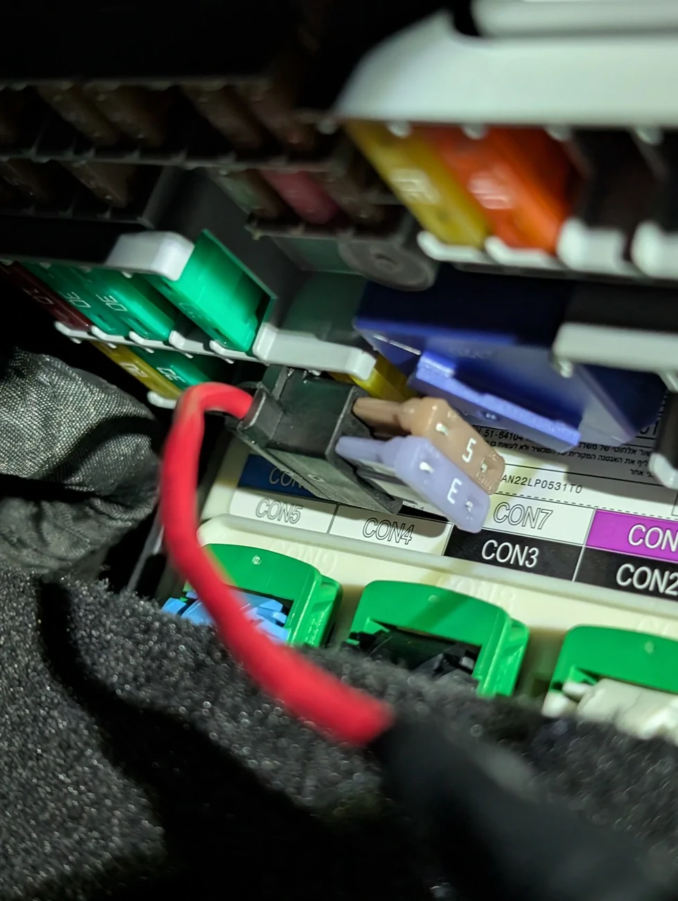

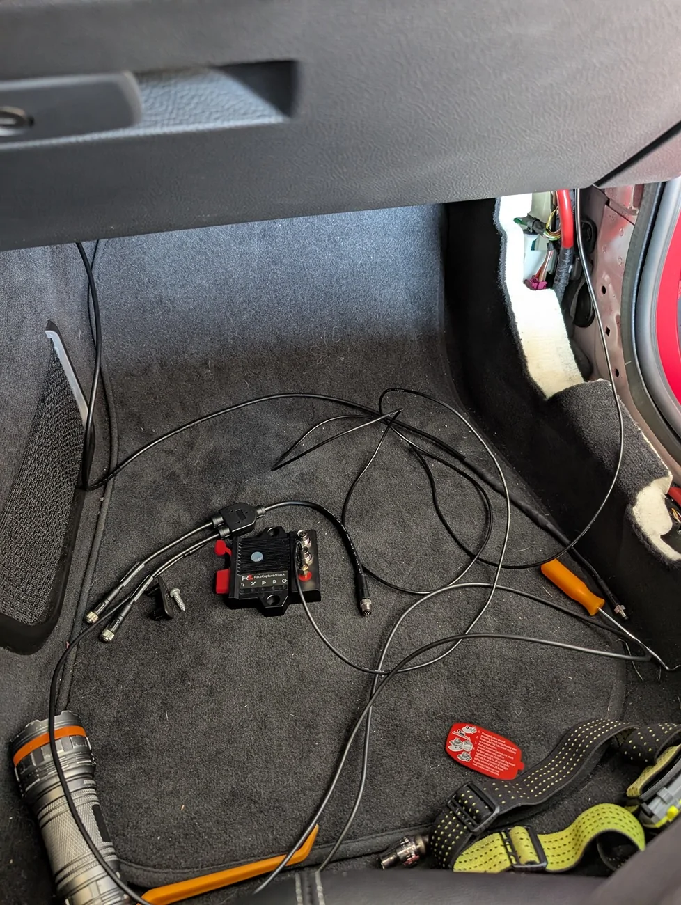

That other website I mentioned above from another member here references all sorts of useful information but specifically where to tap can high and can low for the PT-CAN connection for power train data. I used an add a circuit fuse tap and the empty fuse slot F47 to provide power over the cable that taps PT-CAN and grounded it nearby.

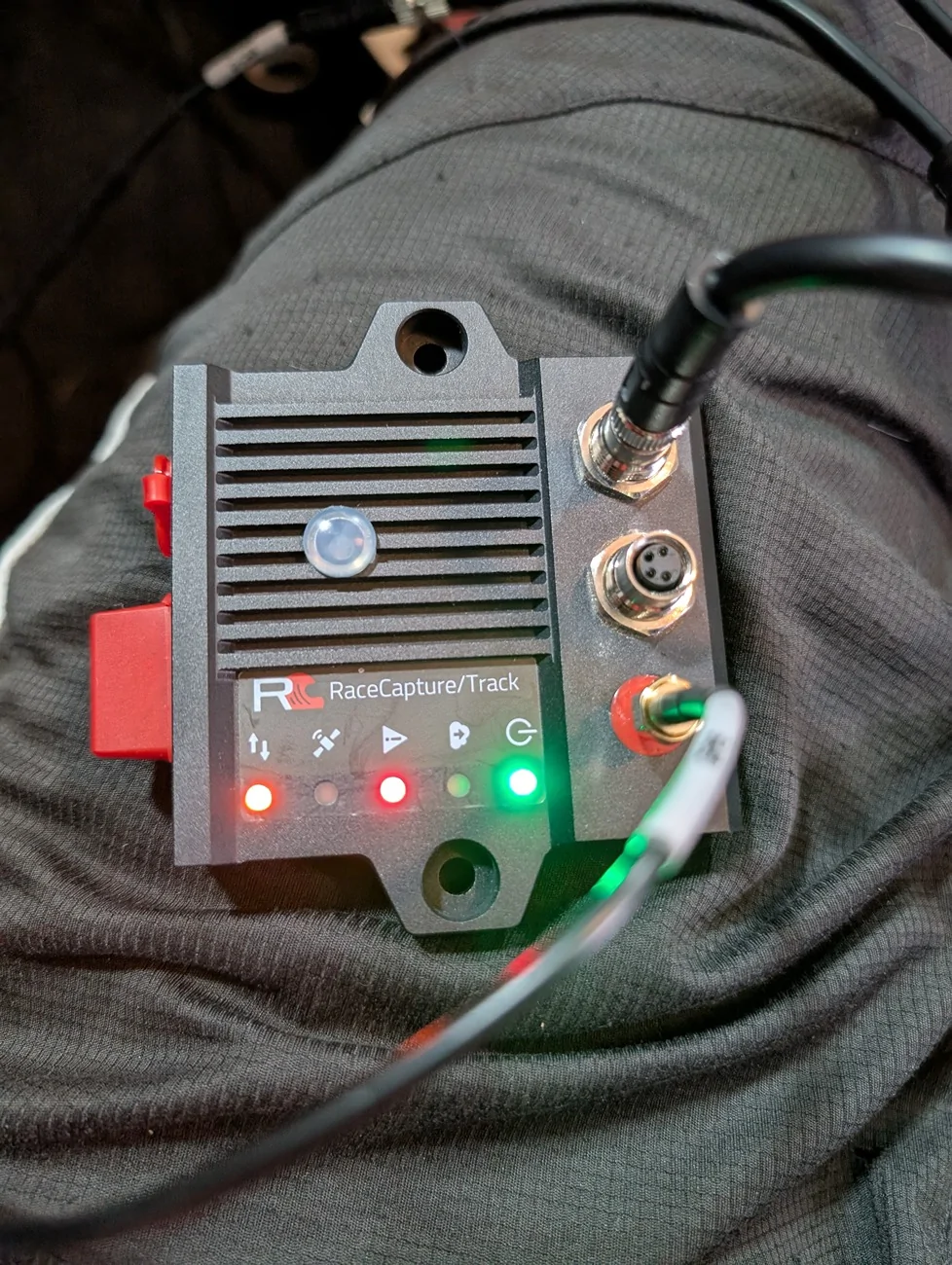

I put the device in the passenger side cargo net for now which changes the g sensor axis orientation but you can adjust for that in software.
You can import the canbus mappings directly from the RC app that someone created I believe the same guy that did the secret ingredients website. Just make sure to login with an account you set up on podium. If anyone wants assistance with this just holler.
I'll be at Summit Point next month with NASA so it'll be a good test for the setup. Great bang for your buck it seems. It's not going to be as convenient as some other platforms for predicted lap timing, etc. But it's flexible and more granular than some platforms; you can add external sensors, cameras, do video overlay, etc.
