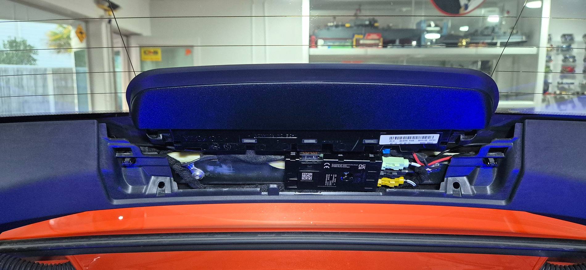

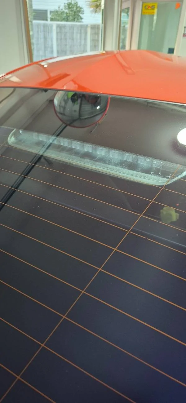

Hi all I have got some condensation under the rear brakelight cover. I have pulled off the cover but can't see a way to remove it to clean the window
Any help appreciated

Don't know the answer to your question, but I had the same issue. I just wrapped a baseball card in a thin microfiber and slipped it between the glass and the cover. The edge is rubber and you can slightly pull it away from the glass.
