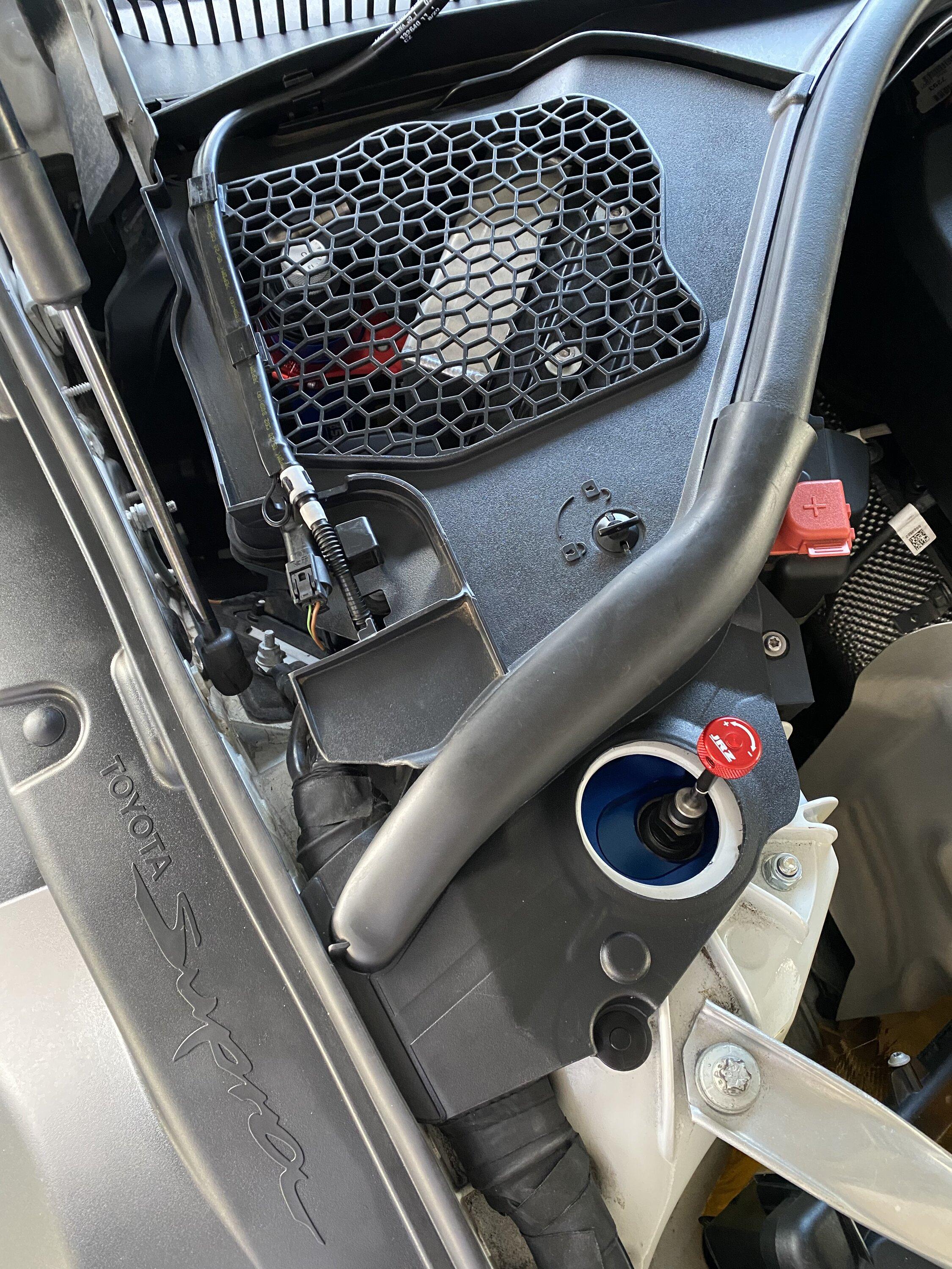

Here is a pic of the passenger side mounting, driver side is similar but along the outer frame rail to clear the master cylinder.
Rears mount them anywhere in the trunk.

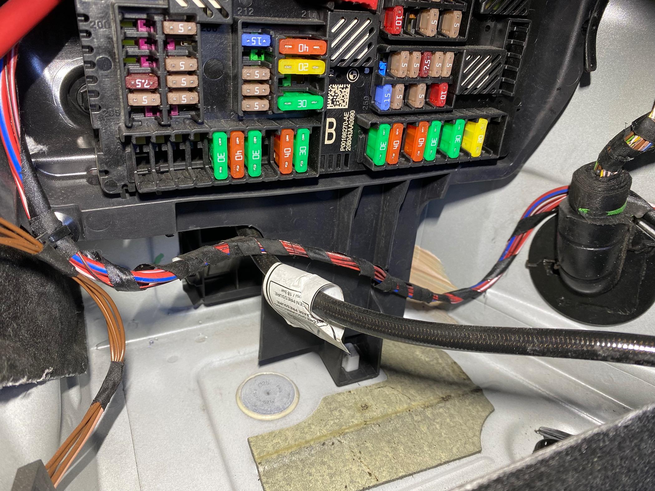

@Carfreak70852 remounted the rear reservoirs today snapped a pic of the rear entry point on the passenger side. You can see the area I trimmed off of the fuse box frame to have better clearance. Driver side is the same, except for you have the TCU control unit in front of the access vent.

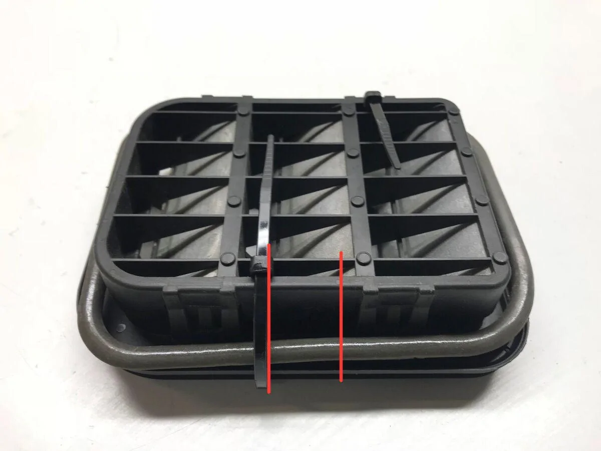

No problem, to get the line through the vent you just cut a slot the side of the vent (towards the front of the car). Run the reservoir into the car and snap the vent back in with the line in the slot you cut out. Attached a photo for you.

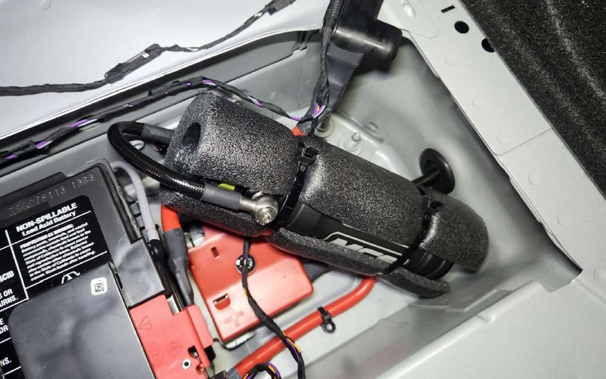

If you have quick disconnects there's holes on either side of the trunk/battery space with plugs you just punch out and use grommets in place to seal back up around the hose. Your spending a huge chunk of money on suspesion, worth the extra cost imo. https://www.mcmaster.com/7081N23/ (this is from Karcepts MCS install manual) Awesome MCS resource, sales team.

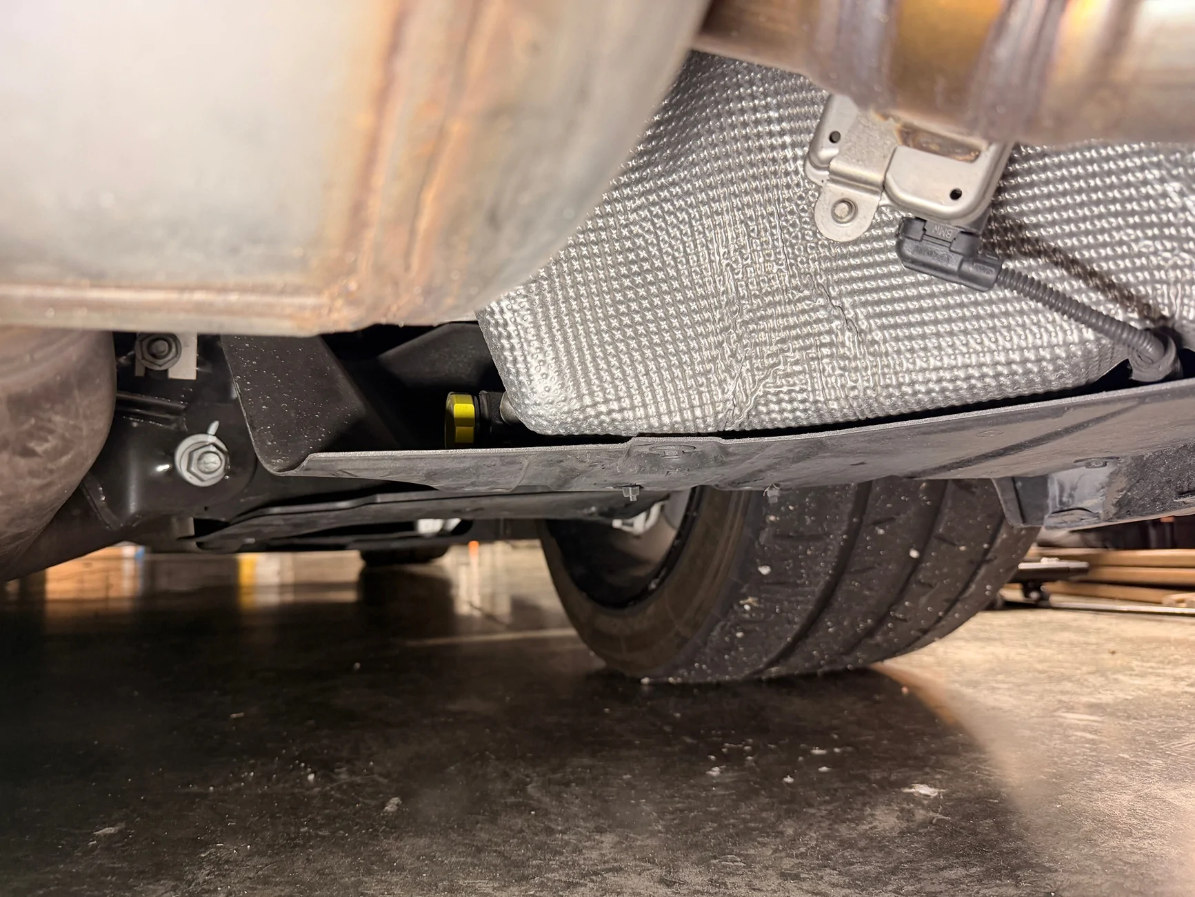

I zip tied them to the top of the splash guard. The guard has holes in it already that you can use as zip tie points. You can see the nibs of the zip tie on the bottom side of the guard in my picture.
