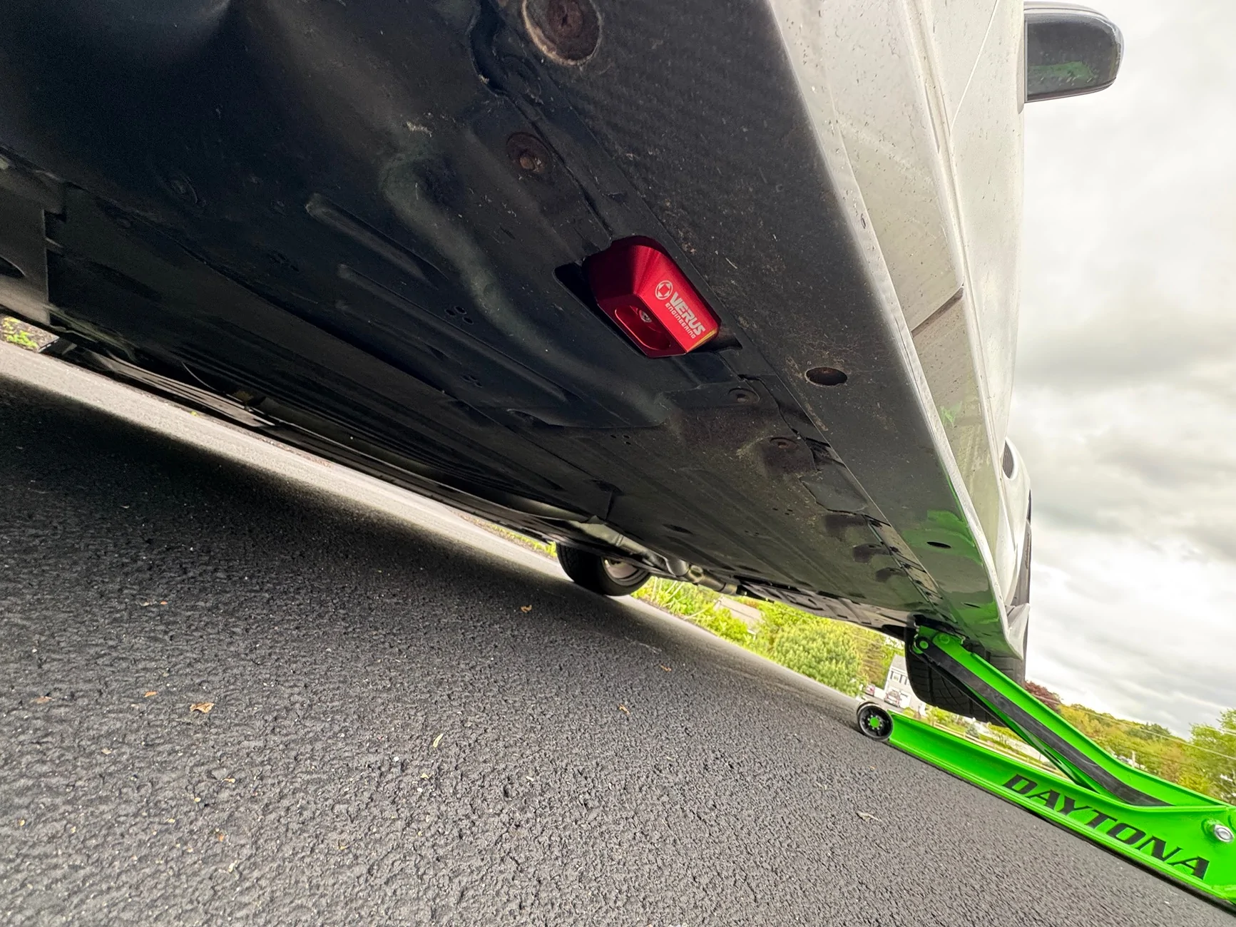

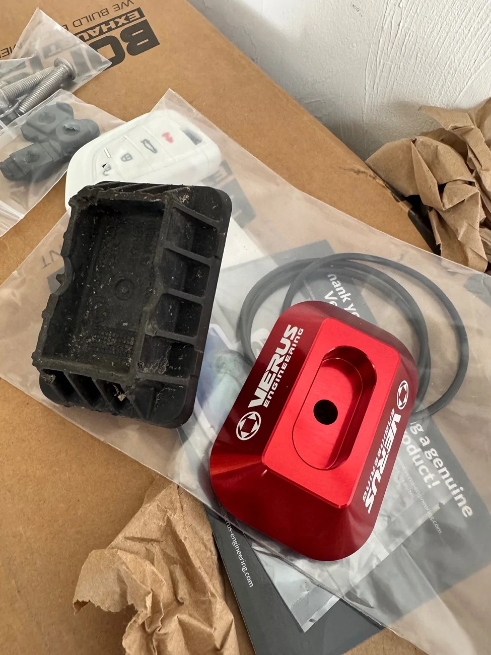

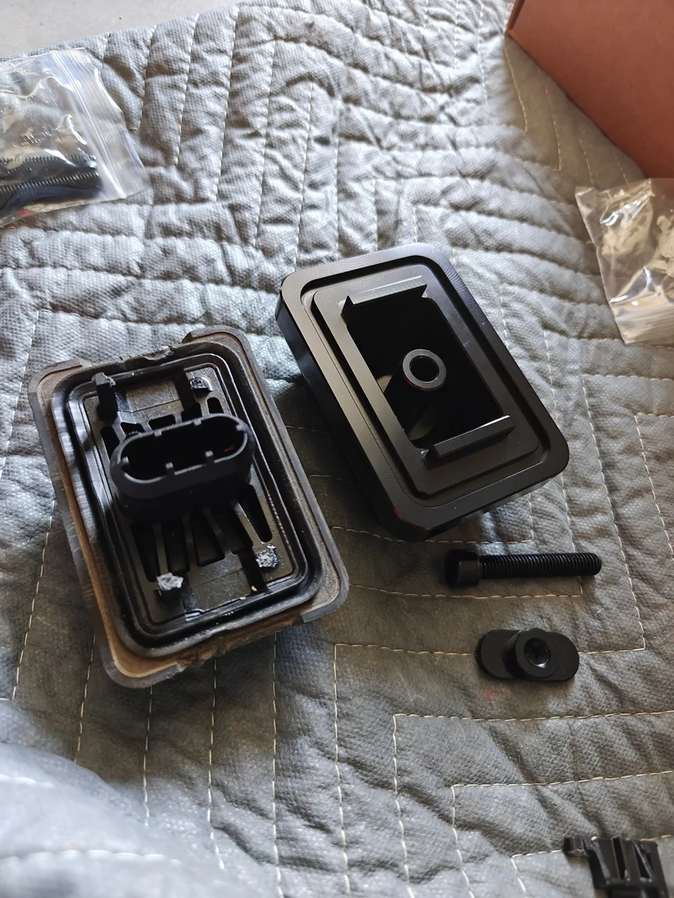

The Verus pads are rebated on the outside as opposed to the inside on the Bevinsee ones. So just a small design difference. In images the Bevinsee ones seem to hang a lot lower than the Verus pads though or it may just be an image perspective issue?
You don't want them hanging any lower than is needed in practicality.

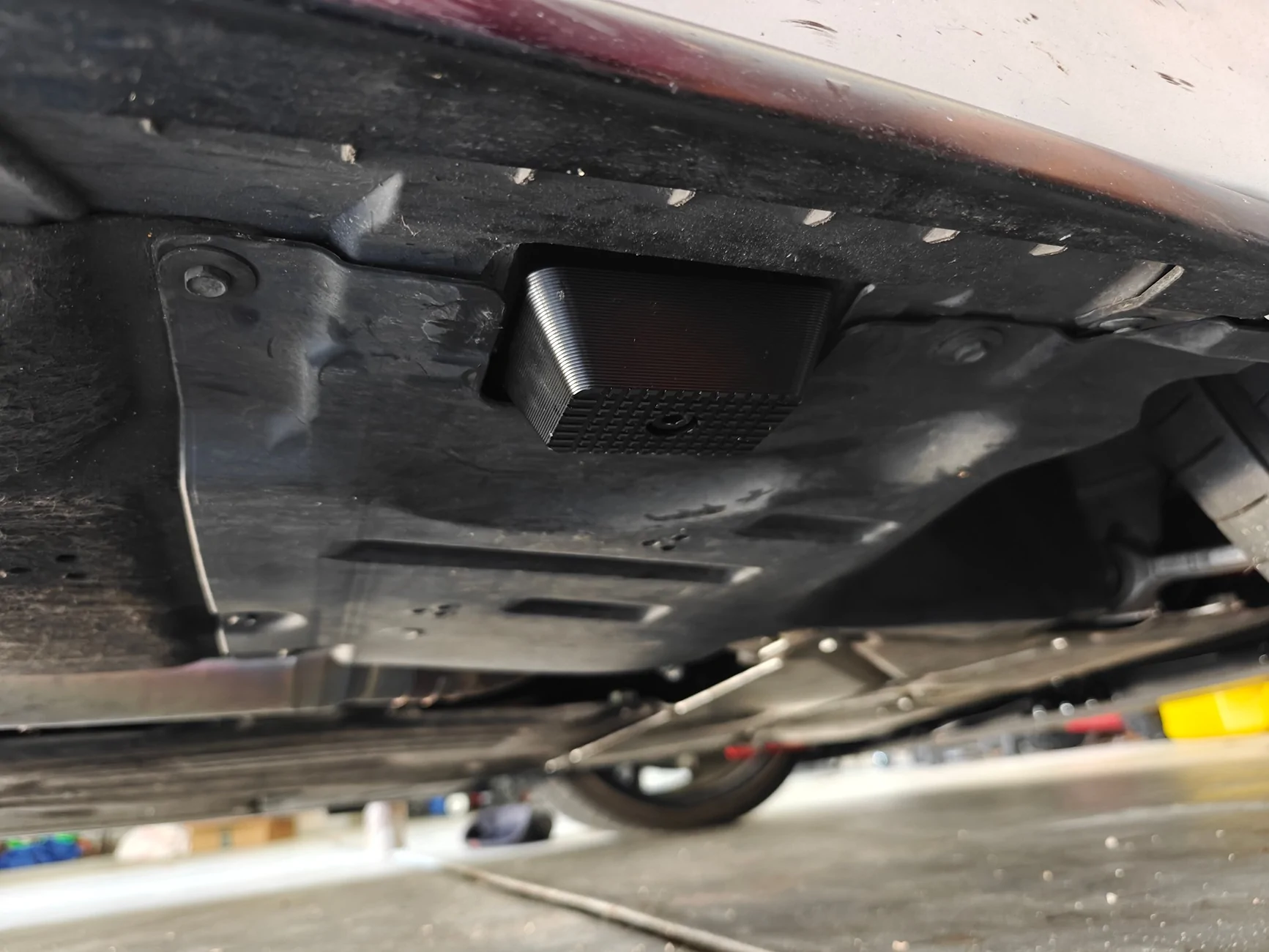

In the first picture I posted, you can see it's roughly the same height as the factory pad. Honestly I prefer this height, any shorter and there is a risk of contracting the side skirt if you have a soft rubber pad on your floor jack.
Sure, we could debate that the factory pad is meant to be sacrificial, but if you're bottoming the bevinsee pad, you're bottoming the OEM one too. at the end of the day, both are strong/stiff enough to hold up a corner of the car.

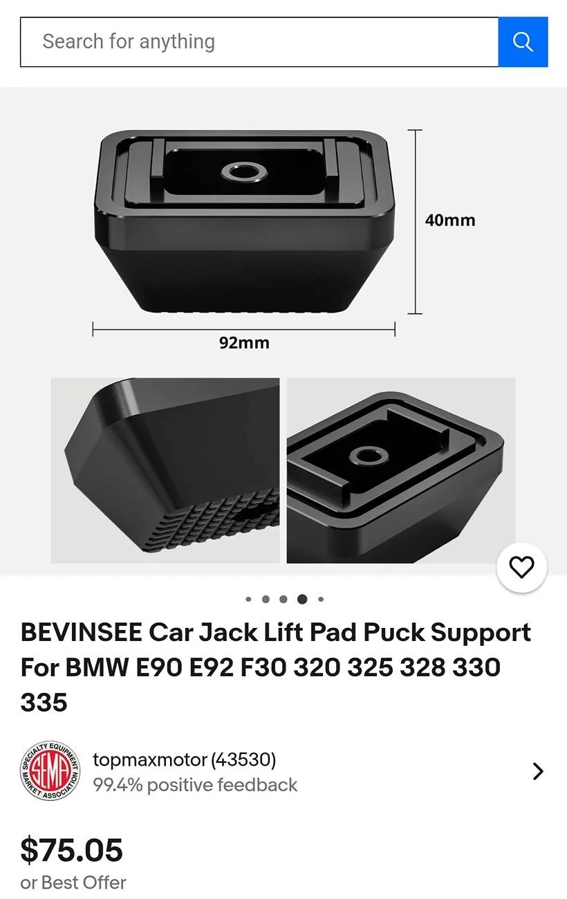

Does anyone know the actual dimensions of the Verus ones? I know the Bevinsee ones are 40mm in height

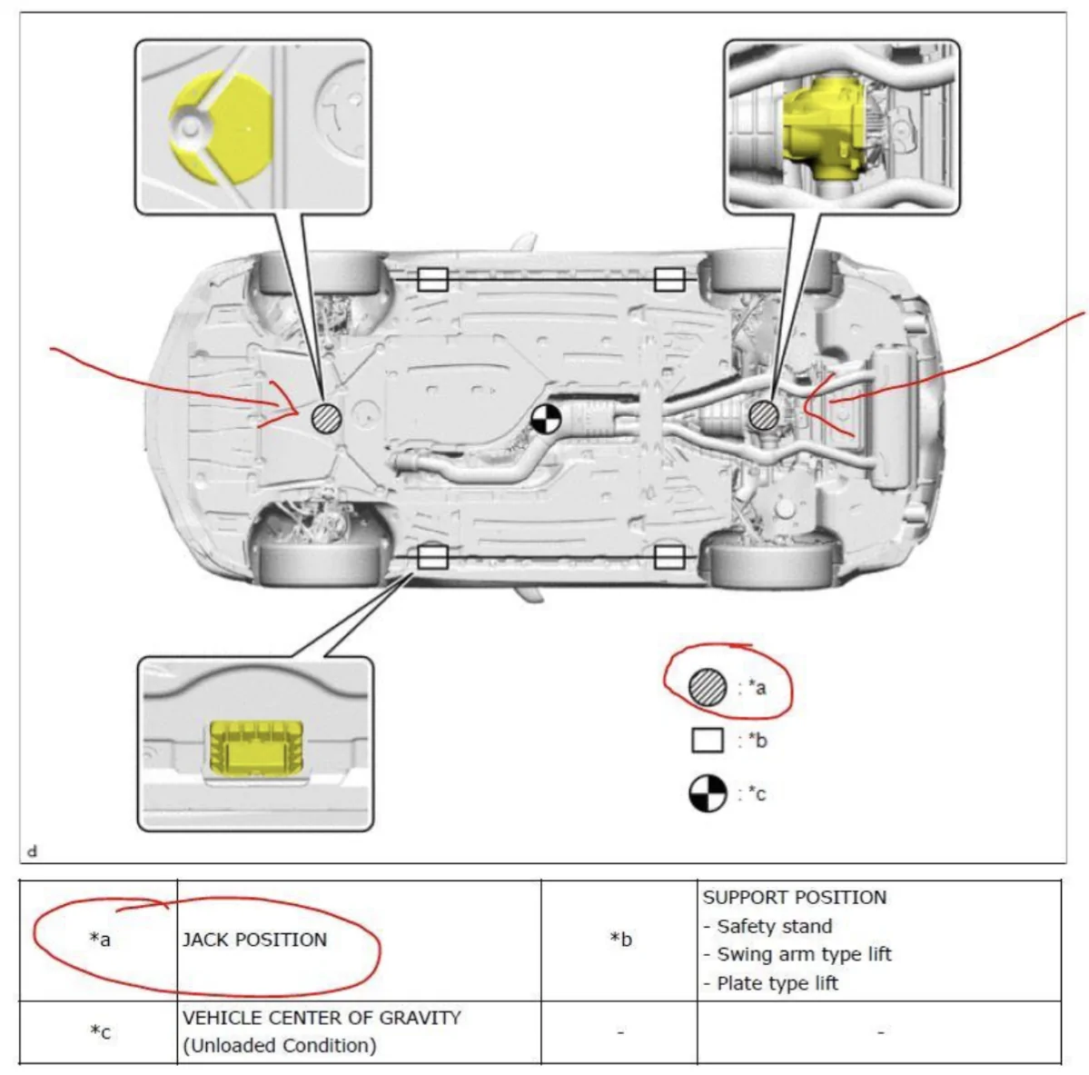

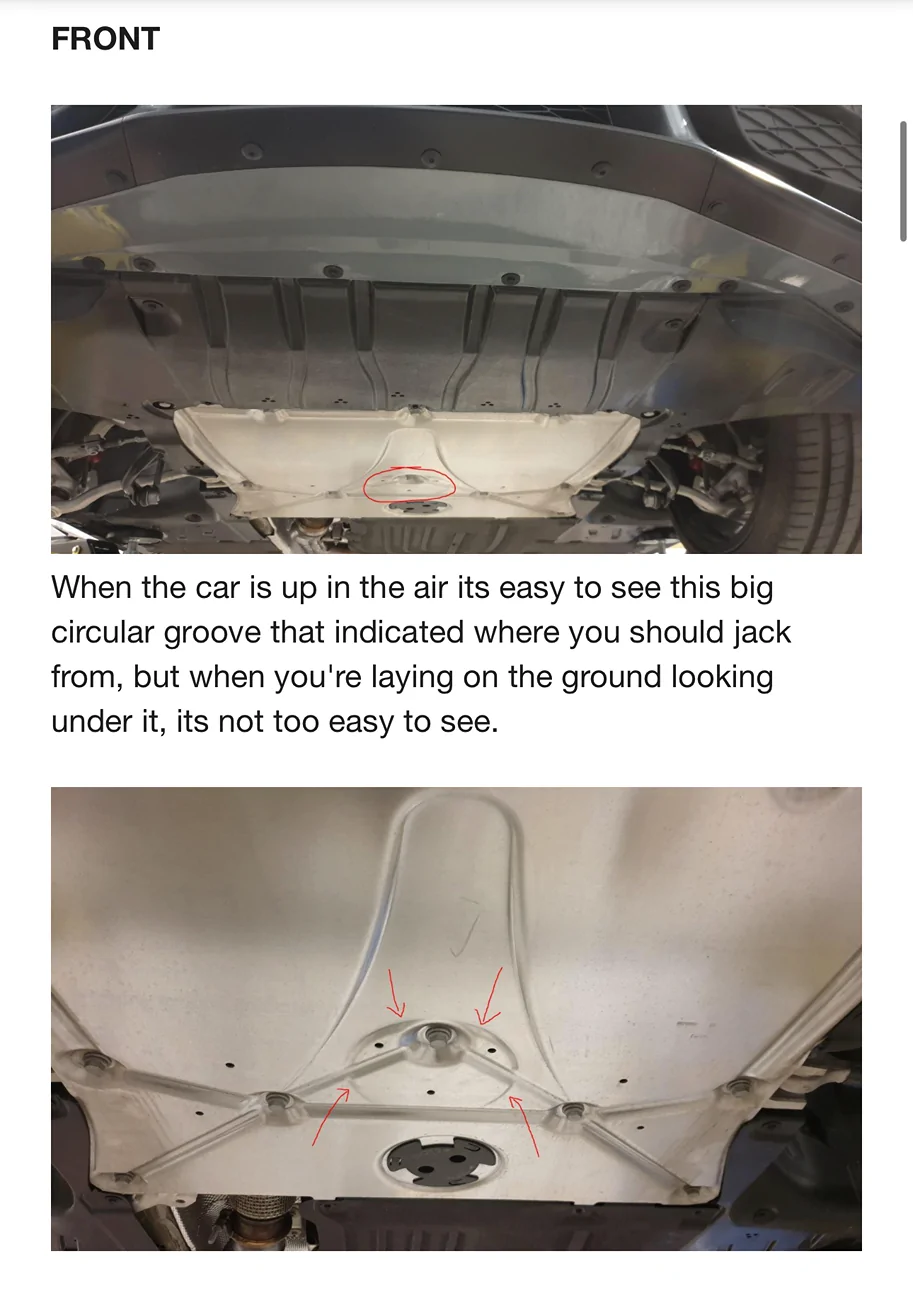

Side question:
how did you guys change them. Any other safe points to lift car to do the swap?
or so I need a car lift where the car is supported on the wheels.
you would just lift from one of the jack points then change out the other (ie. lift from one of the front jack points and change the rear on that same side and work your way around. Other option is to lift from one of the center jack points and you could change out 2 at a time.
someone else posted this in another thread and I screenshot it

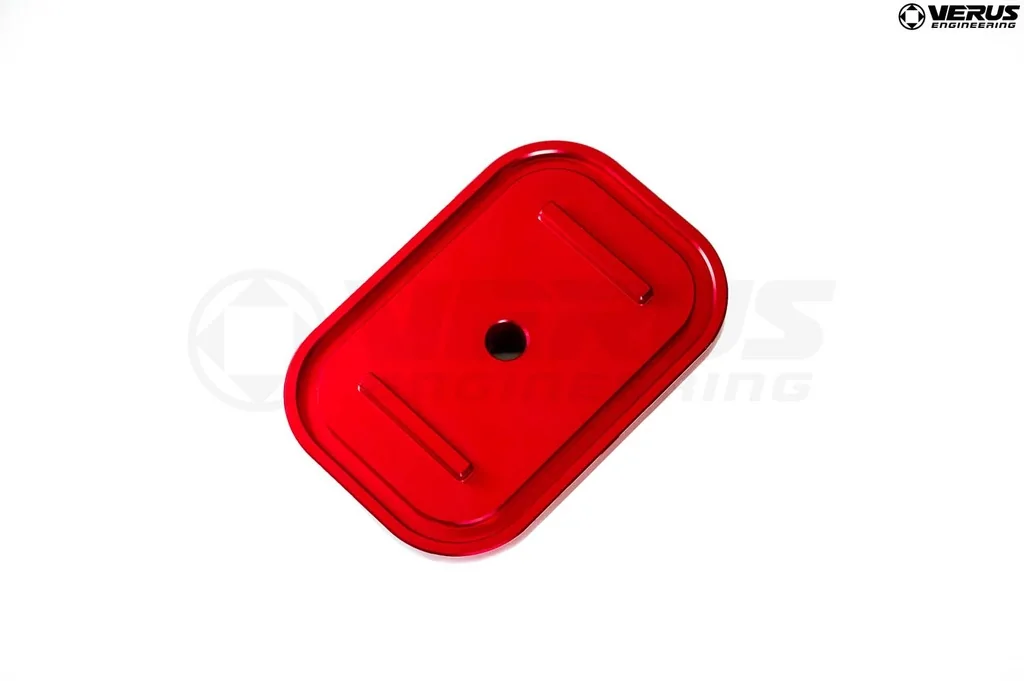

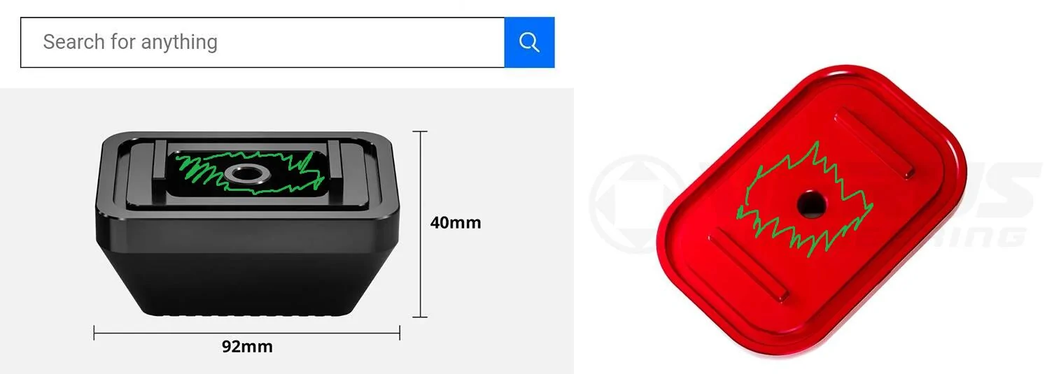

In case anyone else was wondering, I reached out to Verus and they said the dimensions are:
Height - 1 inch
Length - 3 and a quarter inch
Width - 2 and a half inch
I wish the Bevinsee ones were a little shorter. Guess I’m just gonna have to pay more than double for the Verus ones ☹
