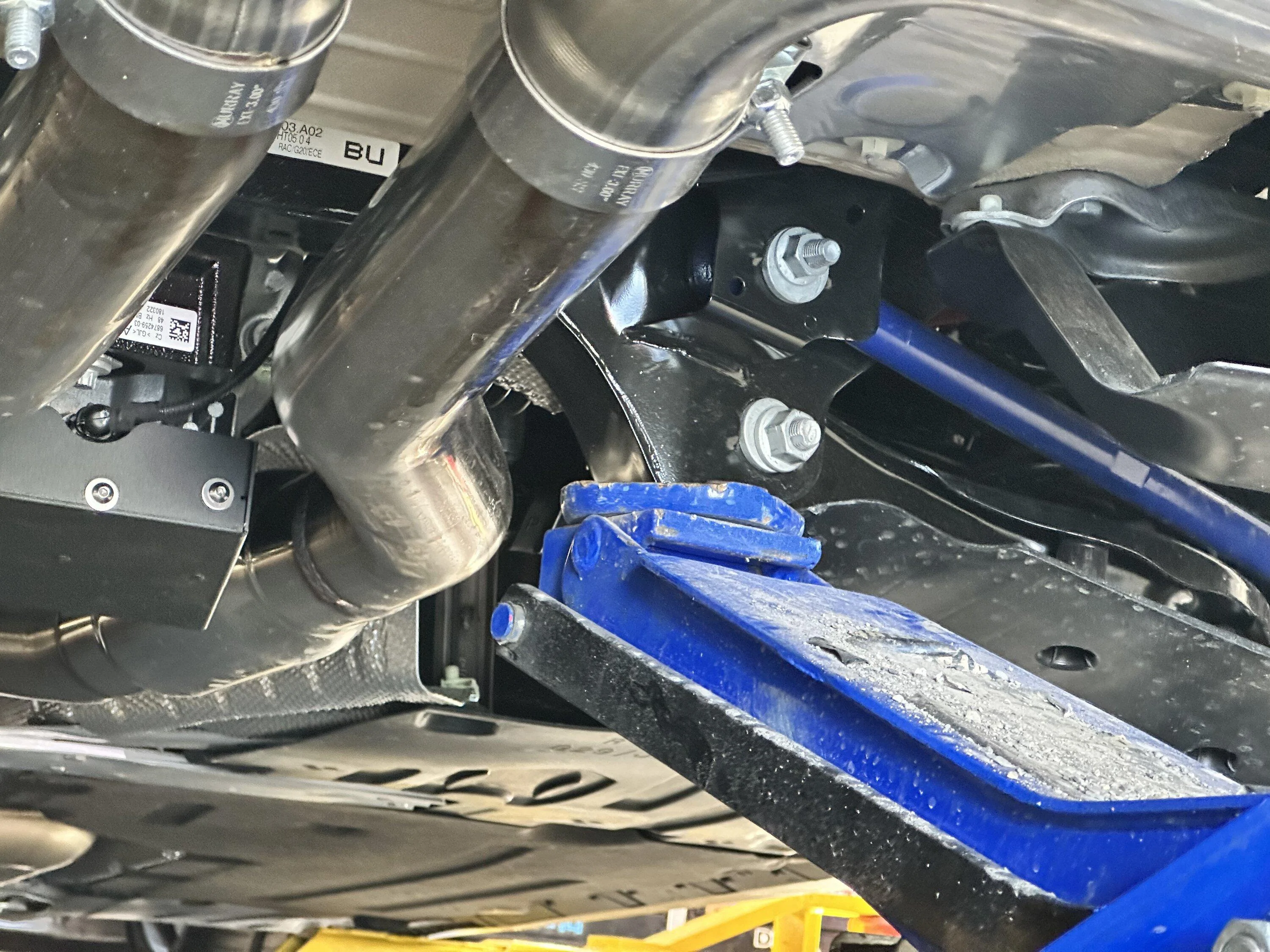

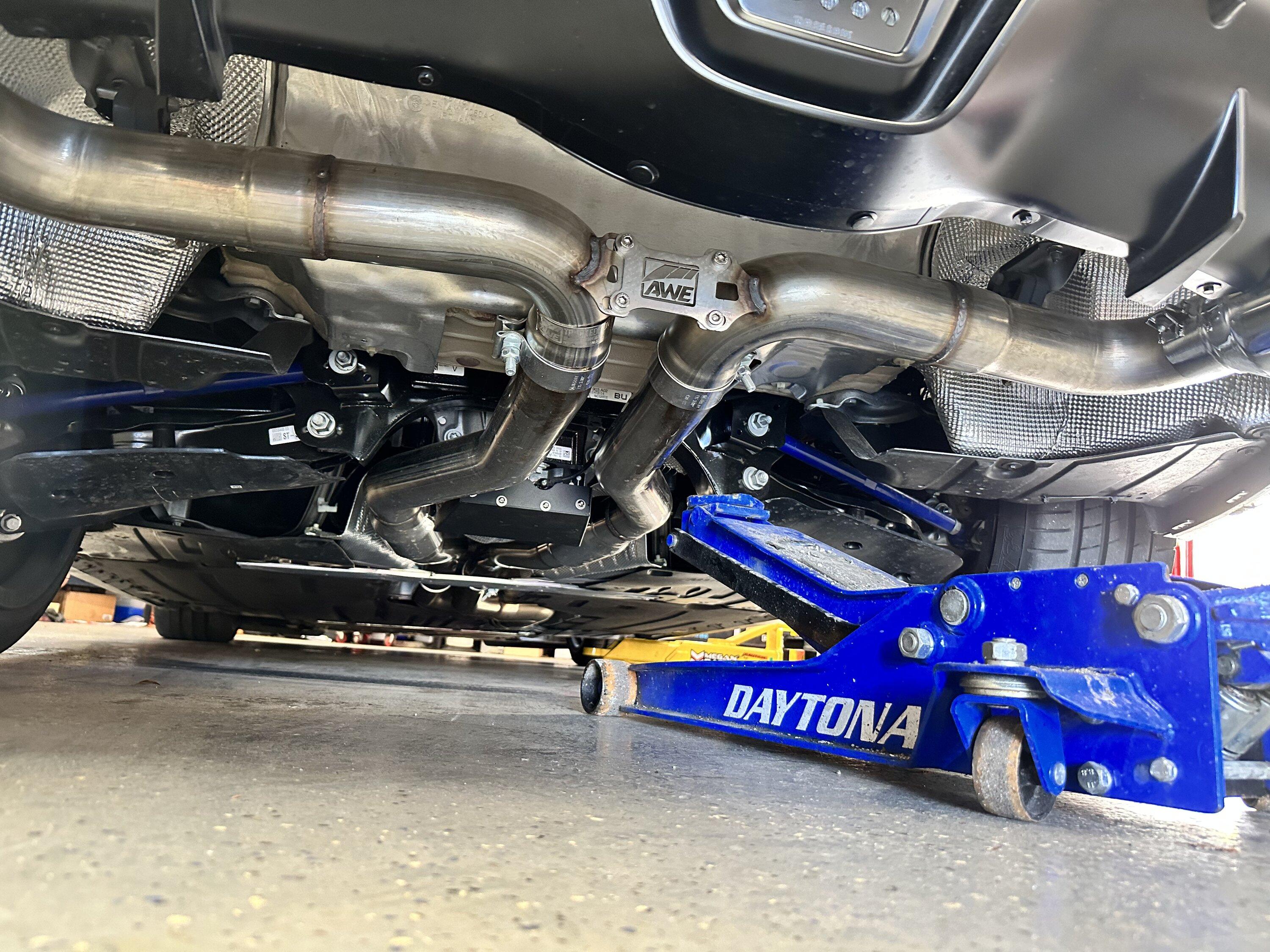

Hi! Was just wondering if it was okay to jack up the car from the side, using an adapter onto the plastic jack stand points? The jack I have isn't low profile enough to get underneath to the diff/near the oil pan, so was just wondering if it was okay jacking it from just the sides, or will this cause issues. Thanks in advance!
If it helps:
I can change both rear tires jacking from either point from the rear. But to change the front tires, I’ll jack each side separately.
