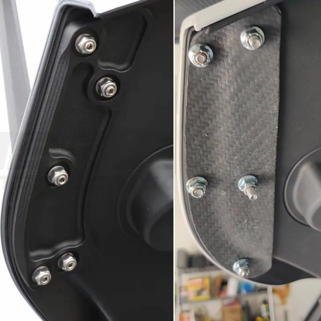

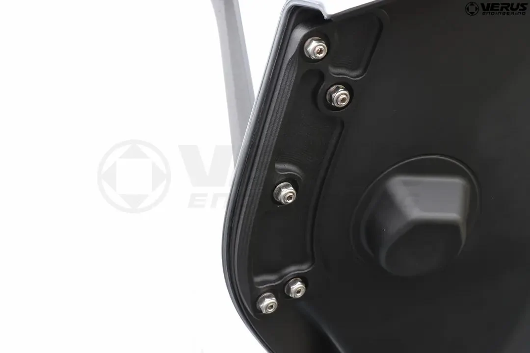

UPDATE:
I reached out to PHD Racing and asked the same question. Spage uses Verus's reinforcement plate for their wing bases. It's this one:
i3igpete
May 16, 2022
45
1,274
1,535
Chicago
2023 3.0L 8AT
UPDATE:
for reference, this is how the AJH plate compares:
