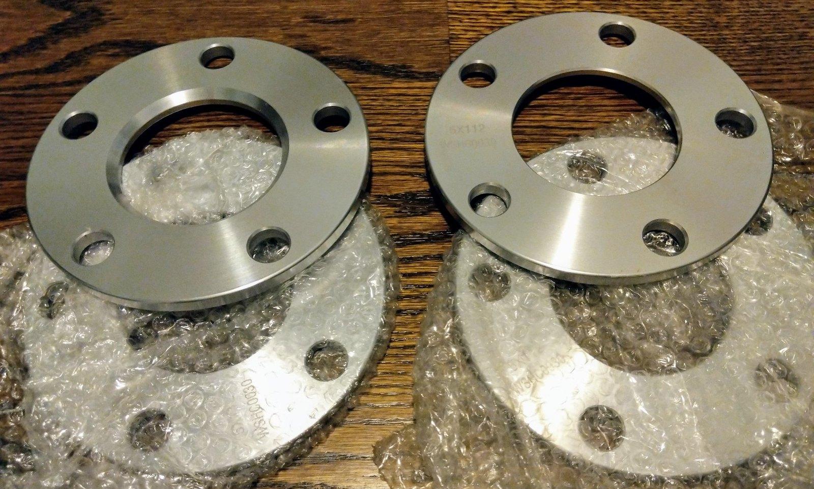

@JakeM The spacers worked out pretty nice. I ordered some 40mm extended bolts and everything mounts up nice with no issues. I've only been able to give them one test day so far since all the races have been cancelled.
I'm still running the stock brake pads for now. They seem decent, but I will see how it goes once the season gets started again. In the meantime, I have a set of RE71 freshly mounted on the stock wheels and awaiting to get some seat time.
I just ordered the AFE Front Sway Bar yesterday. Plan to get that installed and then an alignment afterwards. Other than that, it's just me trying to work on my lines!

7mm spacers all around w/extended wheel bolts

Wheel Spacers - 7mm
