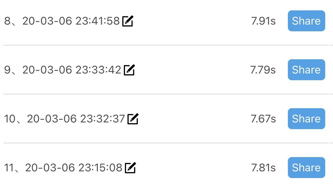

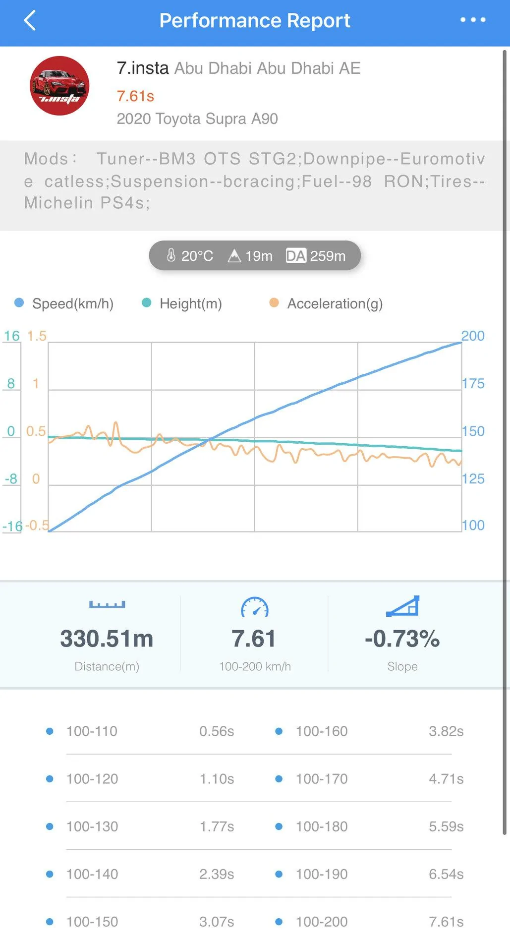

My PR is the below:
all the mods are listed correctly, so literally only had a catless DP from euromotive and BM3 stg2 OTS 93oct map from performance mods perspective, the BCracing coilovers and the Michelin PS4s might have helped a littlie but at the same time am running heavy 20" Vossen wheels which I Believe would hurt the acceleration times
note the outside temp is ~20°C which helped a lot with the car IAT, it's really crucial.
and here is few other runs all in the 7s, notice they're back to back
I would consider all the above timings great runs, but in reality and when the conditions are slightly less in my favor I would get anything between 7.9 to 8.3
also I since have added MST intake and HKS catback but haven't made test runs yet
