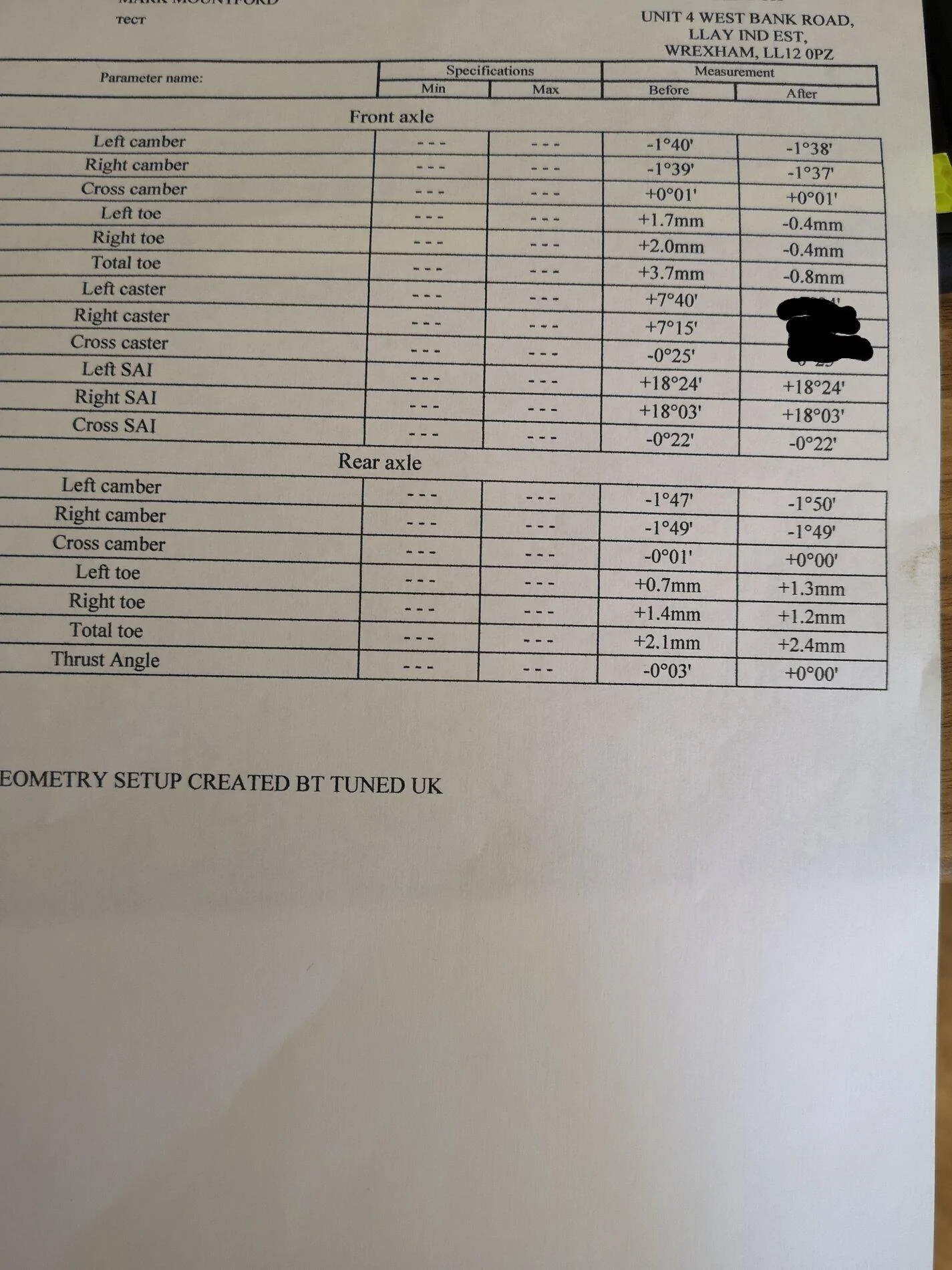

After coming from an extremely well set up GT86 I initially thought the Supra was a little skitty when in a launch or hard acceleration and that it might just be the characteristics of it, but apparently not. On Saturday I took my Supra over to a friend who works on the British touring car circuit as "the suspension guy" and who also has friends racing them in the GT series to check it over as I'd had this niggling feeling since I'd bought it. Well as soon as he'd checked the geometry all became apparent as it was shocking! the rear wheels had a toe in of over 2.5 but not uniform and the front were 3.7 again not uniform also a castor was over half a degree out,. Anyway he got to work and corrected all the issues and now the car is simply awesome, it corners better than my 86 ever did and when I launch it it's as straight as an arrow, it's made such a huge difference.

Do you know what he set the geometry up to?

My stock alignment was unequal in the front with a slight toe out, the rear had .03 left and .26 degrees right toe out. Fixing those made a huge difference in feel, and alleviated the rear shift on hard acceleration and cornering.

Just FYI, this is nothing new for the Supra (unfortunately). Many people are finding the same exact toe in numbers you found...
