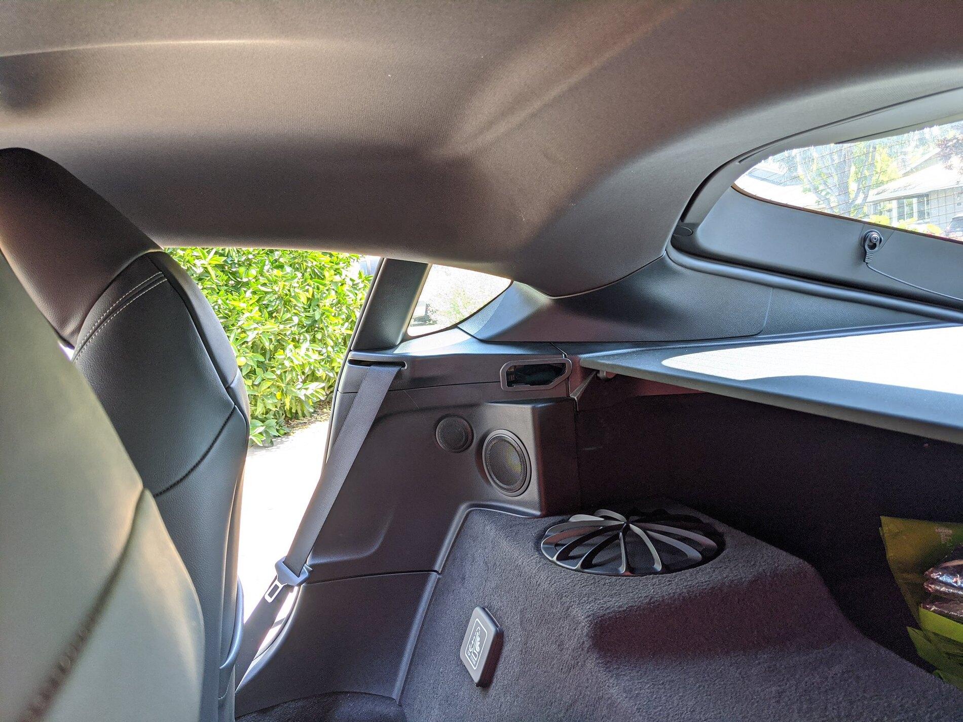

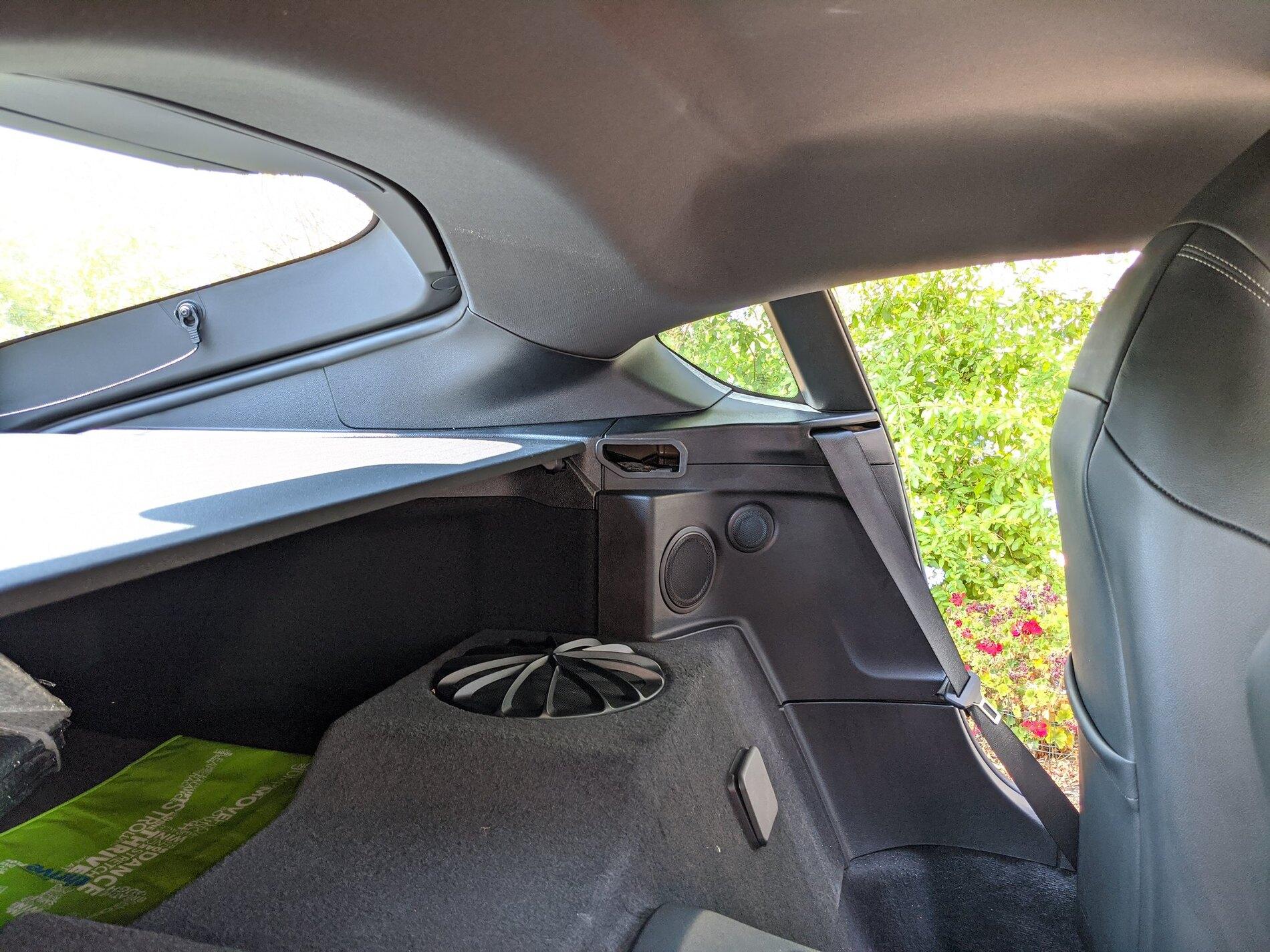

Threw out the back again. Needed to recline more, but the stupid aluminum brace going across the trunk opening wouldn't allow it.
Guess what? It's most likely not a brace at all. It's probably only Cosmetic and is easily removed.
tl:dr: Remove aluminum cross bar piece, gain 2 inches of backwards movement on seat and about at least 1 extra inch of tilt back. Or 3 inches of tilt back and 0 inches of leg room, etc etc.
For reference I am 6'2", with a 34" inseam, 34" waist, and about 205 lbs.
Disclaimer: use at your own risk. I am not a Toyota engineer and am only making assumptions about the removal of this part and whether it will affect the structural stability or any other functionality of this vehicle. Use your own judgement.
TRIM-1 by , on Flickr

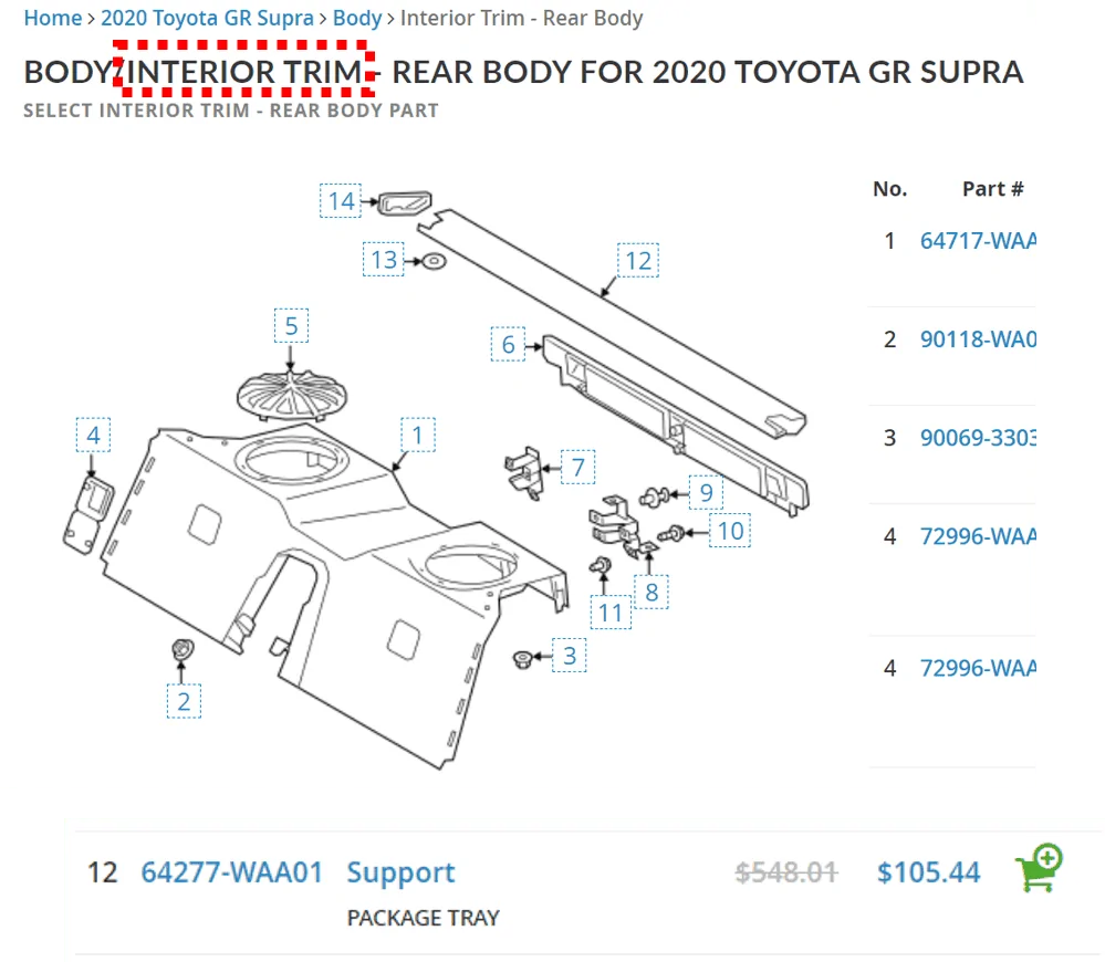

The piece in question is shown in the Microfiche as a "trim" piece.
I thought it might be structural, but then I noticed the odd shape and no place to put a couple bolts. It would generally need 2-3 bolts if it were a structural member (think strut tower braces)
TRIM-2 by , on Flickr
https://toyotaparts.mcgeorgetoyota....-engine/body-cat/interior-trim-rear-body-scat

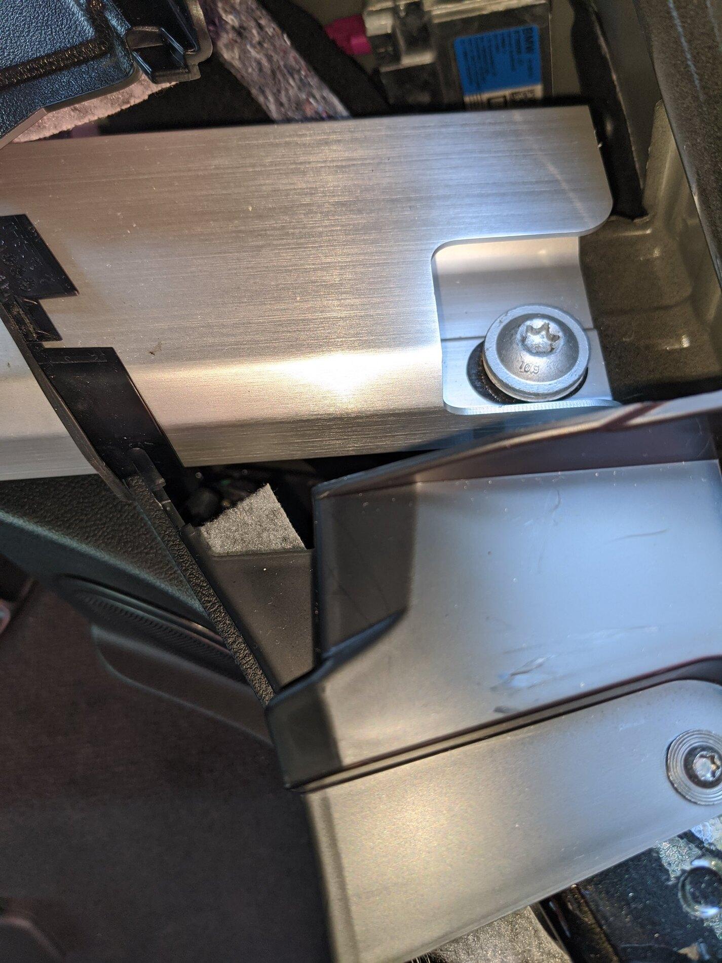

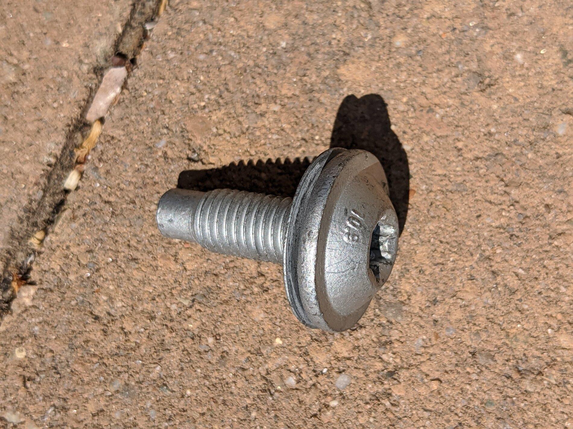

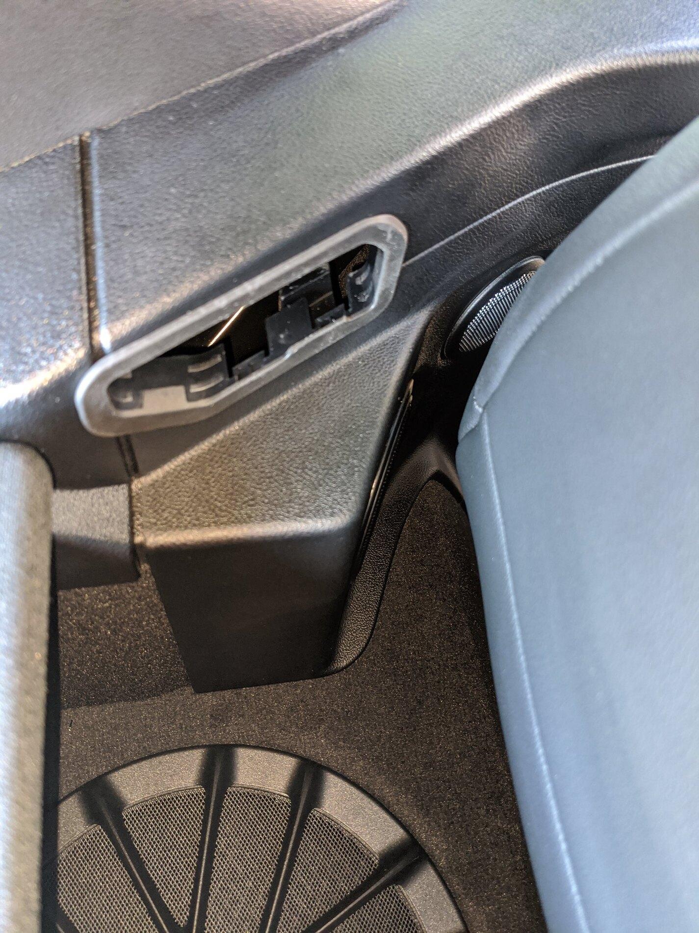

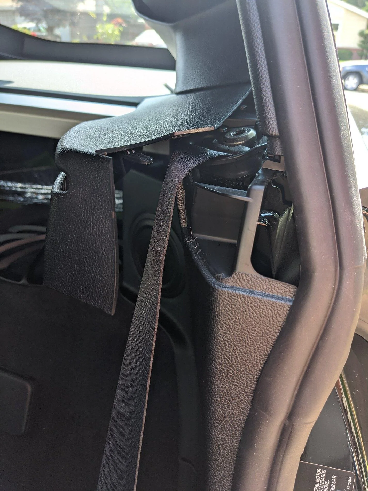

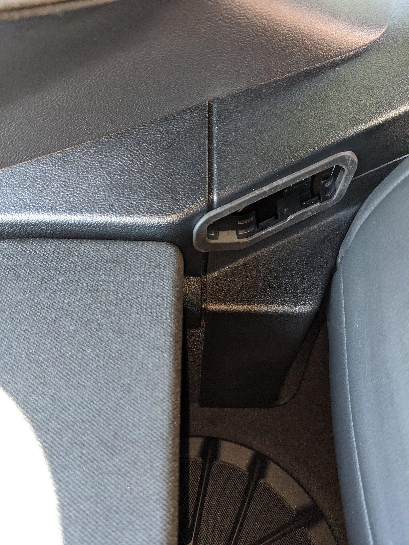

Decided to pop off the seat belt cover trim pieces and lo and behold, it's only held in with a single bolt on each side. Not only that but the bolt goes into a plastic grommet designed to allow it to slide around inside as the body of the car flexes. All this points to it being a non-structural member:
IMG_20200903_114903 by , on Flickr
The plastic grommet to allow the bar to slide back and forth as the chassis flexes around it...
IMG_20200903_115419 by , on Flickr
The bolt has a washer on it as well to allow the bar to slide back and forth:
IMG_20200903_115428 by , on Flickr

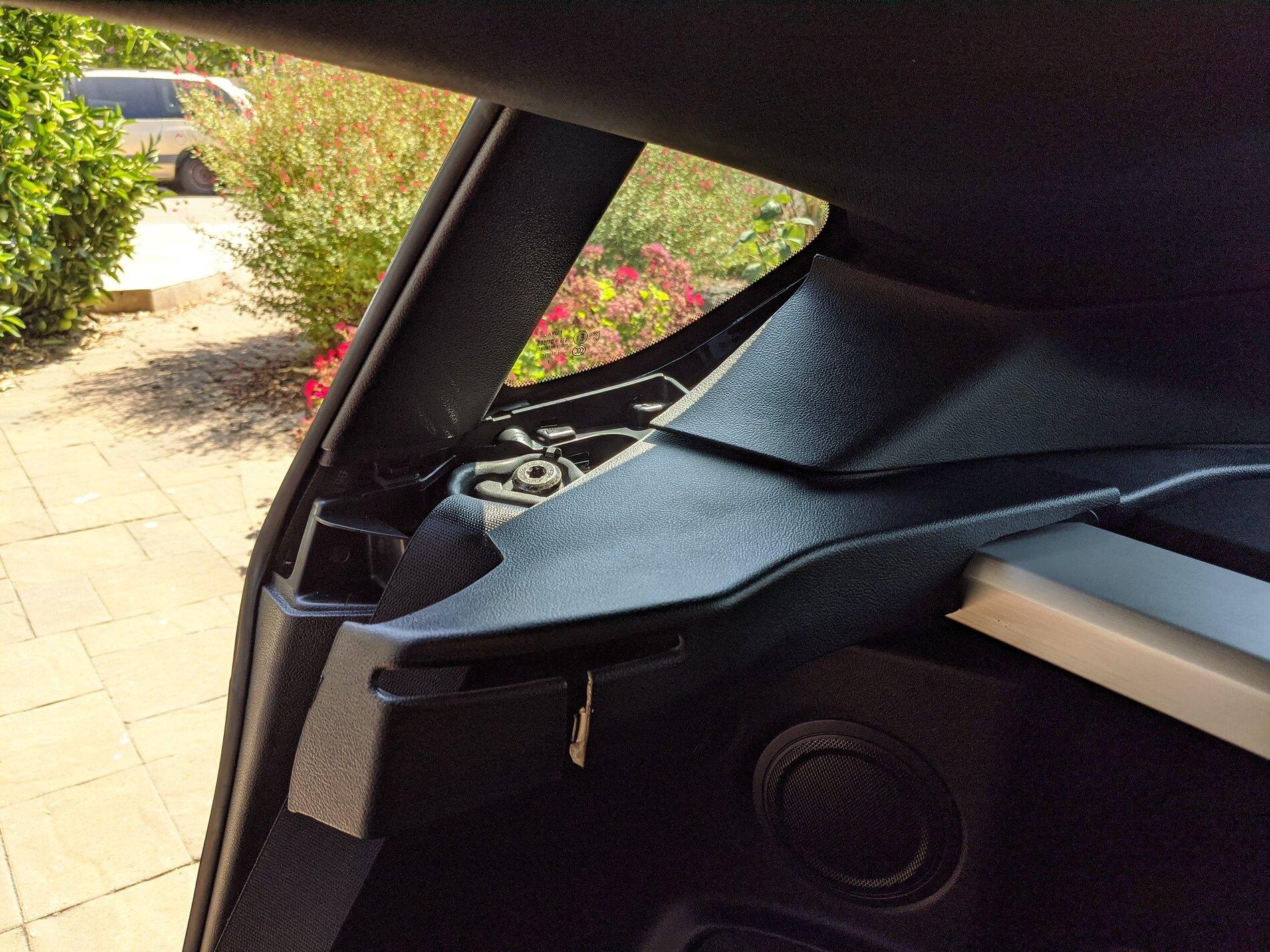

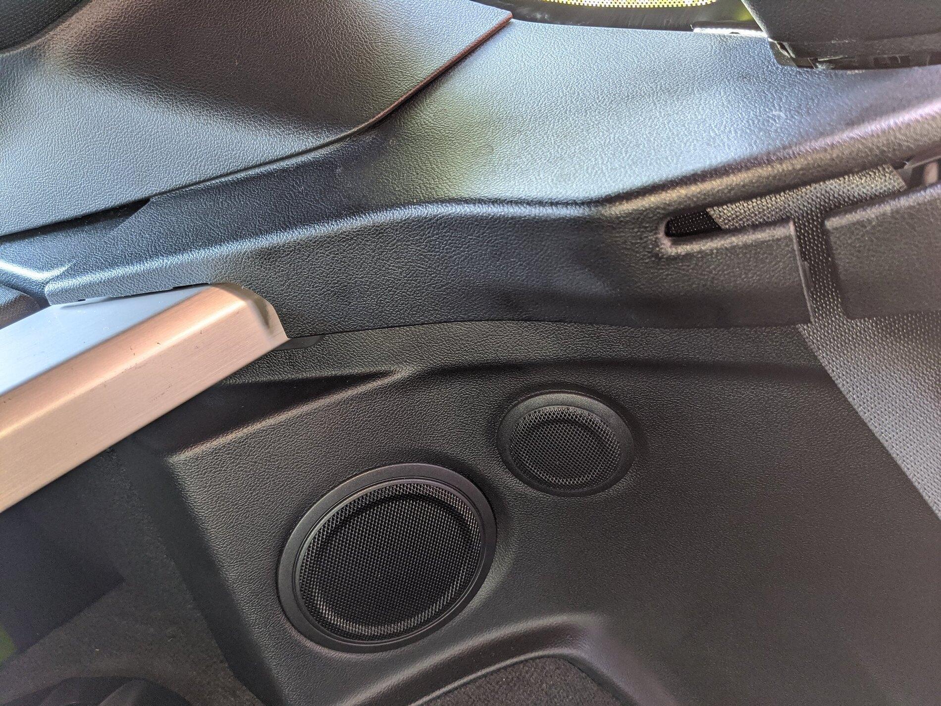

It was pretty easy to pry off the trim pieces, just start under/near the seat belt hole and pry up and inwards working your way back towards the bar. At some point the whole trim piece and the attached one for the C pillar will pop out:
IMG_20200903_114851 by , on Flickr
IMG_20200903_114844 by , on Flickr

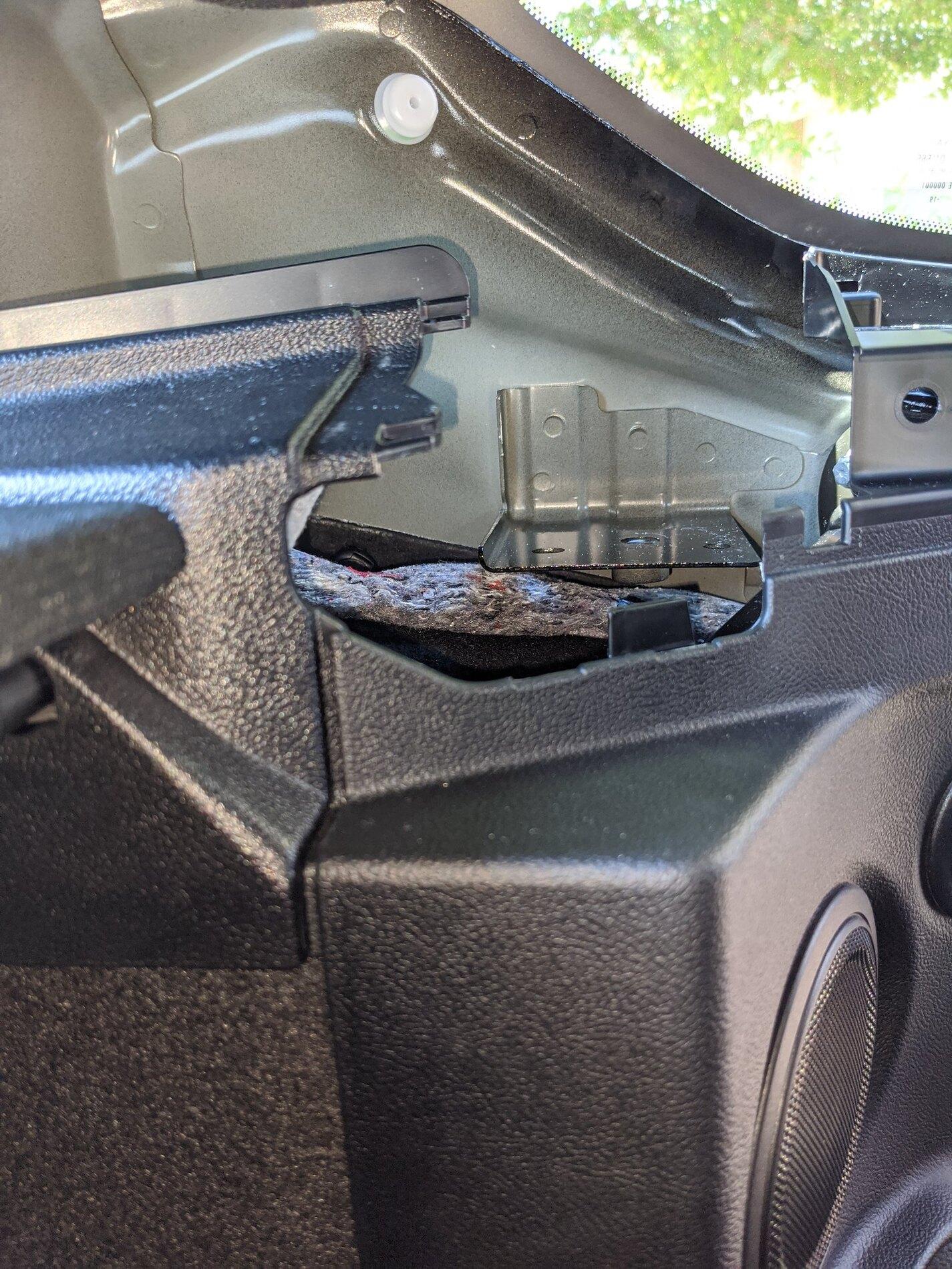

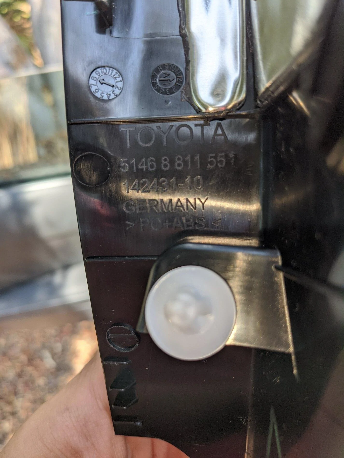

Ah, finally a Toyota branded part in the car:
IMG_20200903_115450 by https://www.flickr.com/photos/190043662@N04/, on Flickr

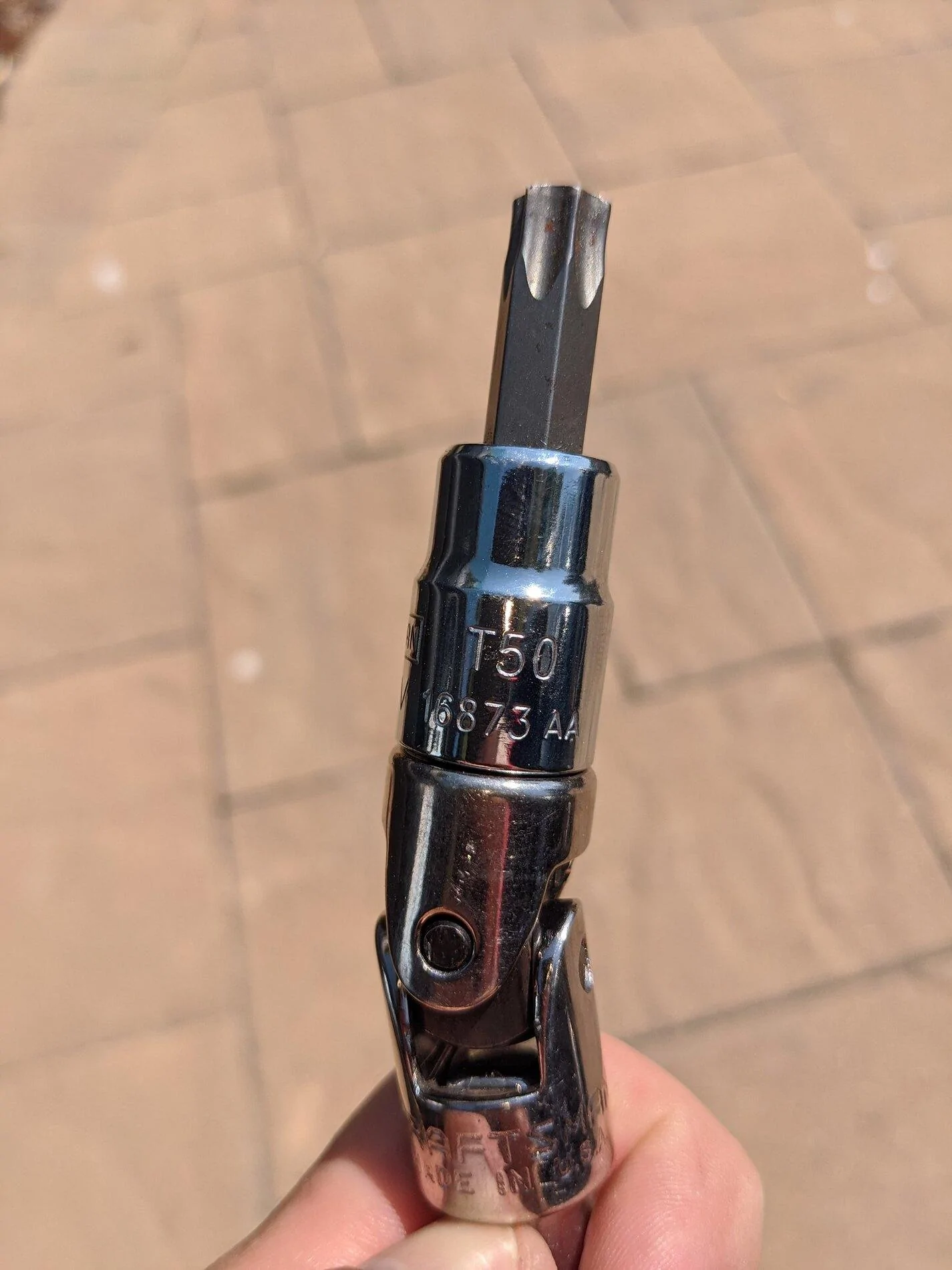

A single Torx T-50 driver (with a universal joint and extension if you want to get fancy) on either side is all it takes, and I'd say it wasn't torqued to more than 10-15 ft-lbs. Came loose much more easily than I expected:
IMG_20200903_115157 by https://www.flickr.com/photos/190043662@N04/, on Flickr

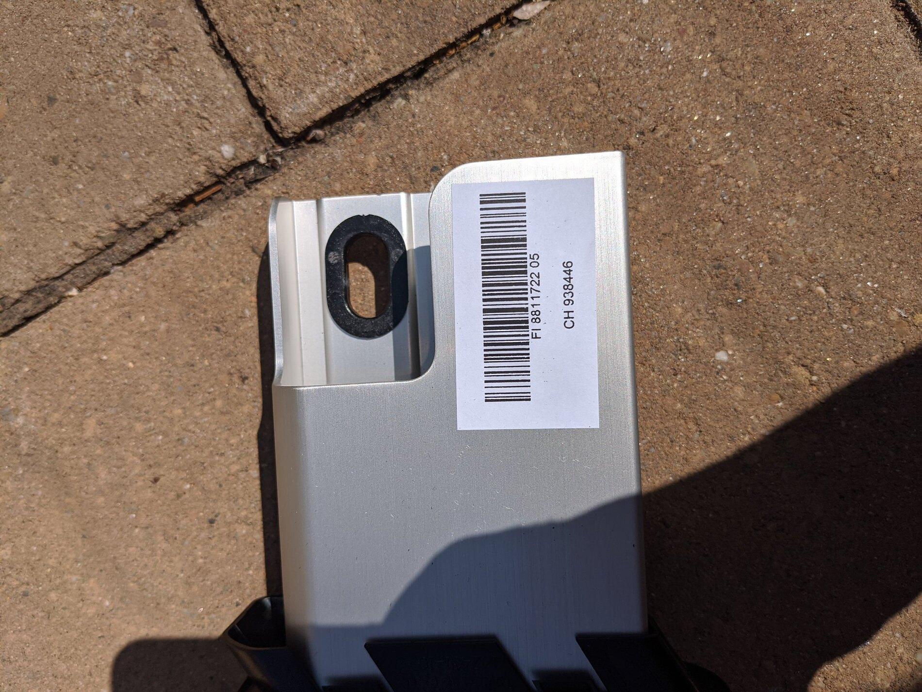

Pop the bar out:
IMG_20200903_115751 by https://www.flickr.com/photos/190043662@N04/, on Flickr

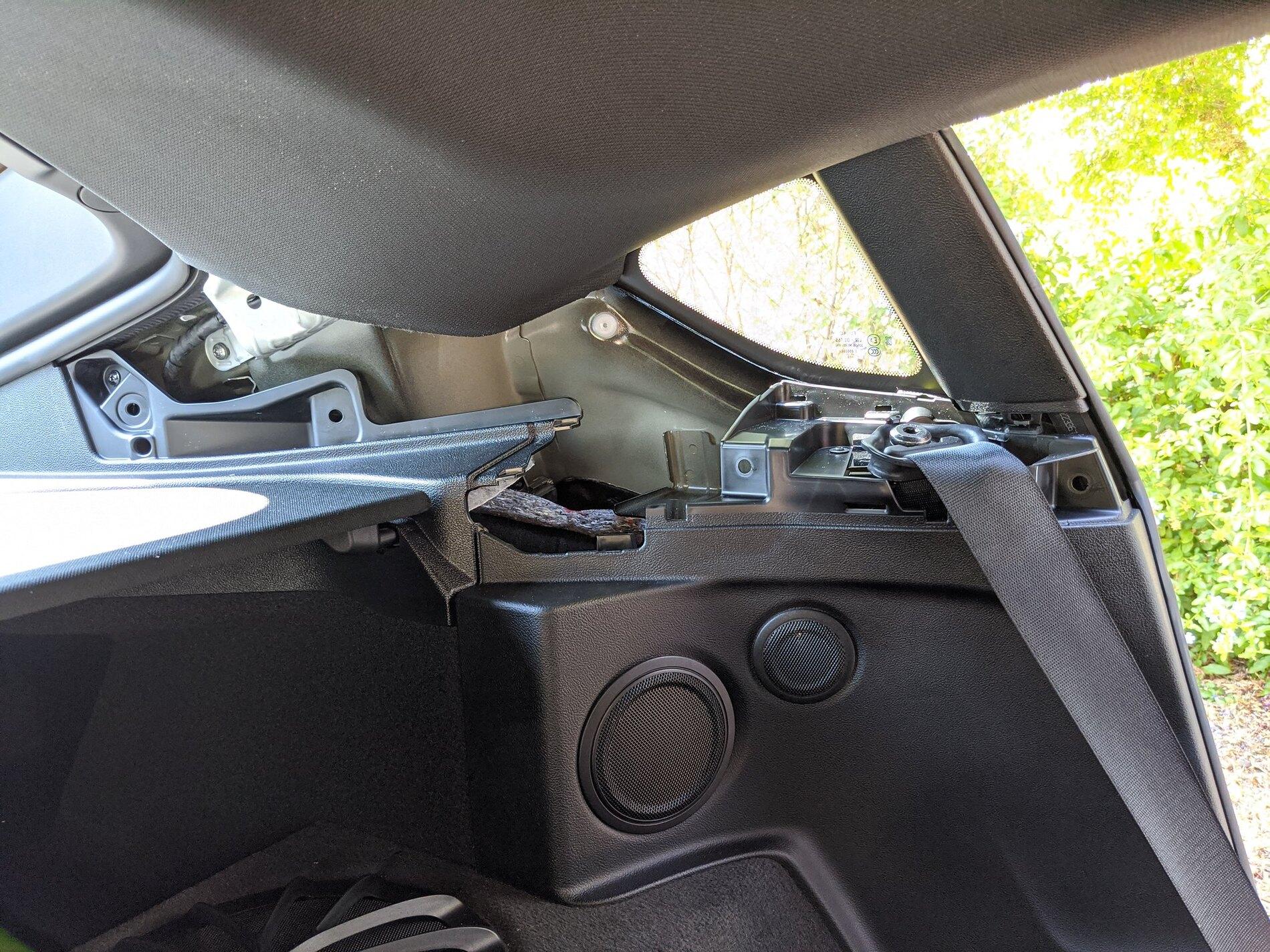

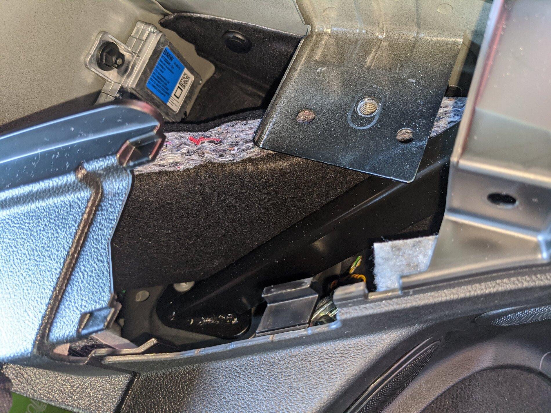

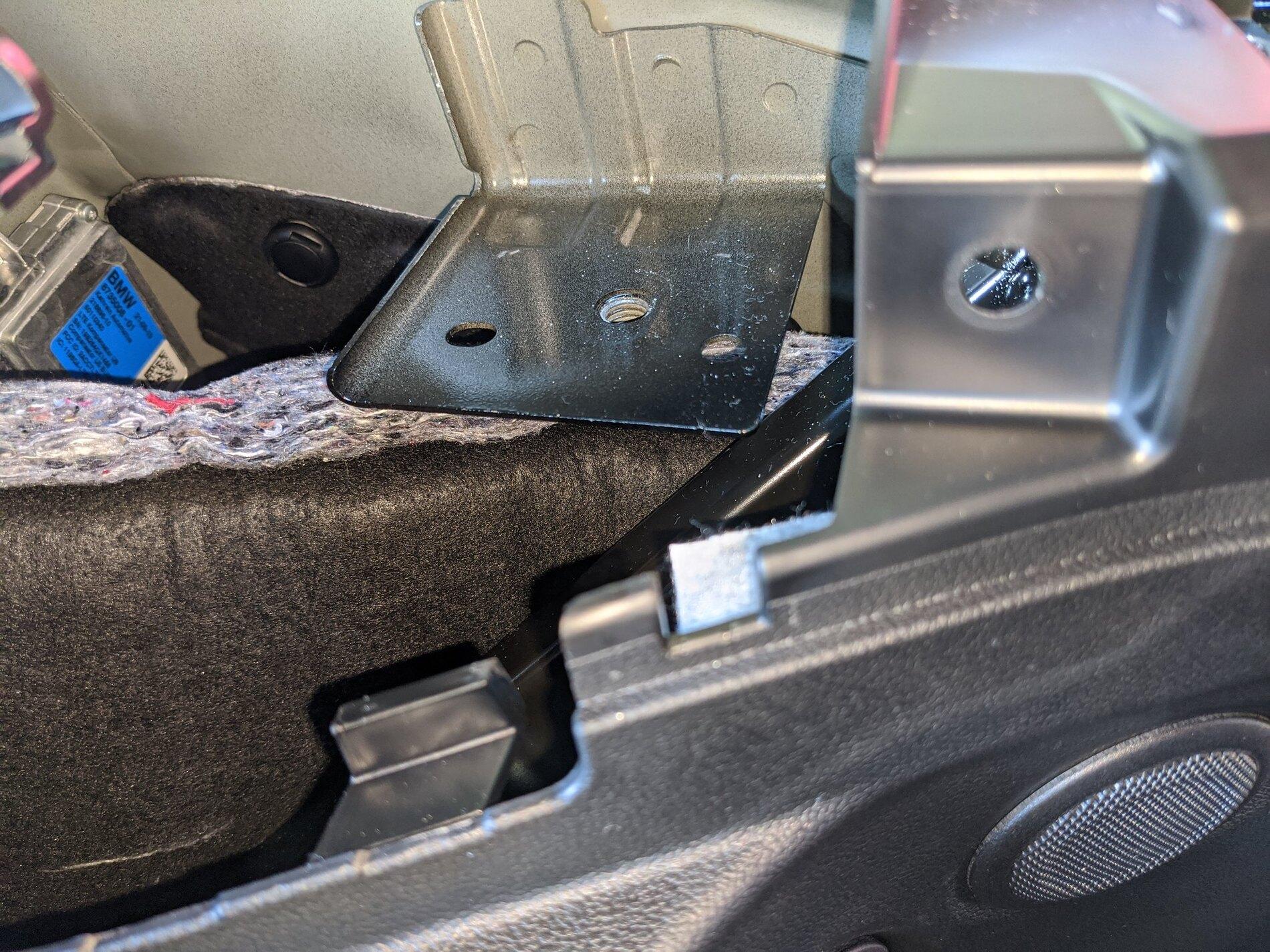

And we're left with a flimsy looking bracket that was used to support it. I really hope no one hooks up a seat belt harness to this thing. It looks like it isn't designed to really take much load at all!
IMG_20200903_115540 by https://www.flickr.com/photos/190043662@N04/
IMG_20200903_115608 by https://www.flickr.com/photos/190043662@N04/
Also some sort of electronic module visible from here:
IMG_20200903_115534 by https://www.flickr.com/photos/190043662@N04/, on Flickr

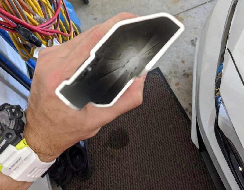

The bar in question: thin walled extruded aluminum tube:
trim-3 by https://www.flickr.com/photos/190043662@N04/, on Flickr

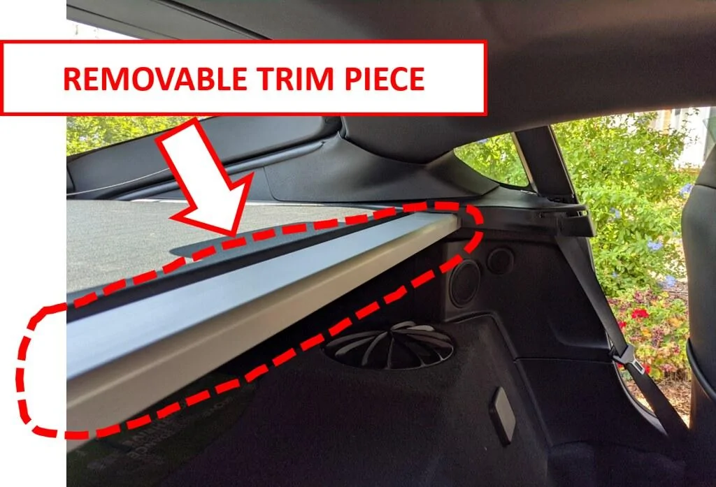

New maximum recline / rear position of seat. But maybe that black plastic trim piece is removable as well...?? Maybe next time....

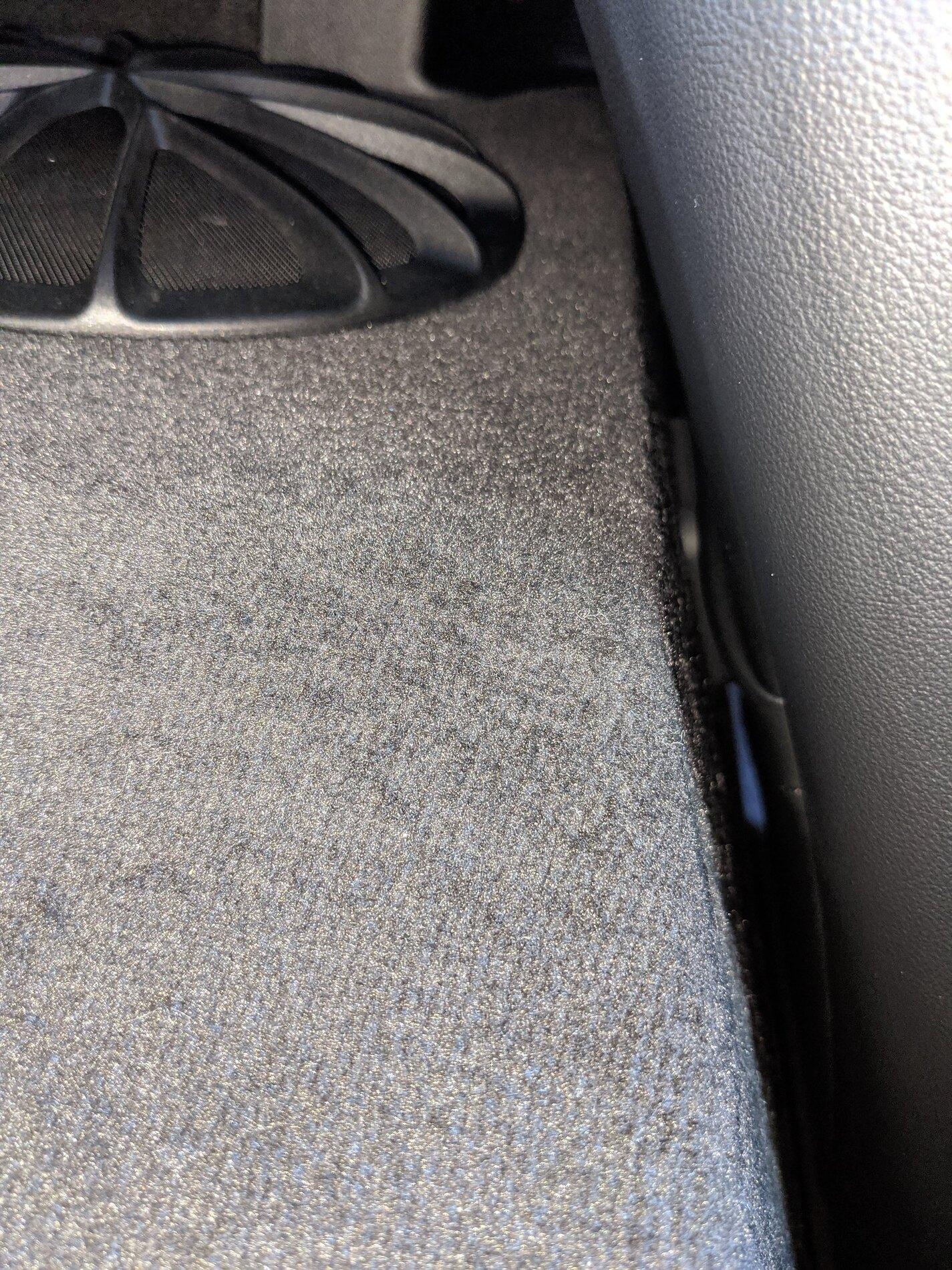

Somehow there's a lot more leg room that is accessible as well, more than it looks from the picture above.
You can get right up against the chassis tub now:
IMG_20200903_120550 by https://www.flickr.com/photos/190043662@N04/, on Flickr
