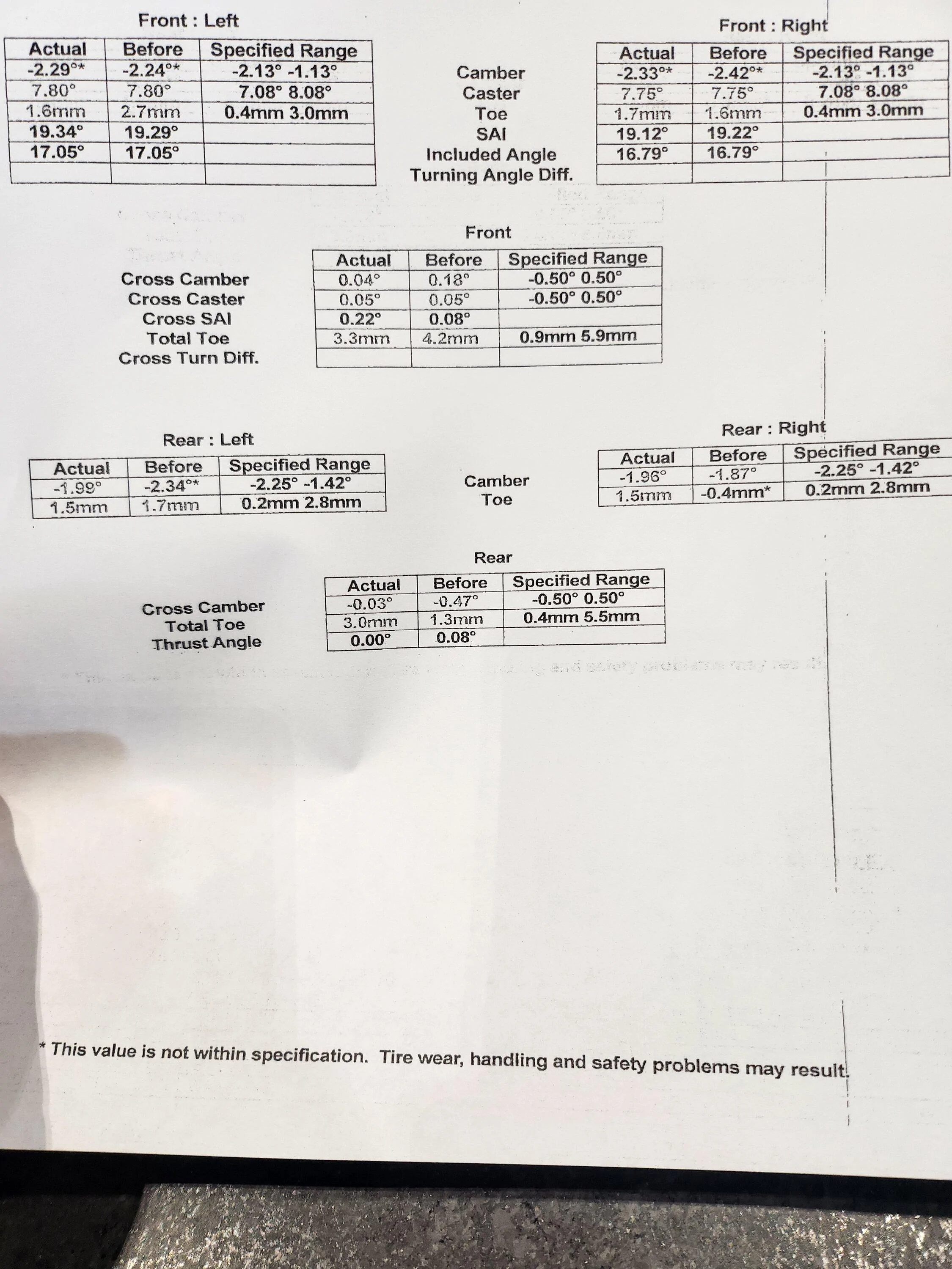

This is after I was told my tires were feathered, so I went to get an alignment. So does the alignment look good now? or what would you recommend any adjustments? But yea definitely in front.

Toe then. Zero it out in front.

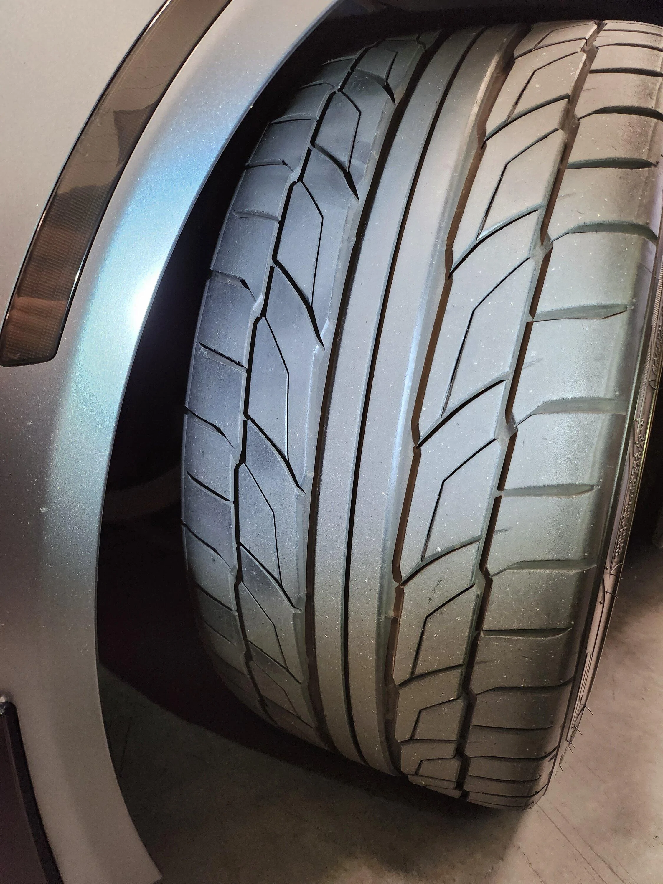

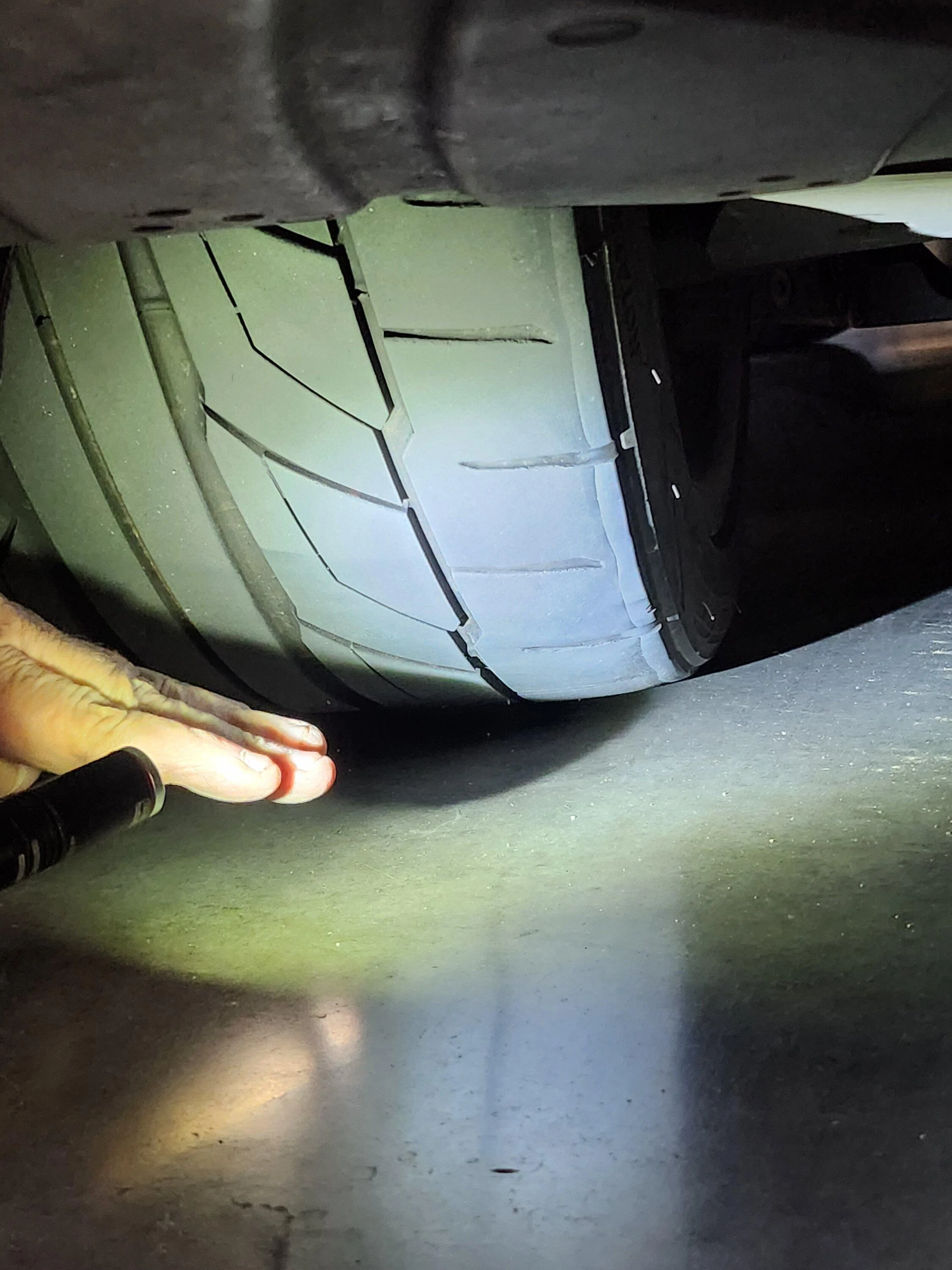

Do you happen to have a photo of the wear?
So yea definitely the insides, goes dark spot, light spot, higher, lower and the rear insides are wearing...

Yea, assuming you are running normal tire pressure, that looks like toe wear.
What @nibble was referencing is from over driving a tire on track, which doesn’t apply to you, and that shows up on the outside edge anyway.

So I should adjust the toe to 0.0? what specs for alignment would you recommend for the rears? I know that I cant fix my current tires, but if I adjust my current specs to get a little more life out of the tires would be awesome.
