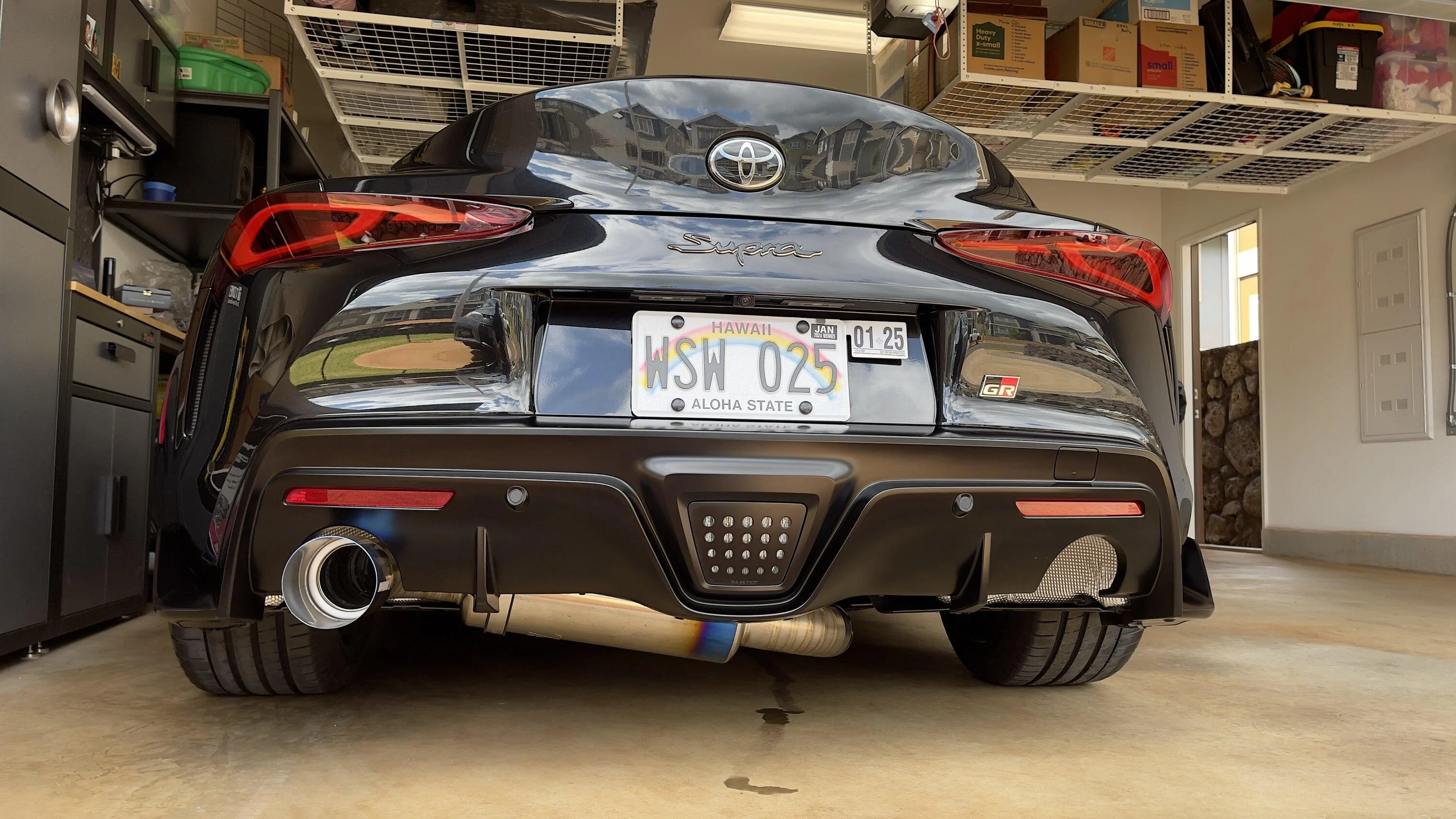

I installed the Tomei Type R last year on my 2023 GR Supra 3.0 Premium. No CEL.

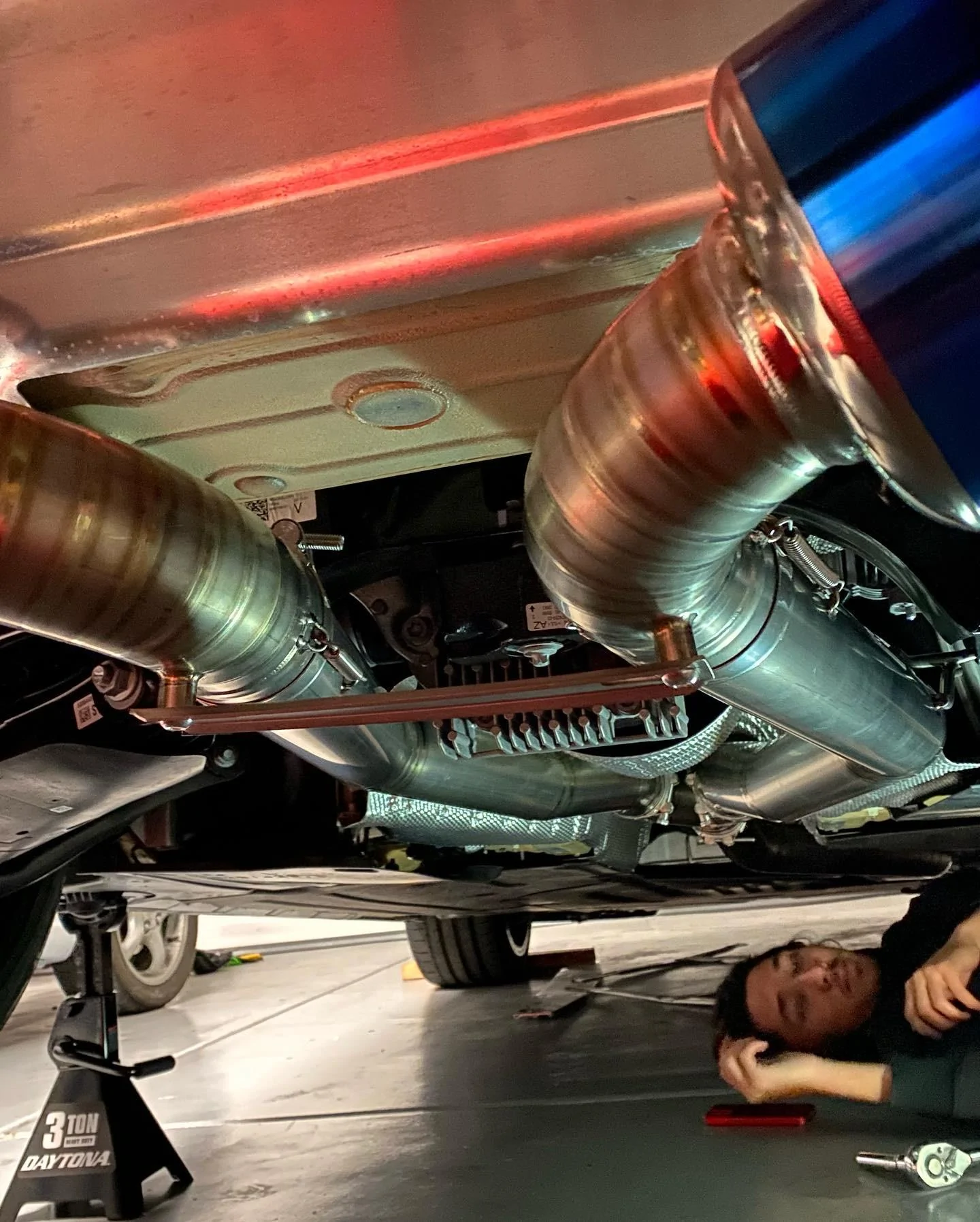

What’d you do to the valve sensor? Did you just tuck it in somewhere?
Yes, I covered and zip tied the valve sensor underneath where it cannot get wet. The angle of the muffler making it look low is by design to show off the nice bluing of the titanium. Its lowest point is the same level as the lowest point of the differential fins. Type R fitment is perfect. The Type D fitment is the one that is supposed to be more challenging. I chose the Type R as an homage to the MKIV. The sound is more throaty, more aggressive than stock. Do not upgrade if you are concerned about cabin noise. The entire kit weighs 11 pounds versus the stock which is 60-70 pounds. No issues. No cracking ............. so far.
