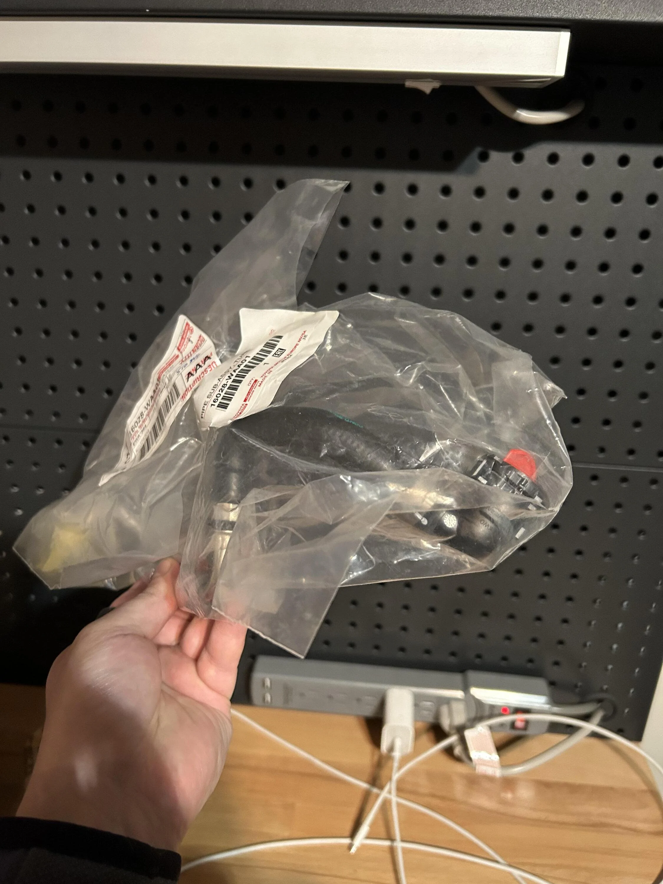

I snapped this hose on the turbo inlet pipe when removing it to install an aftermarket one. Can anyone help me determine that part number for replacement? I think it might be this one, but really not sure: https://parts.toyotadm.com/oem-parts/toyota-inlet-pipe-16027waa02
Searching the numbers on the tag hasn't gotten me anywhere. Appreciate any help!

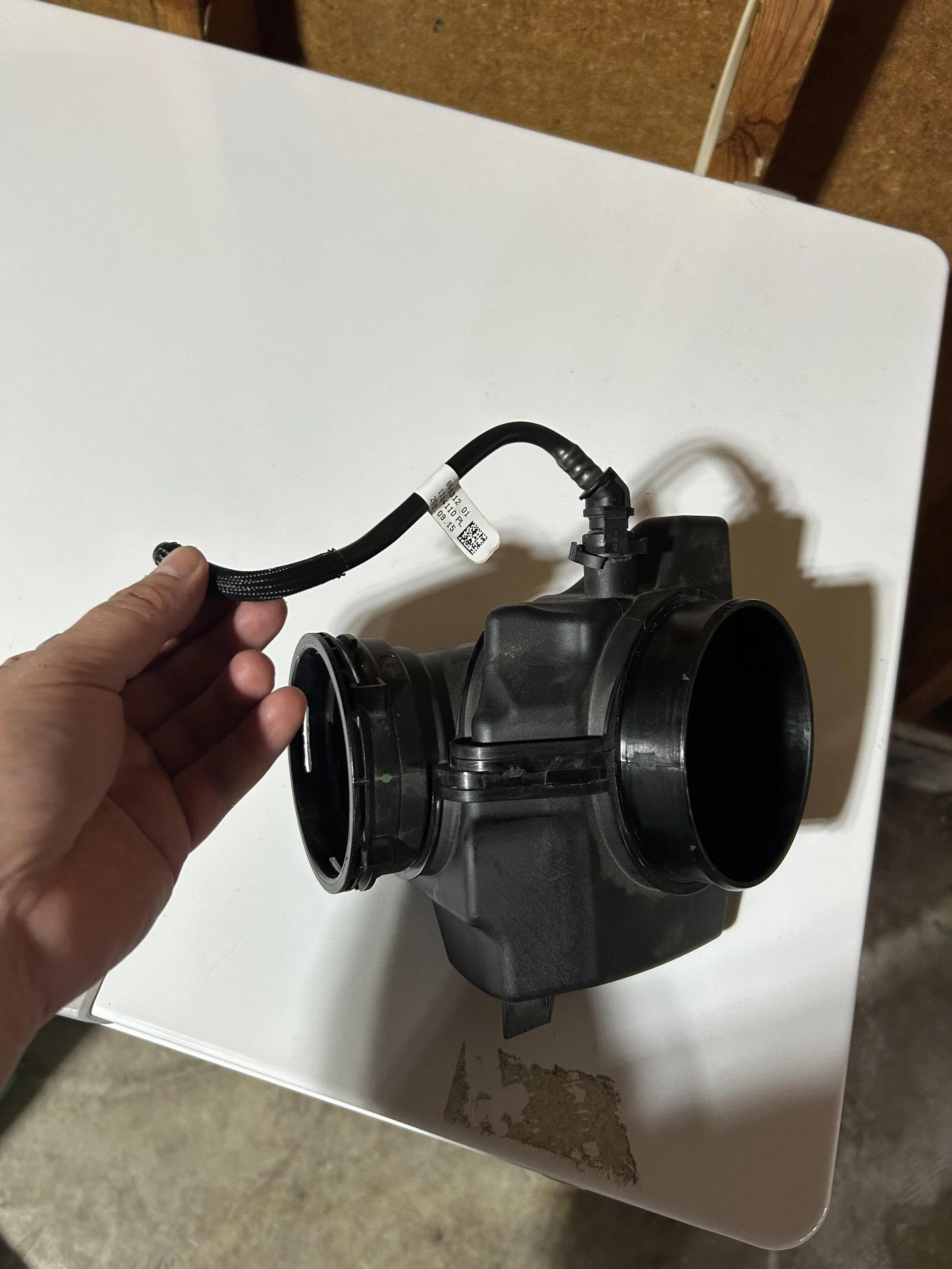

Ok, that turns out to be a different part. Kind of difficult to see through the packaging but the hose width is entirely different, and the connector is as well.
Any other guesses? I guess I'm going to try just taking my damaged part into the dealership tomorrow.

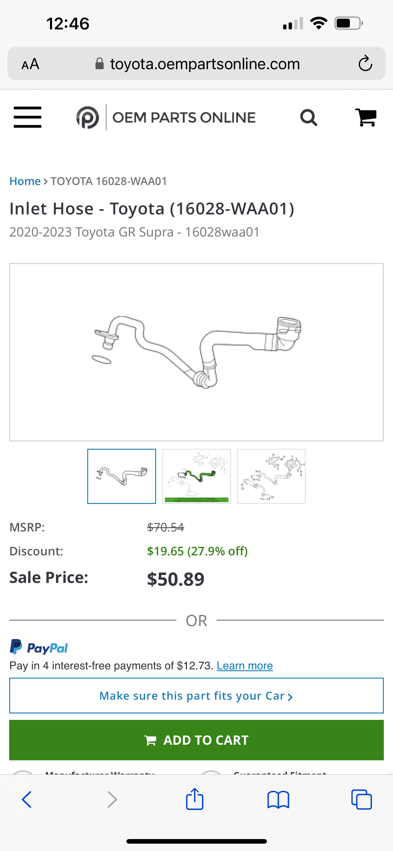

8,828
17,320

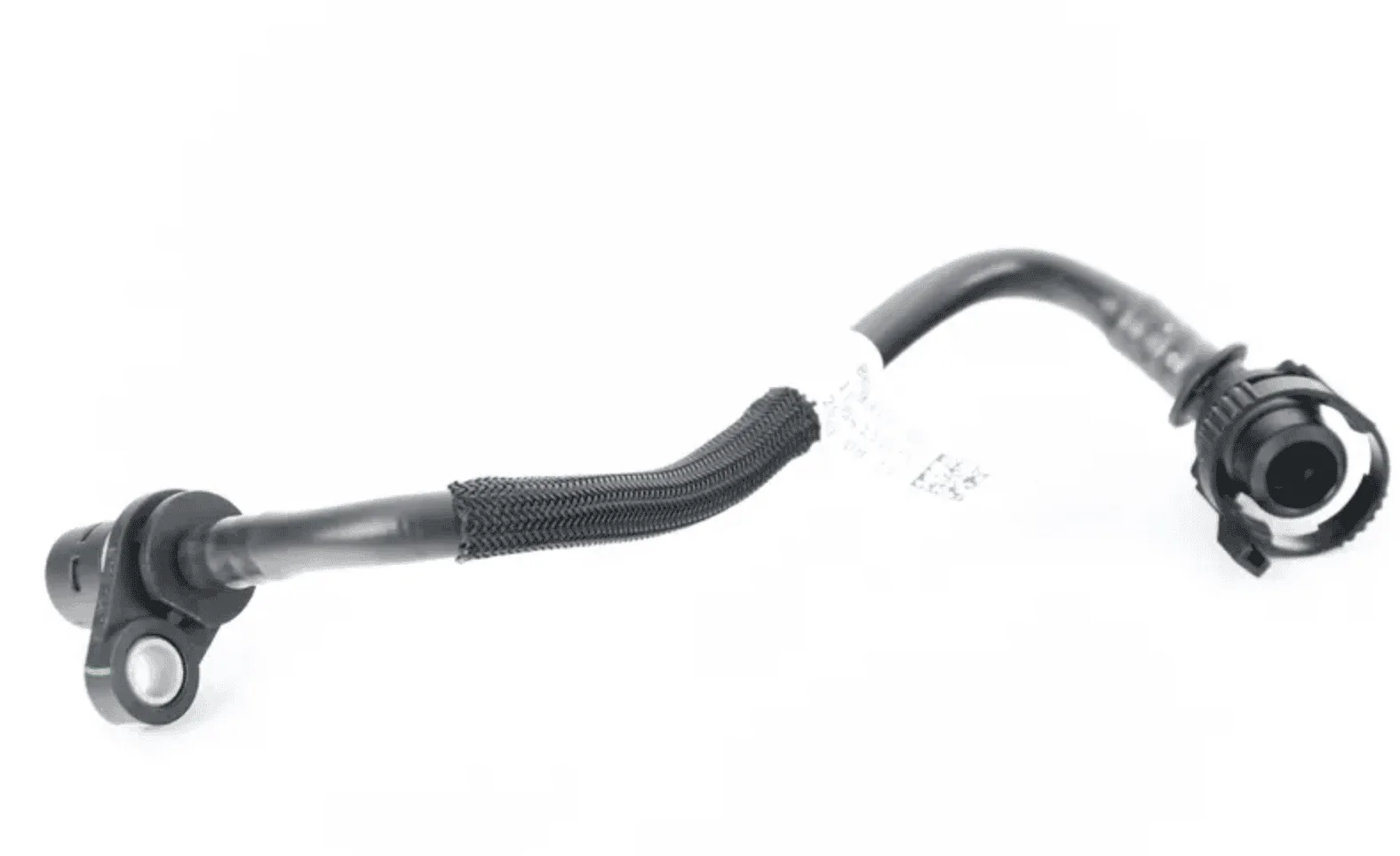

BMW 11158699312
or
Toyota 12262WAA03
The part you ordered is for the intercooler coolant pump.

Ah, that's definitely the one. Thanks!
Just curious, how'd you find it? The number doesn't match the tag. I thought I had searched pretty extensively on parts sites, although I didn't know exactly how to call/describe it.
8,828
17,320
I have my sources and a general knack for finding things. ?
I’ll share once I get back to my computer.
It's a common part that people breaks when installing intakes. It's showed up dozens of times on the forum.
