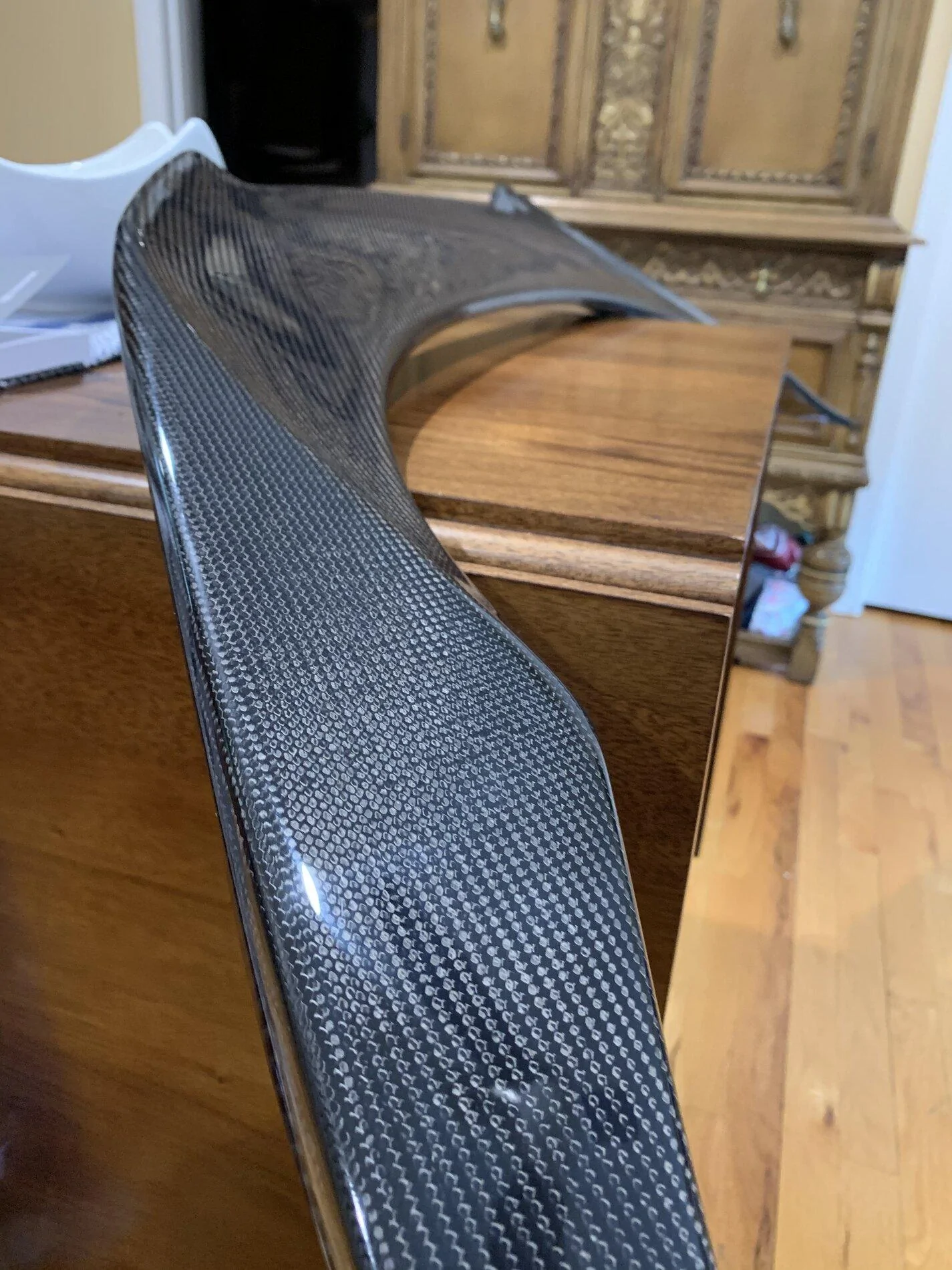

Anyone have this spoiler? How is the quality and fitment?
VQ Carbon Spoiler
I thought of getting the AUTOTECKNIC spoiler but they have had some bad reviews on here.

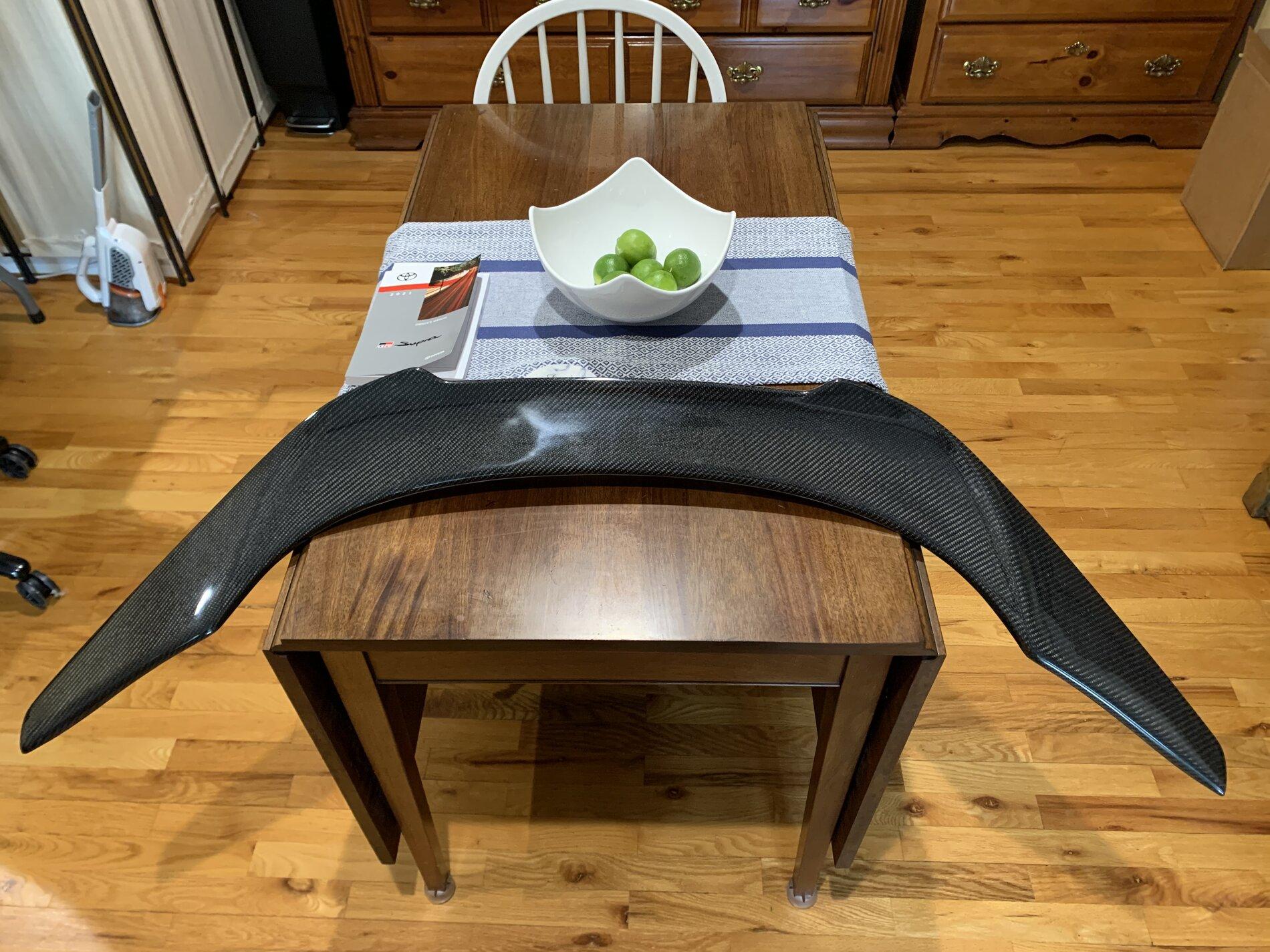

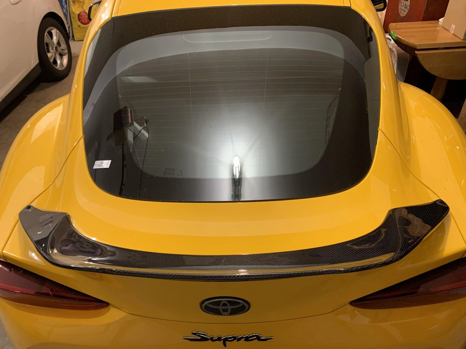

Well they certainly ship fast and it looks great. Some very minor imperfections but I’m very pleased with it.

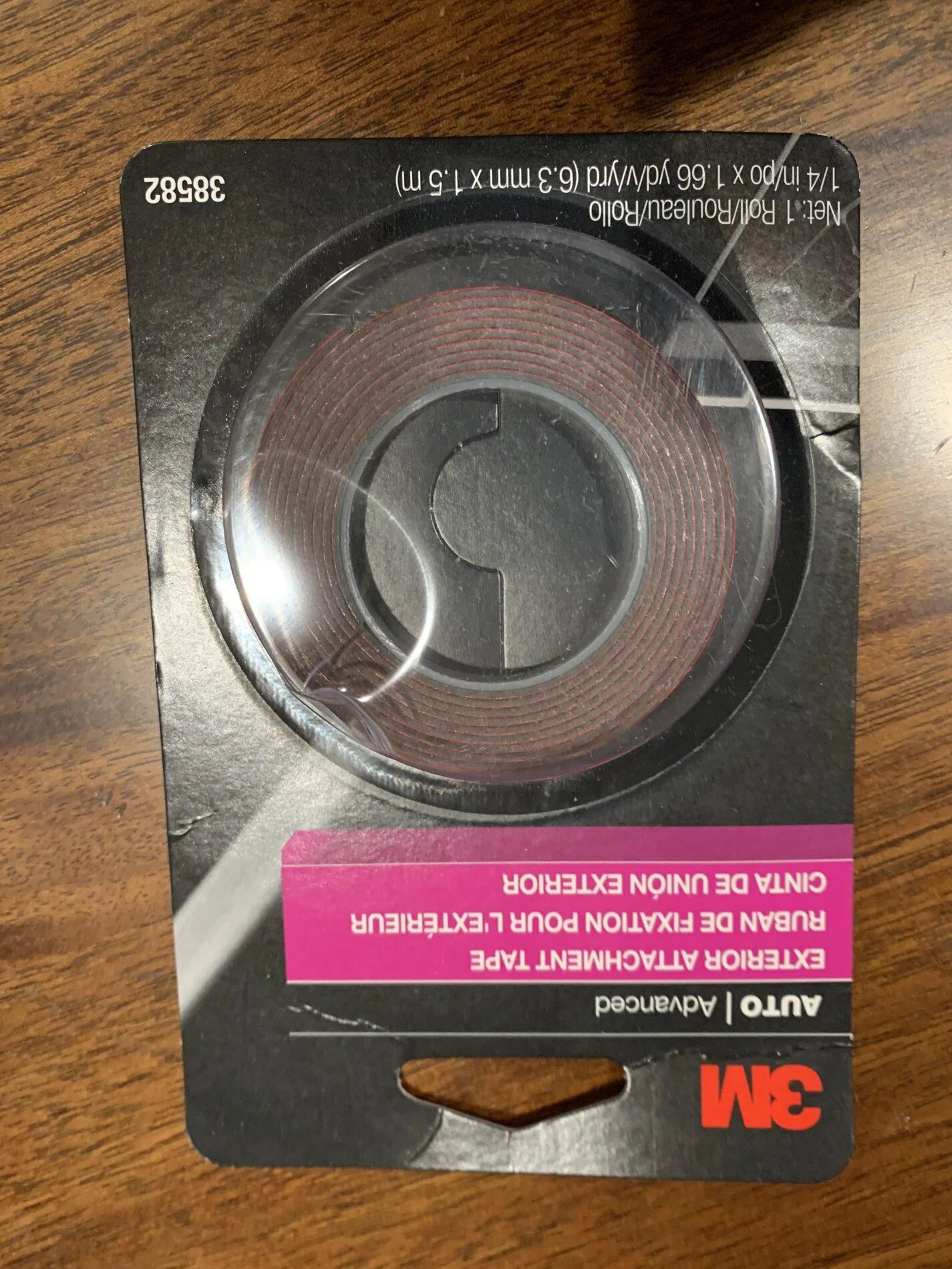

Now for you all who have put on spoilers. Is this going to be enough tape?

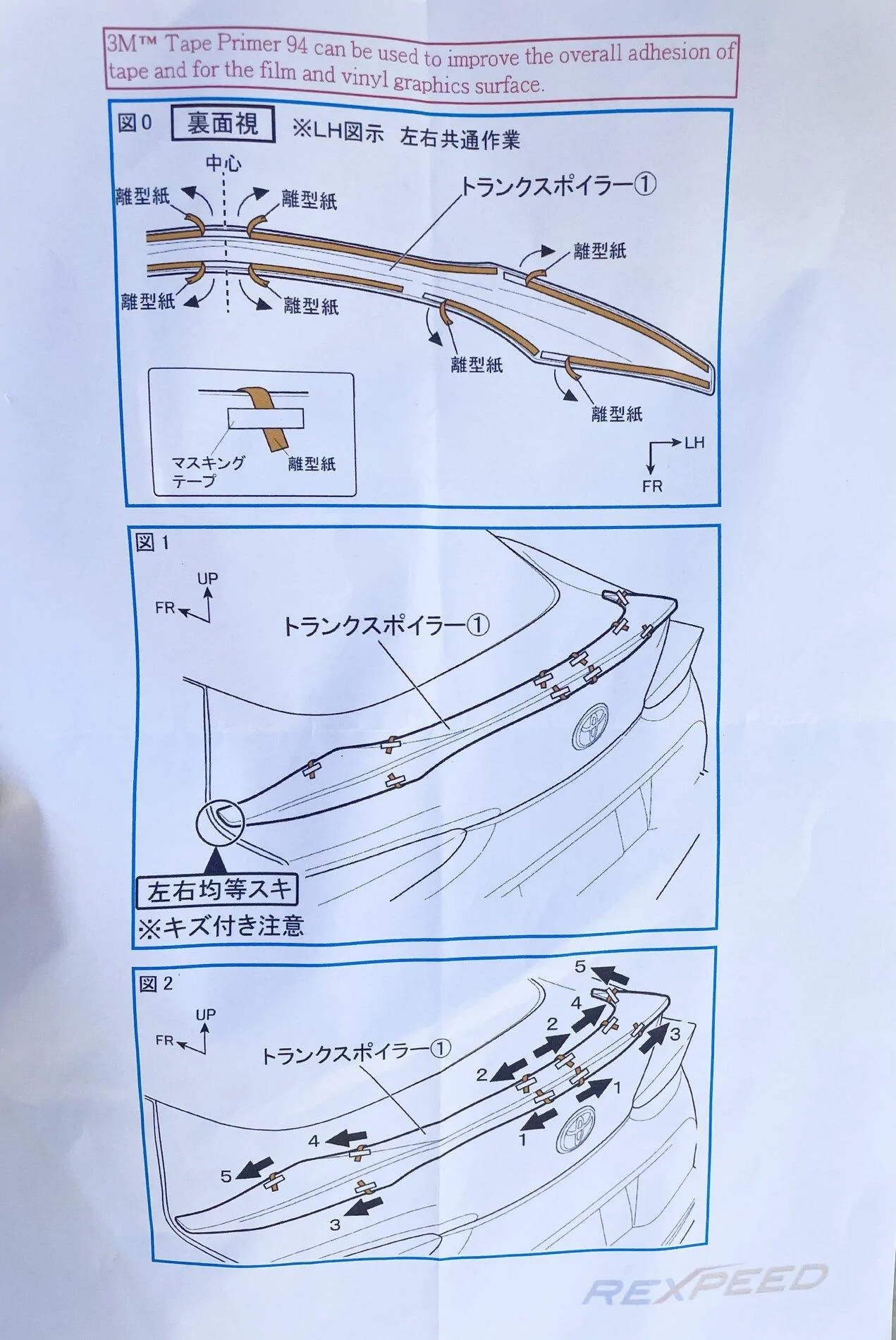

Here is a rough outline for the tape layout. Your pic looks about the same amount I received from Rexpeed.

Well failed miserably on the spoiler install I must not have gotten the tape close enough to the edge and it didn’t stick at all.
I’ll have to get more tape and try again.

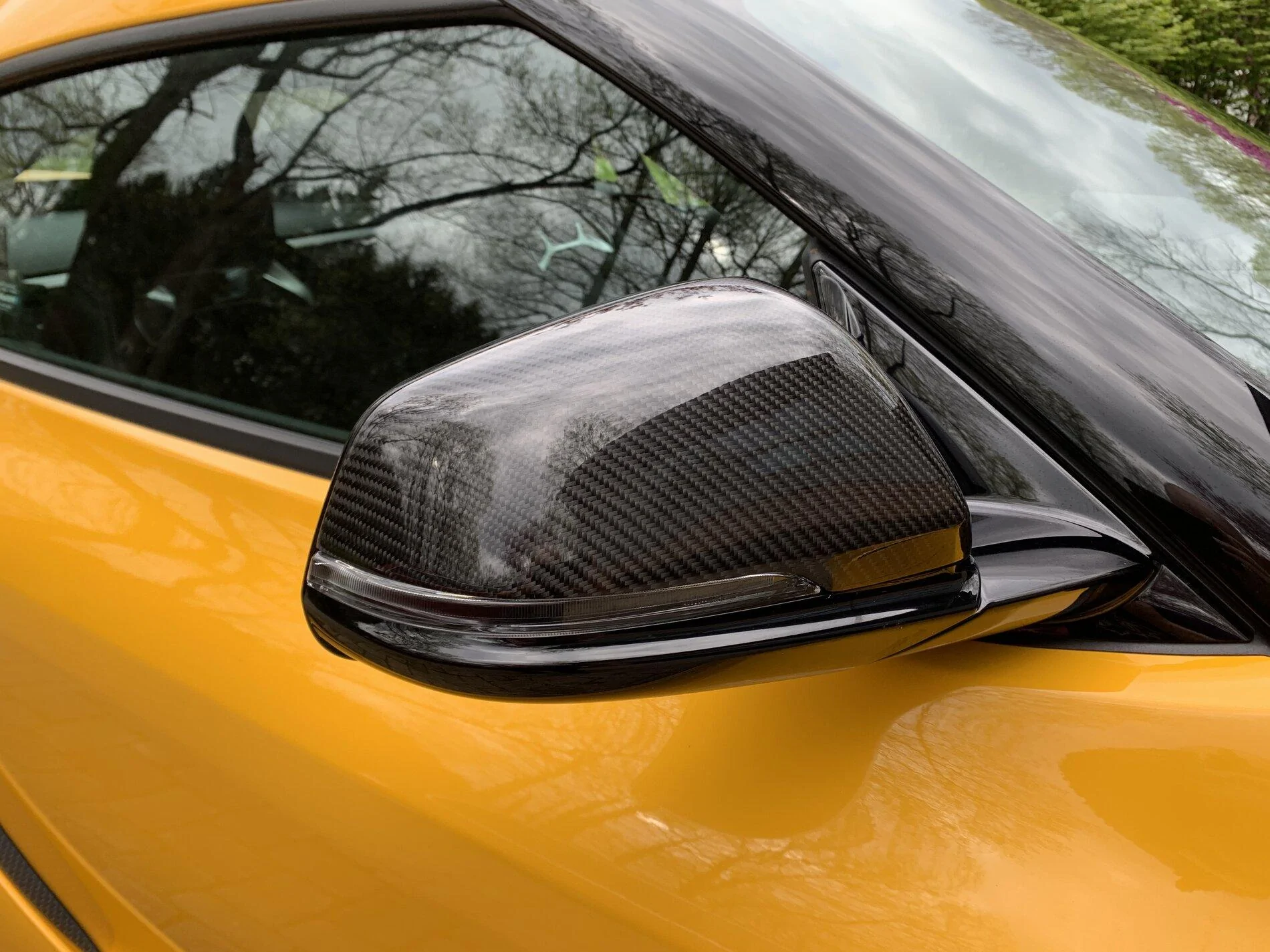

mirror caps were much easier.

Those mirror caps looks really good though. Now you just need the Verus wind deflectors to compliment them.

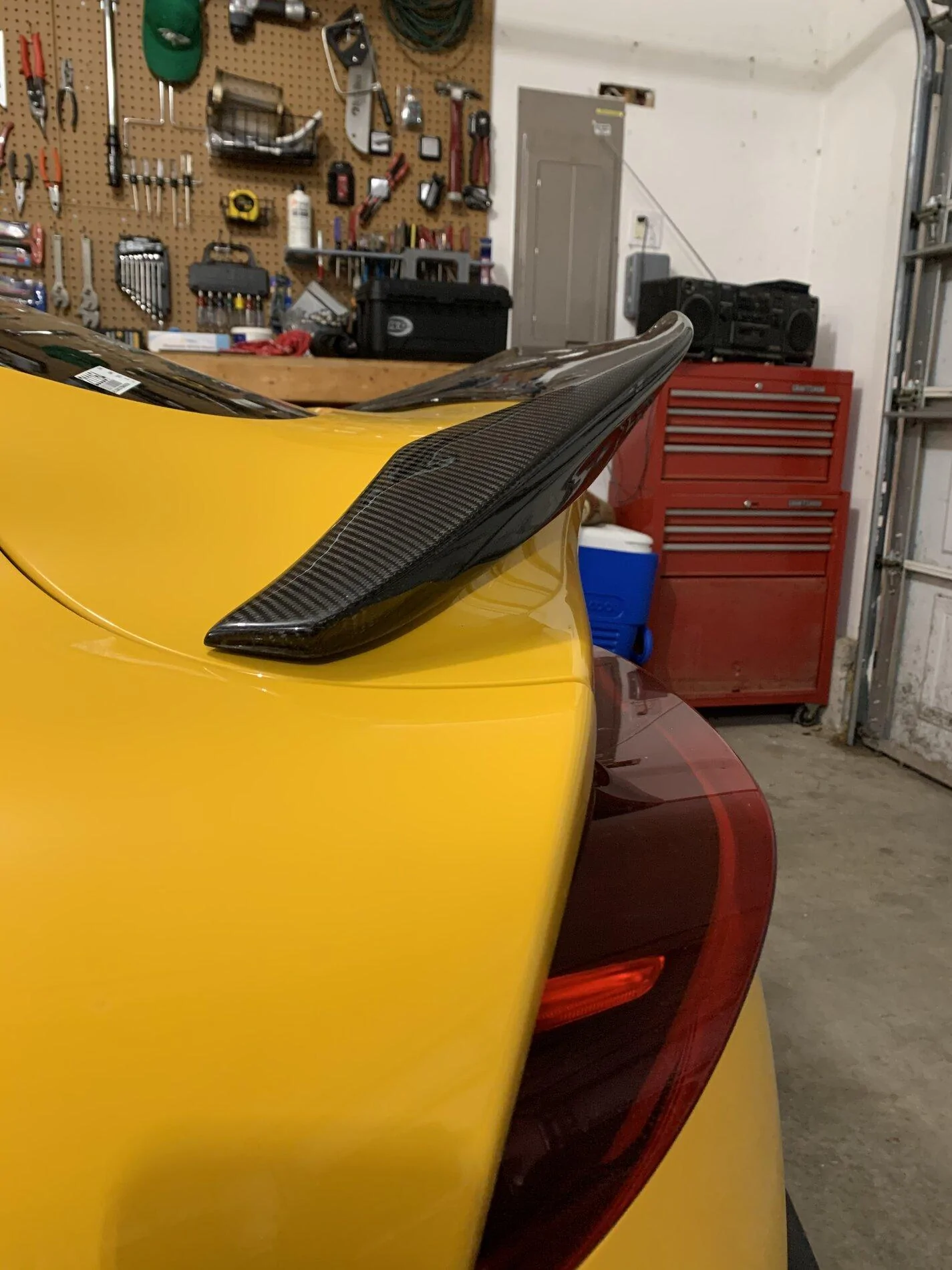

Update on the spoiler. I had a local shop do it and ended up leaving it for 3 days to fully cure the tape. Drove it a few times and then put a package in the trunk and the whole thing quivered and was loose when I closed the trunk.:mad: $150 for install and Uber there and back. :thumbsdown: Not really blaming the shop, just disappointed.
There is a good 1/4 to 3/8 inch gap on the ends of the spoiler so I said F'it and caulked the thing in place and put weights on the ends. It's on there now! I used Aquarium caulk as it remains flexible, completely waterproof and not particularly hard to remove if needed. Used it for years in my reef and fresh water tanks.
