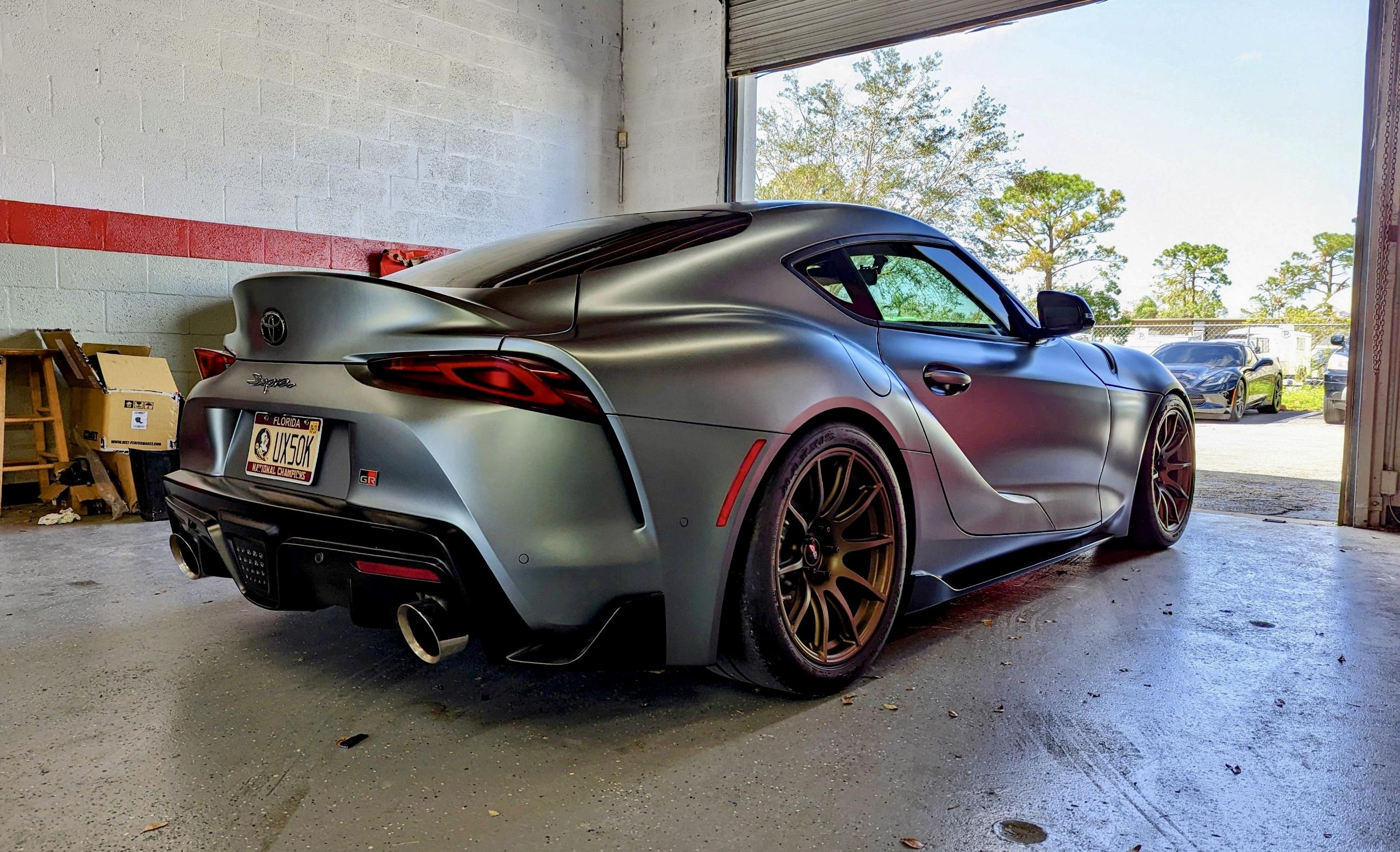

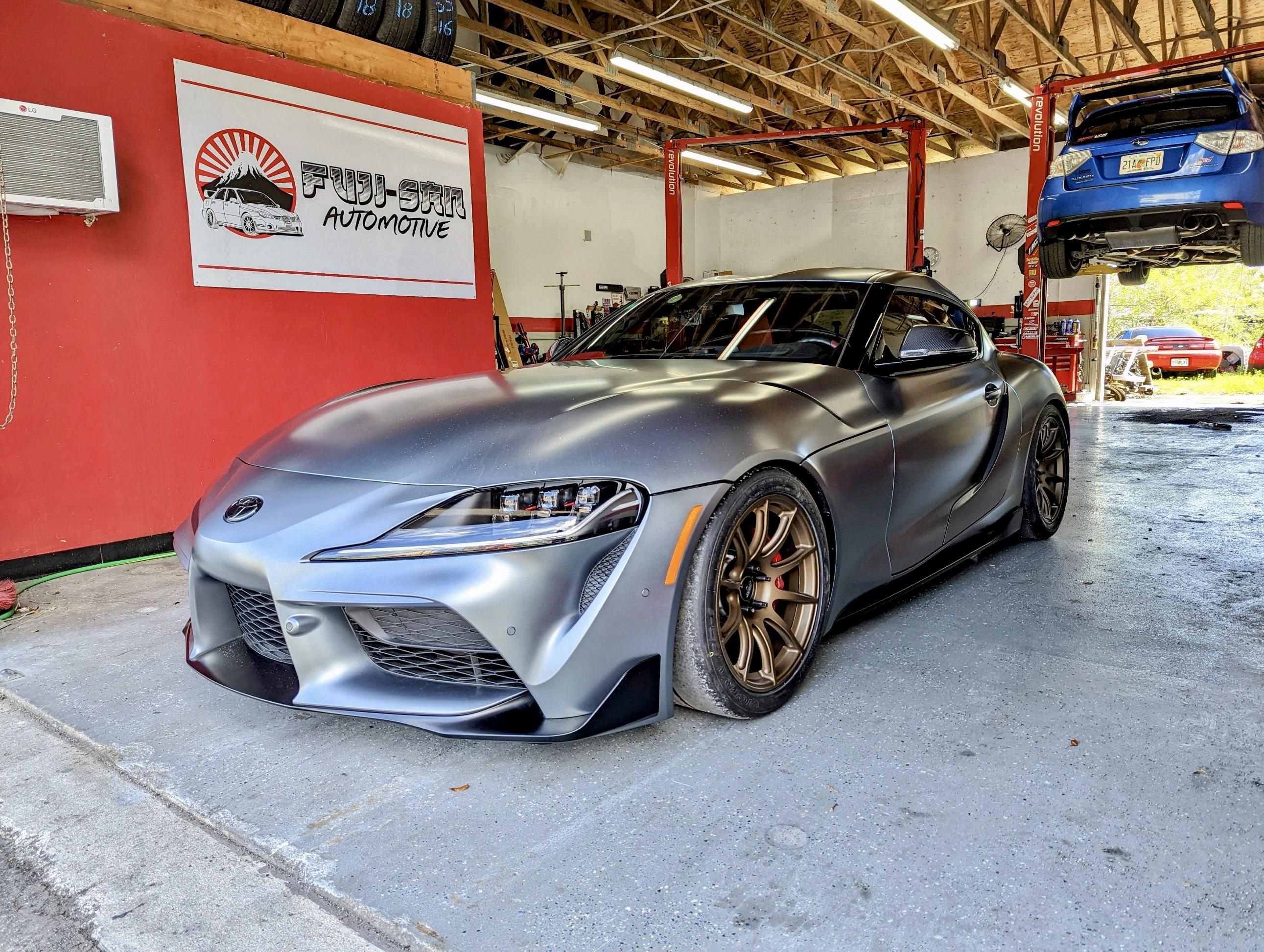

Installed the maxton v3 side skirts and spats today ?
How did you put these on? Did you use the provided screws and drill into the car or use 3M double sided tape?
I used my own self tapping screws and some 3m tape

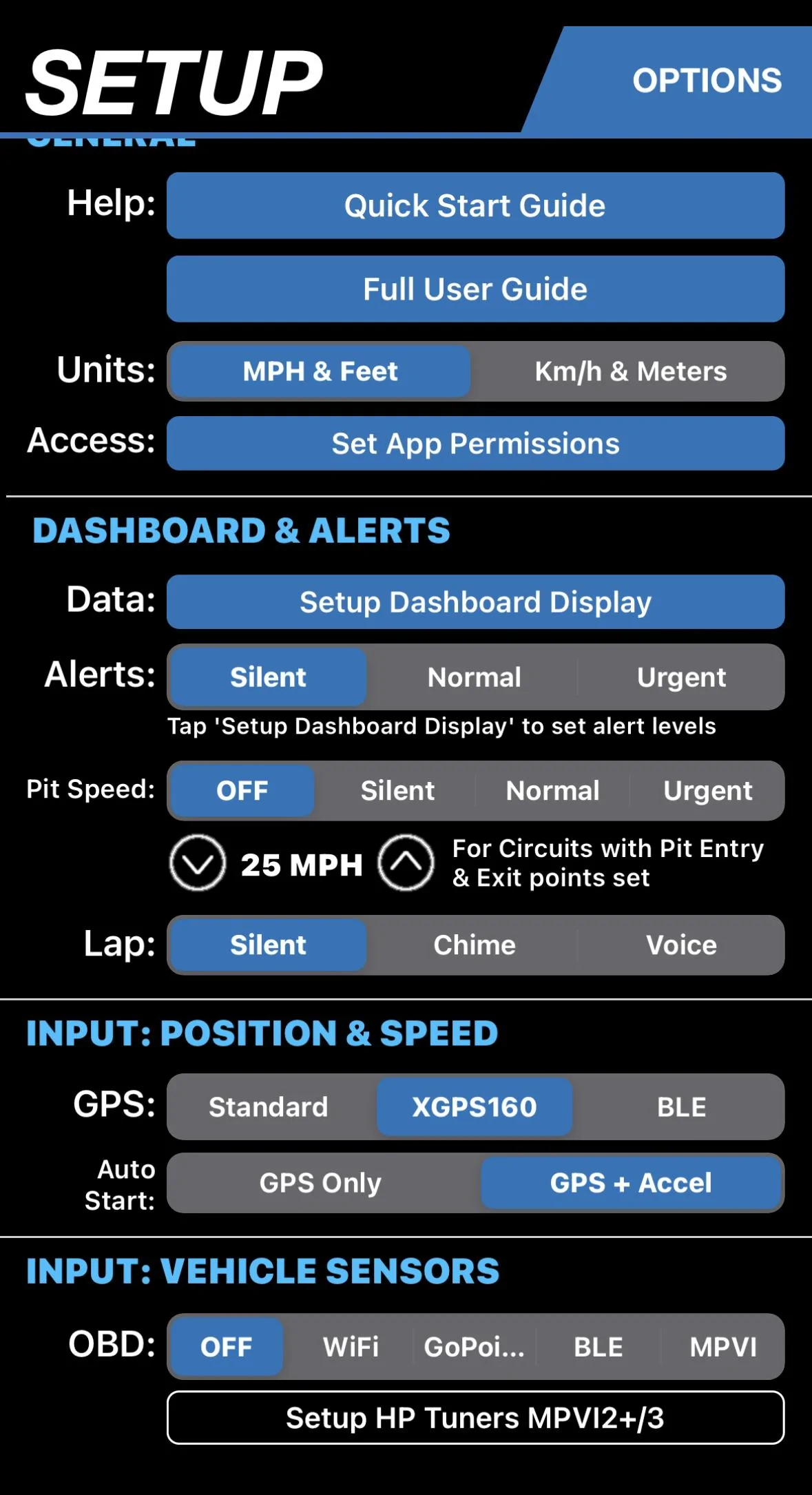

No OBD access since I’m going to keep the JB4 running. But this app picked up my XGPS and simple as hell. Probably use it over Harry’s this weekend.

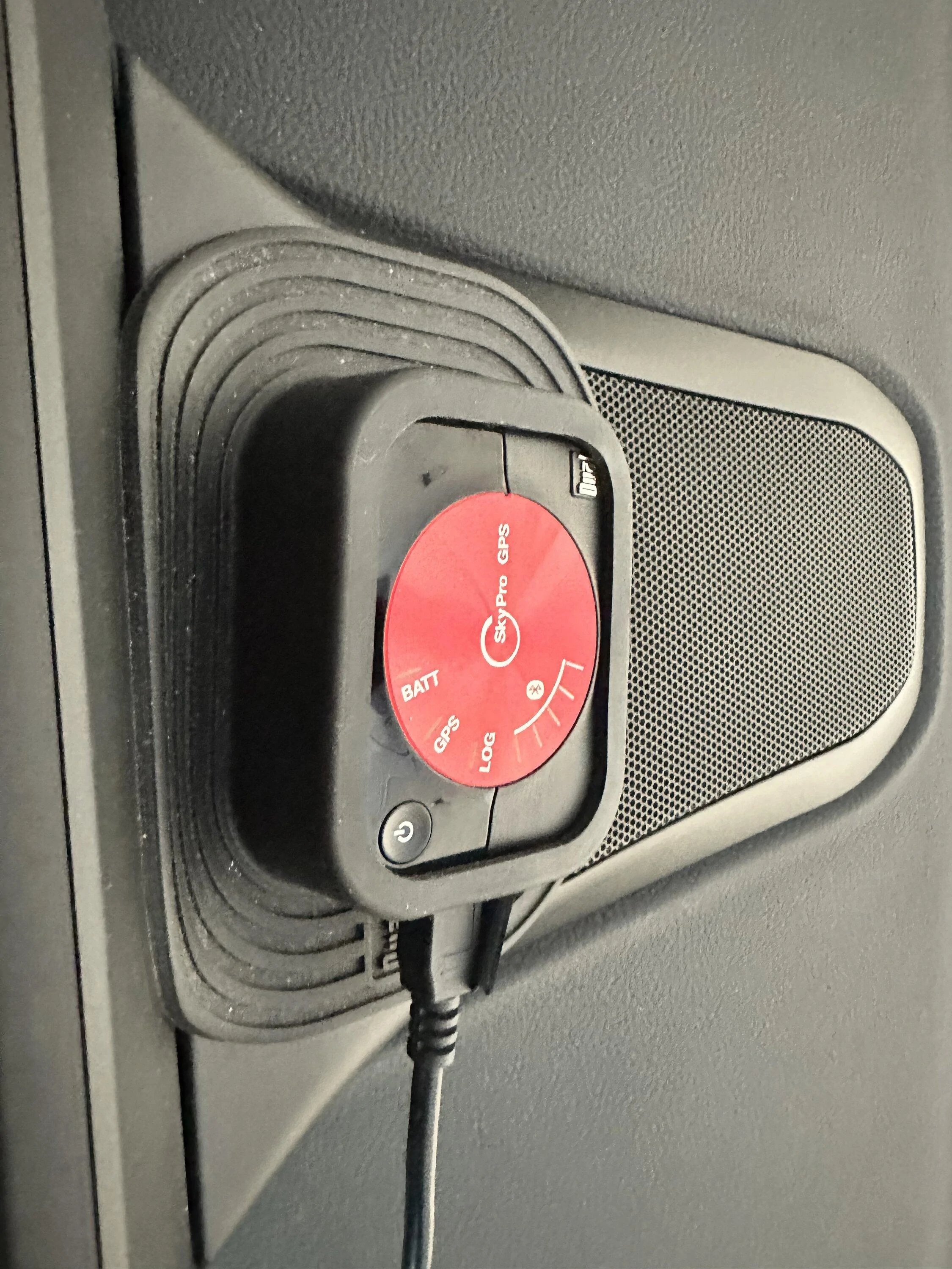

Little tape and she’ll be good to go. Won’t need the USB cable with 8-12 hour battery. Nice the Supra has a cigarette lighter and USB easily accessible for track days ?

How did you put on the rear and side skirts? The directions that came with them all mention using the screws to drill it in but would really prefer not drilling into my car if I don’t have to. Did you use 3M double sided tape and adhesive promoter?
For the rear, I removed the 2 clips and replaced them with rivnuts and screws
Did the same as @Mk5phtm for the rears. For the V3 sides there’s a hole that you drill in the front area that lines up with the clip/screw under the front wheel well and you pretty much have to use the self tapping screws that come with the skirts (3M tape alone will not be strong enough if you or your passenger gets out and accidentally step on the skirt) - but I didn’t do 10 self tapping screws on each side like the instructions said. Think I did like 3-4 on each side and used 3M tape in the gaps.

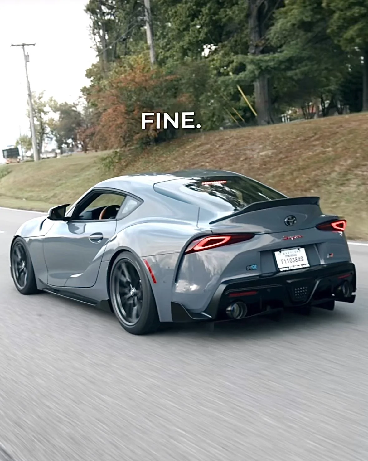

More and more I appreciate this color. More work keep being done, added mods to my fresh CU gray A91 with about 200 miles on the clock.
I've had a couple cars that color. I'm a fan. Even the Mustang looked good in it.
